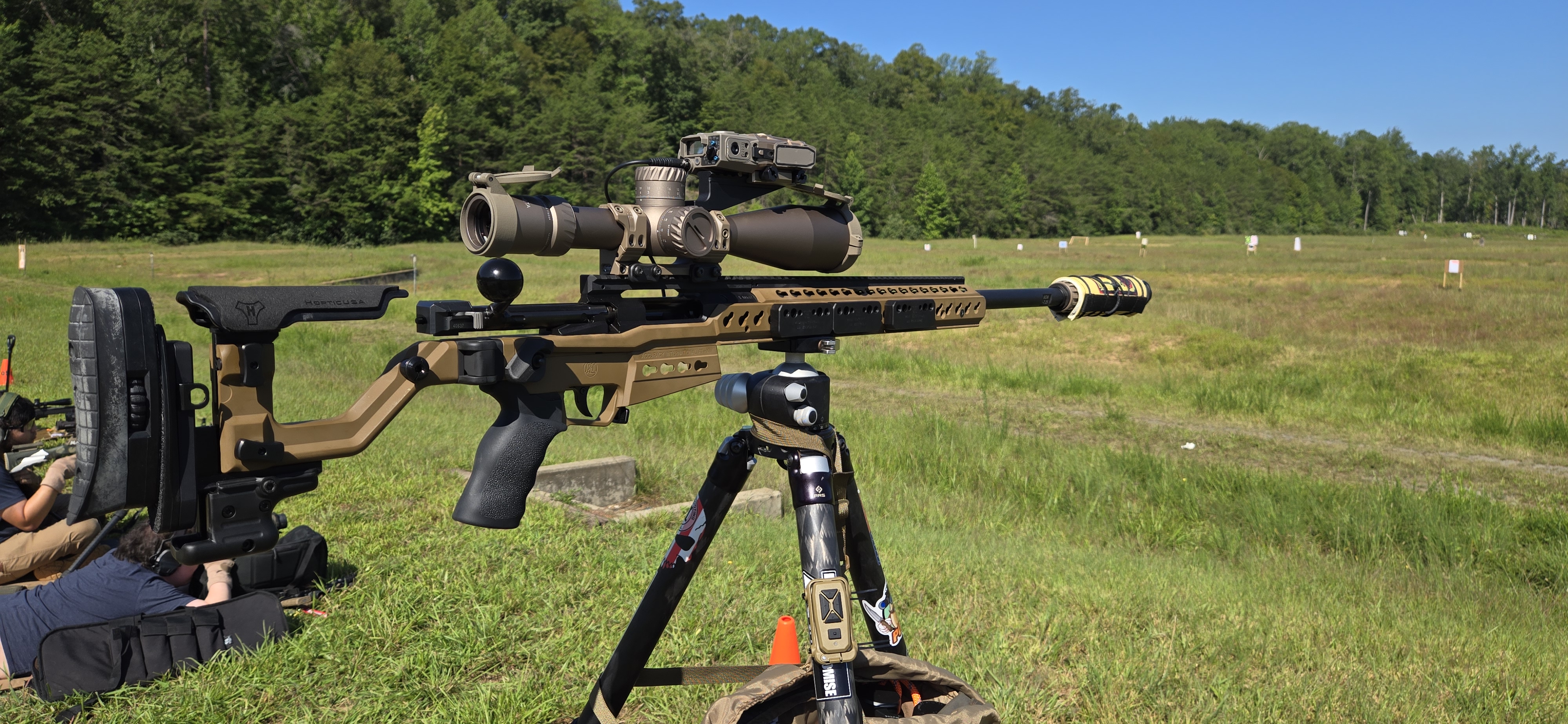

Had some fun at NRA Whittington with my AT-X a few weeks back. Shot out to 1900 yards and tried to connect at 2050 but ran out of elevation and the wind was going crazy. The round 1 mile target is 30" and we put a beating on it as you can see. Super happy with the AI and the experience at Whittington is highly recommended

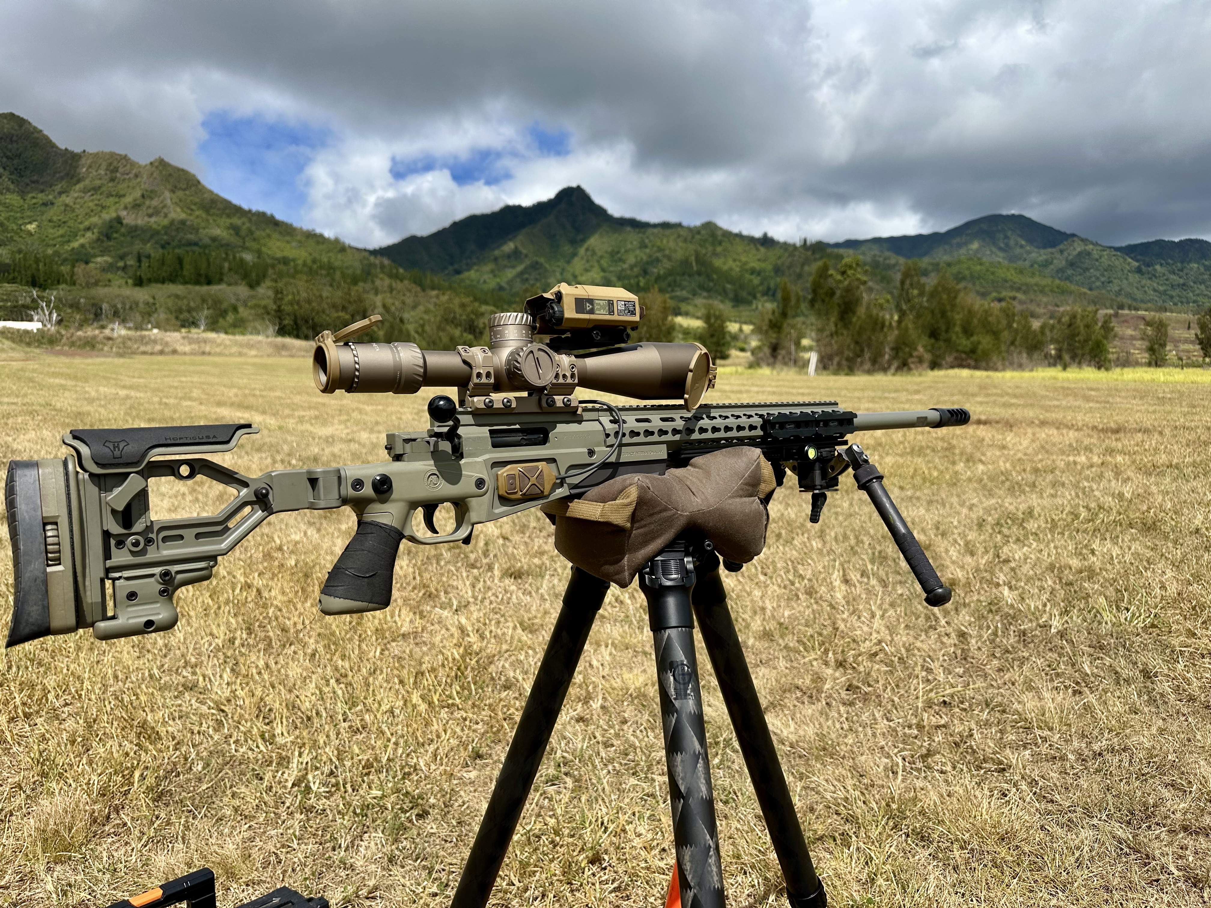

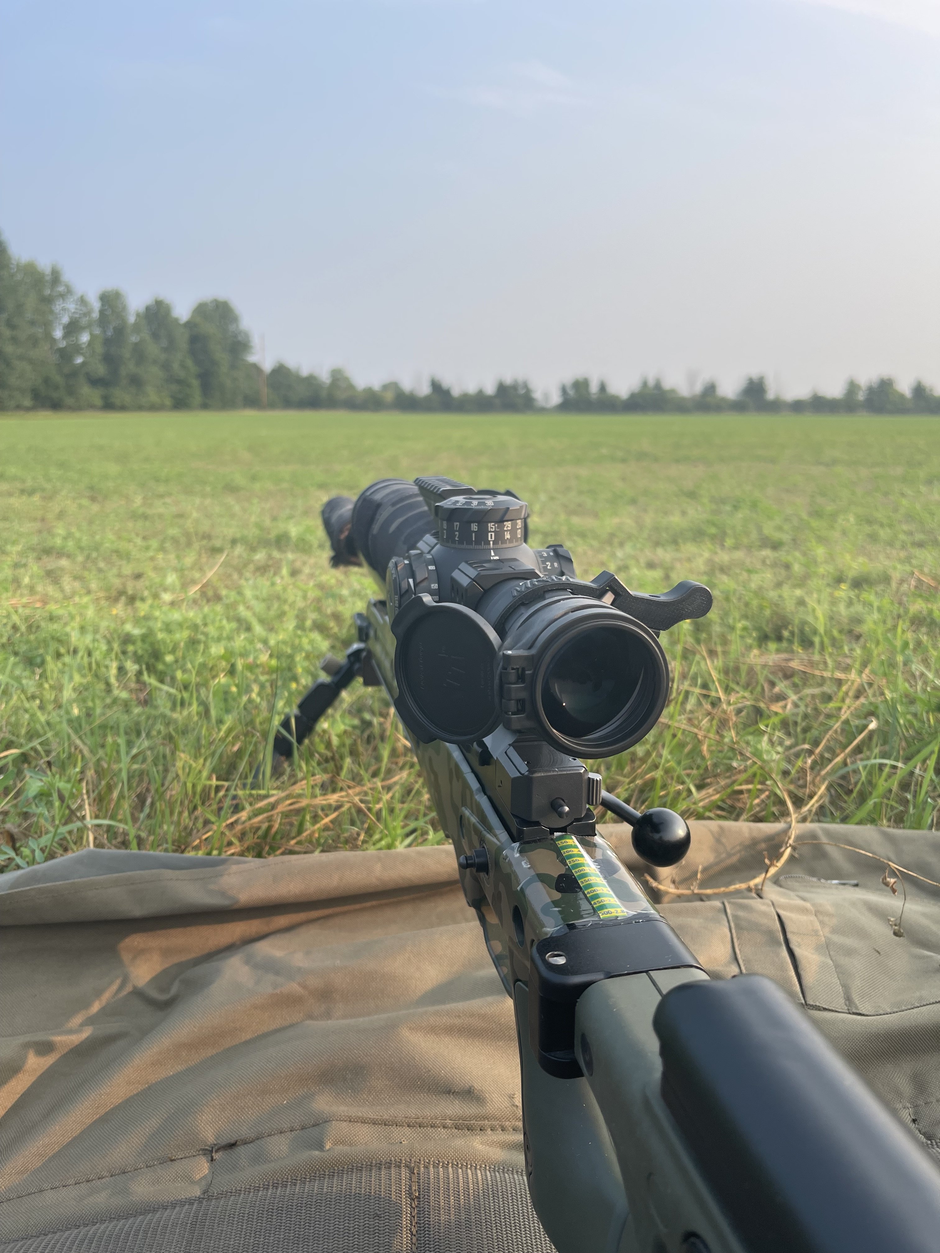

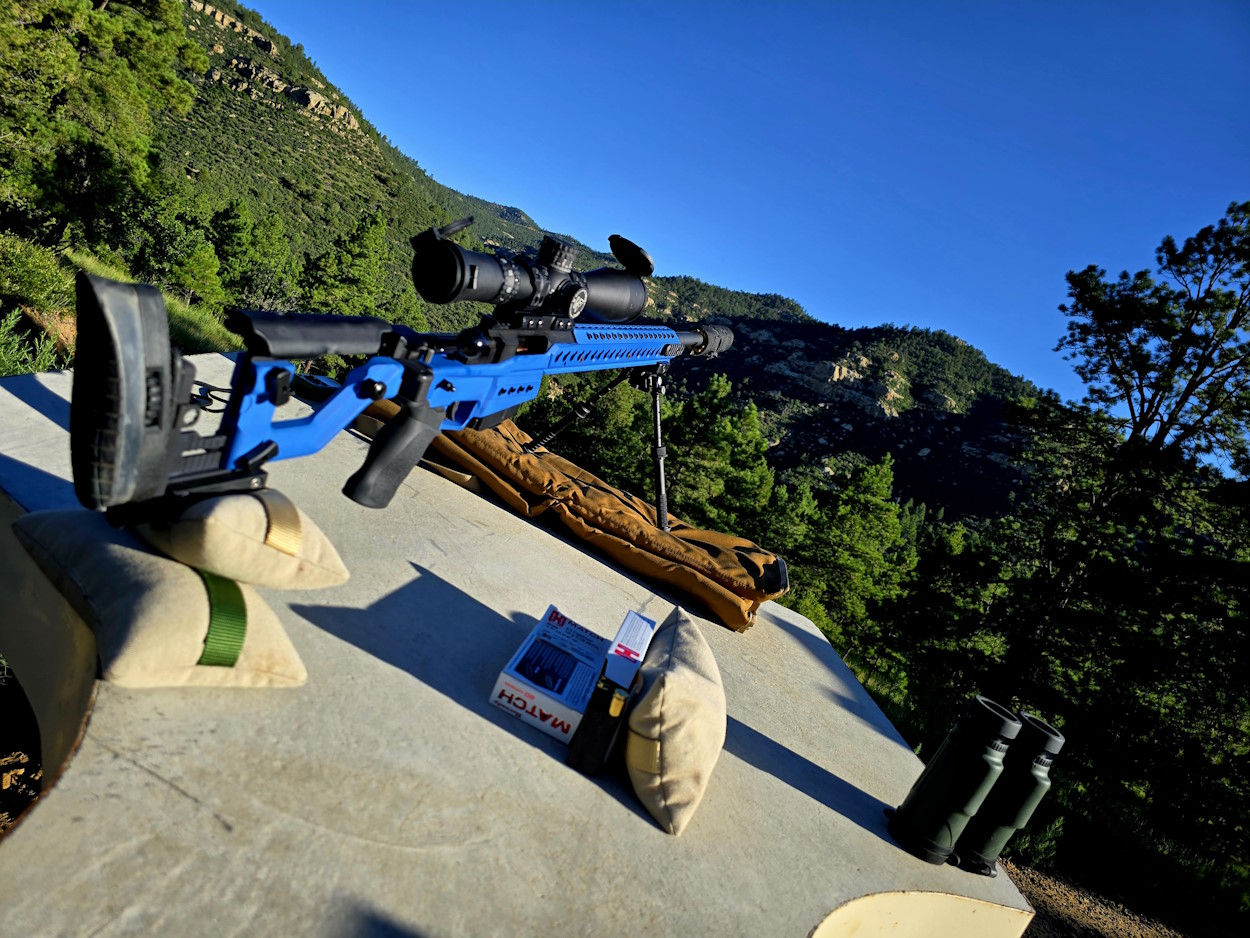

After 5 months of being a safe queen finally shot the AT today.
Not nice tiny groups to show off but the rifle is a joy to shoot. The mighty 308 is a little hard to keep on target for spotting impacts/misses, but considering it was was first few boxes of ammo through it, I felt it did alright.

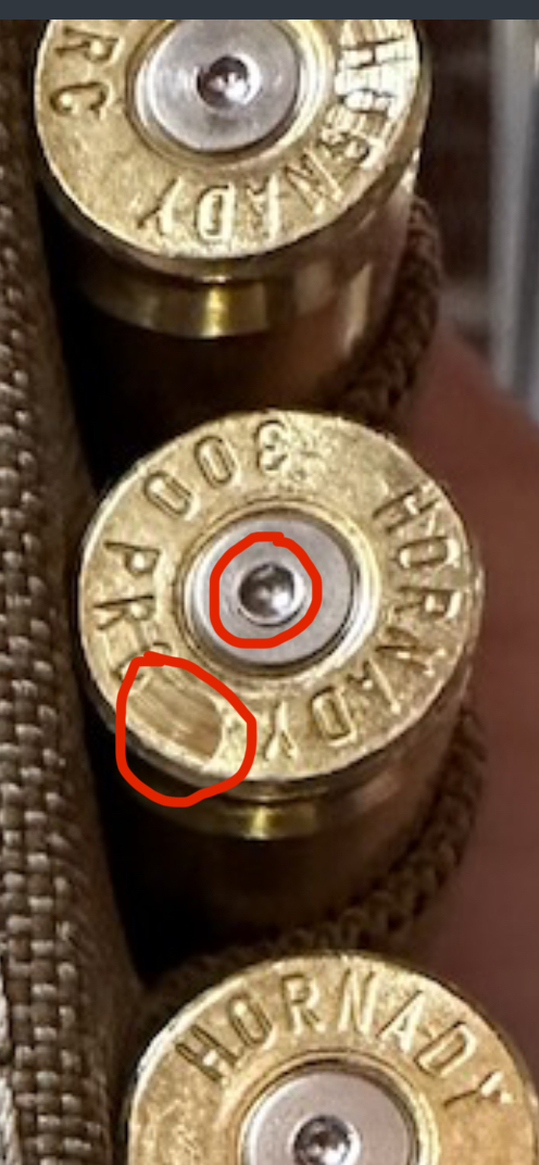

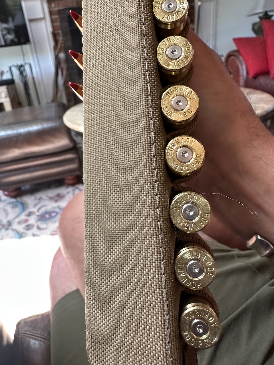

I have a question for the learned AI experts to help understand an issue with my AXMC using my new 300 WM bolt.
I configured the MC with the new bolt body, a new AI 300 PRC barrel, and a new magazine that has been tuned for 300 PRC (red follower). I went to zero it today. The rifle performed well in terms of accuracy. I had it zeroed in 3 shots. I used Hornady 300 PRC ammo with the 225-grain bullet. Before I began the process, I loaded the magazine, put the safety in the middle position, and cycled the bolt to check feeding and extraction. All of the rounds loaded and extracted perfectly. The bolt ran smoothly during chambering and extraction.
I then began the zeroing process. I fired one round, and was pleasantly surprised that the POI was minimally different than when shooting .308. Here is where the issue began. After firing, cycling the bolt required considerable force to open it fully. It went up to a point close to the top, but then required excessive force to lock it in the open position so I could extract the fired cartridge. I fired a total of 15 cartridges. All required extra effort to lock the bolt open, so it could extract the round. Some required more force than others.
I measured fired and unfired cartridges, and dimensionally, they were almost identical. The only measurement that was different was the diameter of the neck. An unfired case measured 0.338" while the fired case neck diameter measured 0.345". I don't know if that is normal since I don't reload.
Any thoughts?

Over pressure?
Got a pic of the rear of the cases? Primer area
Reactions: Bkultra
TY!!
These rounds are factory, though. What would cause the overpressure?
Factory rounds can have over pressure. Try a lighter grain. I’ve seen 6.5 CM have issues in some guns with factory ammo as well
After trying 6.5 CM and 300 PRC I seen pressure issues and went back to my 260 and would go back to 300 WM throated longer if I went back to a long action mag again
I will try a lighter grain round
Nothing on the heads, but I don't know about the crimp.
I will try some Berger 215s
But then again.. other things to consider. Hornady brass is not the greatest either. I don’t use Hornady brass but I’ve heard they are soft an thin. So the pressure could be expanding out to the base of the case as well. Causing such over pressure signs. I wouldn’t worry about it imo. I say you should be fine shooting them. I mean you don’t reload so your just gonna toss those factory brass anyways. But if you ever do reload, buy Lapua and don’t reload range picked brass.
Reactions: Nik H
That is why I want to try the Berger 215. It is loaded with Lapua brass.
Reactions: Rhed
I have seen more then one 300 PRC have the same issue with factory ammo. I have read somewhere long time ago 300 PRC not liking it with higher pressure, depends on the chamber. Doesnt help that it's Hornady ammo. They are notorious for having shit brass.

Could also be jammed in the lans, or carbon ring if you barrel is dirty. Not saying yours is.
Could also be excessive headspace forcing the brass back, no?
Granted I still haven’t played with my 300 PRC AXSR, but the Hornady I bought last year and shot in my MRAD had zero issues. I’m a little loathe to the get the AXSR setup as I’m still contemplating the need for it and the boxed TT735P JTAC when I have no good opportunities to take advantage of the cartridge.
@Nik H I have a 22-250 barrel on my AT, and with one box of Hornady Superperformance 50gr there were a bunch of quite hard bolt lift cycles. So much so that I gave up and tossed the six remaining unfired rounds into the dud can at the range.
The other boxes of that stuff that I had fired more normally, although there were a few slightly harder than normal bolt lift events. Just a little.
The boxes of the less high strung Varmint Express 50gr that I also shot through it were fine.
So yeah, Hornady can suck, for sure.

All I kept thinking about when pushing up on the bolt was what @carbonbased said when I posted about getting the bolt. He said, "Cue to all your bolt handles snapping off in 1…2…3…"
It is good to hear that others are having this problem. Much easier to solve than if the problem were due to a machining issue with the bolt or barrel.

Oh, heck yes. One of the reasons I got my AXSR in 300PC - I already had an AXMC in 300NM, and I do handload, but I also like the option to be able to shoot factory ammo if it's decent. Hornady 300PRC 225 ELD Match ammo is less than half the price of Berger 300NM 230 OTM Tactical Match ammo, and on my home range of 1626 yds the PRC can hold its own against the NM (but not at longer distances).
It sucks you're having that problem. I shot a ton of the factory Hornady 225 out of mine without a single problem. I only quit using it when they had to change their powder after Covid shortages forced them to, and the ES/SD became almost unusable for the distance I was shooting it. I've never shot any factory Berger PRC, but I now load for it using Lapua brass, Berger 230 OTM Tacticals, 215M primers, and Retumbo. Has been waaaay better than the Hornady 225 ELD load.
Does Berger actually make a 215gr load for 300PRC? I've only ever seen the 245gr Elite Hunter load.
Yes
215 grain Hybrid Target. Just ordered 100 rounds. I am keeping my fingers crossed that it is better behaved than the Hornady.
I will also pick 20 random rounds of the Hornady to see if the issue is consistent across the entire case that I bought.

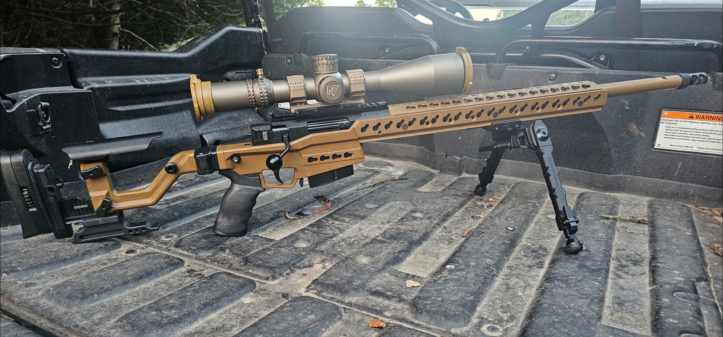

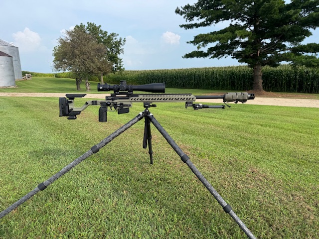

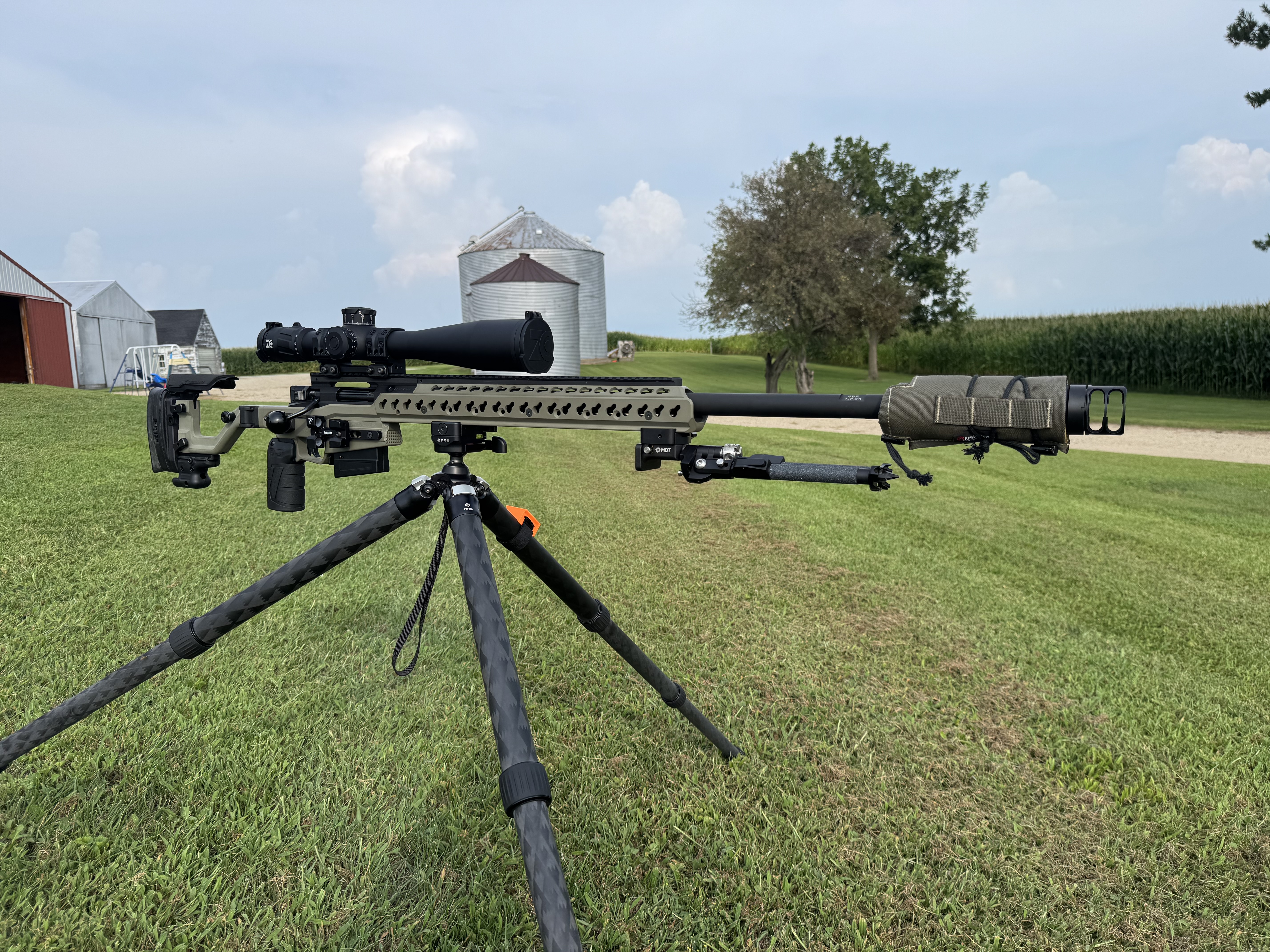

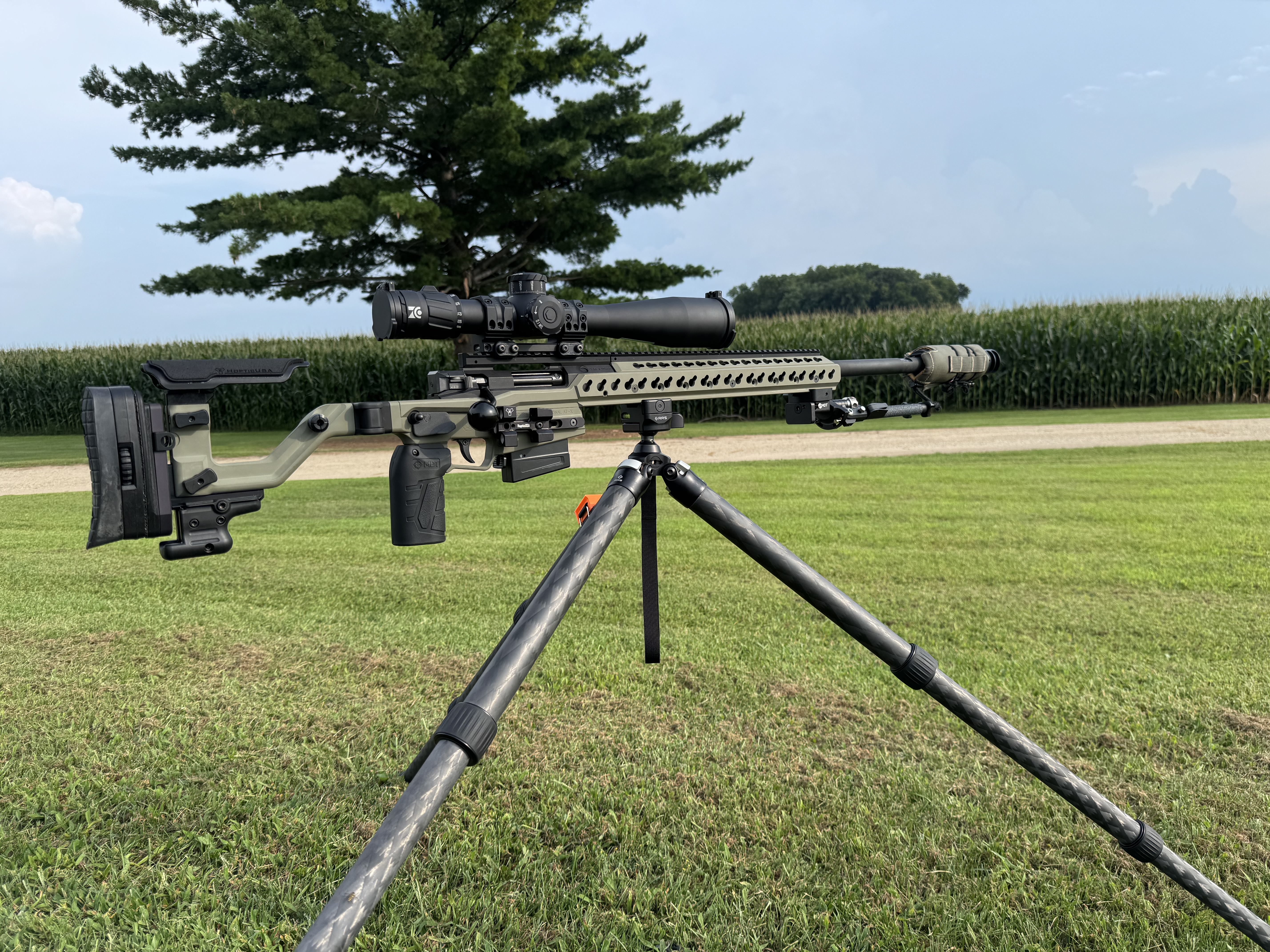

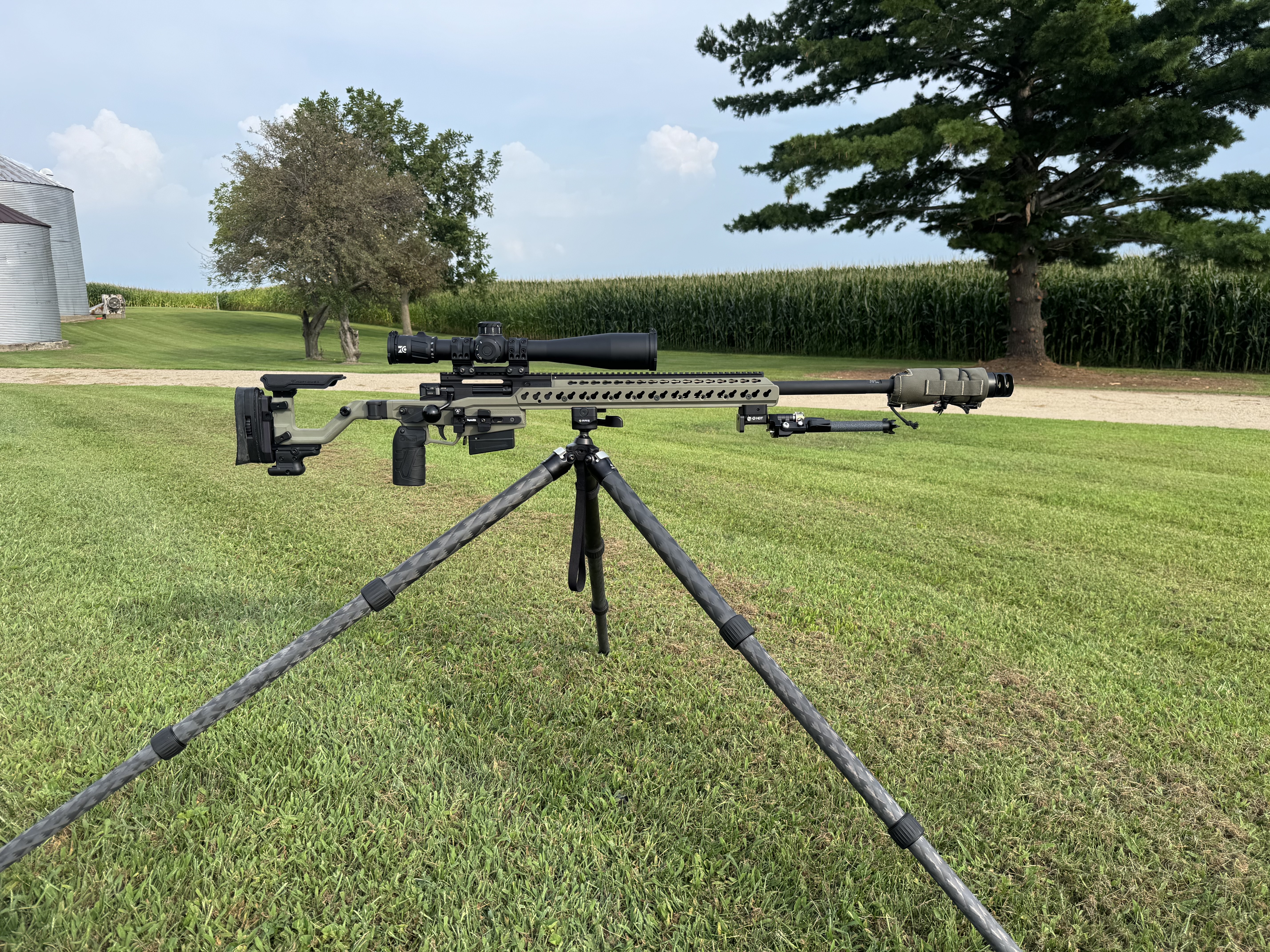

My AXSR 37 XC barrel is finally up and running after a 2 year wait.. almost 1 year waiting on the Bartlein modBB blank, shipped 2 blanks halfway across the country only to have them sit at a smiths for a year, ended up having them shipped back to me.. $150 wasted in shipping cost 😡…..
Than hand delivered my blank to Greg at SPR aka Bugholes along with my JGS custom 37XC CEB reamer. SPR crew knocked this barrel out of the park. 4 week turn around time.. Huge shout out to Greg/Russ @ Bugholes..
