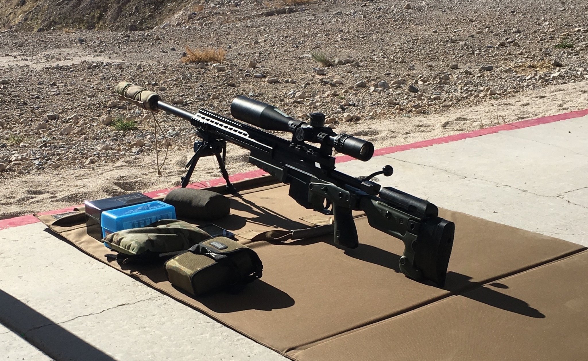

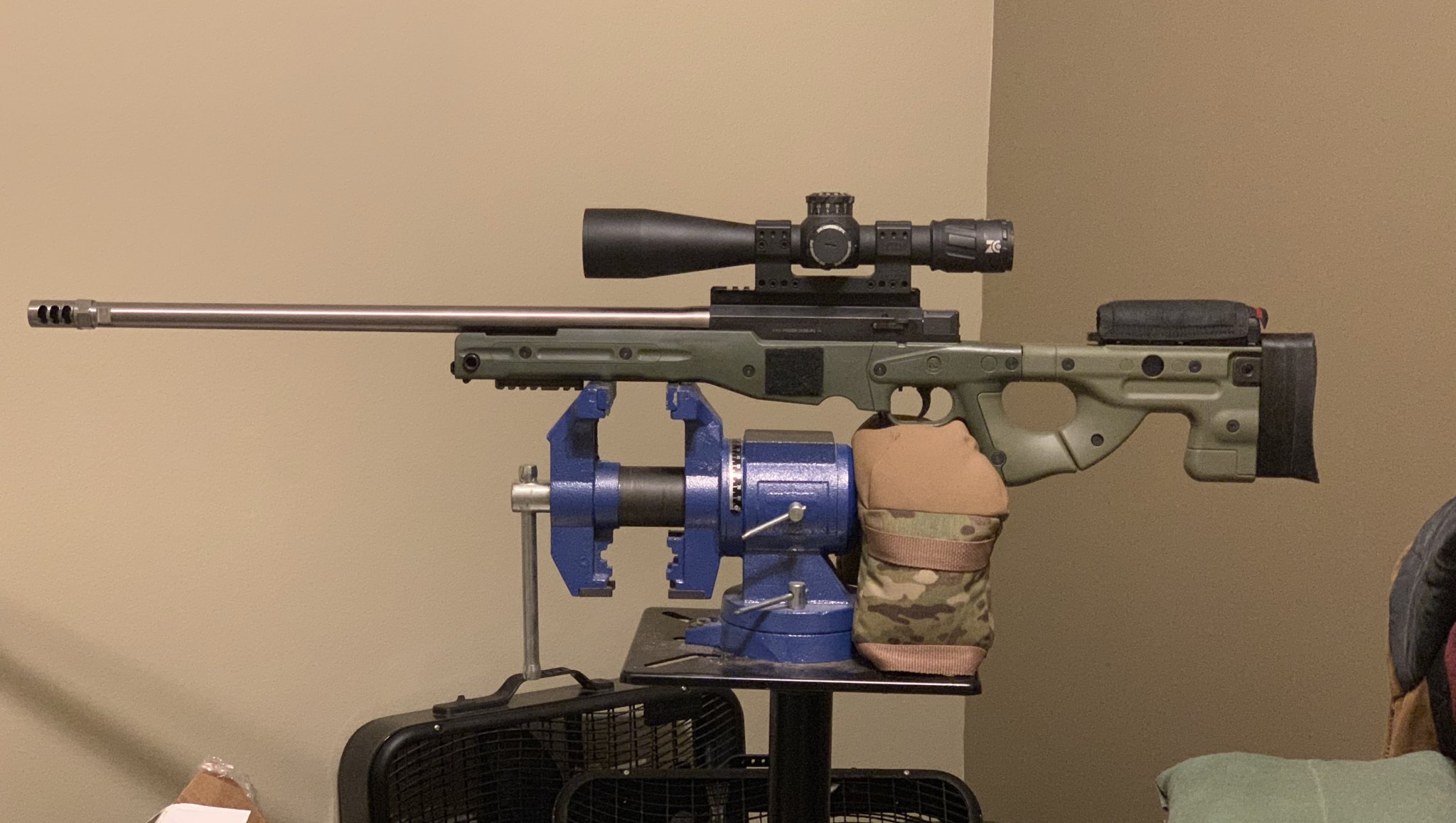

Upgraded the glass on my AXMC. I loved the 5-25x56 PM II, but I didn’t love the low-end tunneling, or the factory supplied road rash. I had a Limited Edition model that had escaped Germany with very crudely demilled markings on the objective bell. After owning the scope for about a year, a member of my team attended the NRA convention in Indianapolis and approached a S&B employee at their booth. He showed her a picture of my scope, and she called me to immediately start the process to replace it. She even let me upgrade to the 3-27x56, after discussing my optical requirements with her.
I bought a Schmidt Bender the first time, because I knew they were great scopes. Any future S&B’s I buy will be equally because of their awesome customer service.

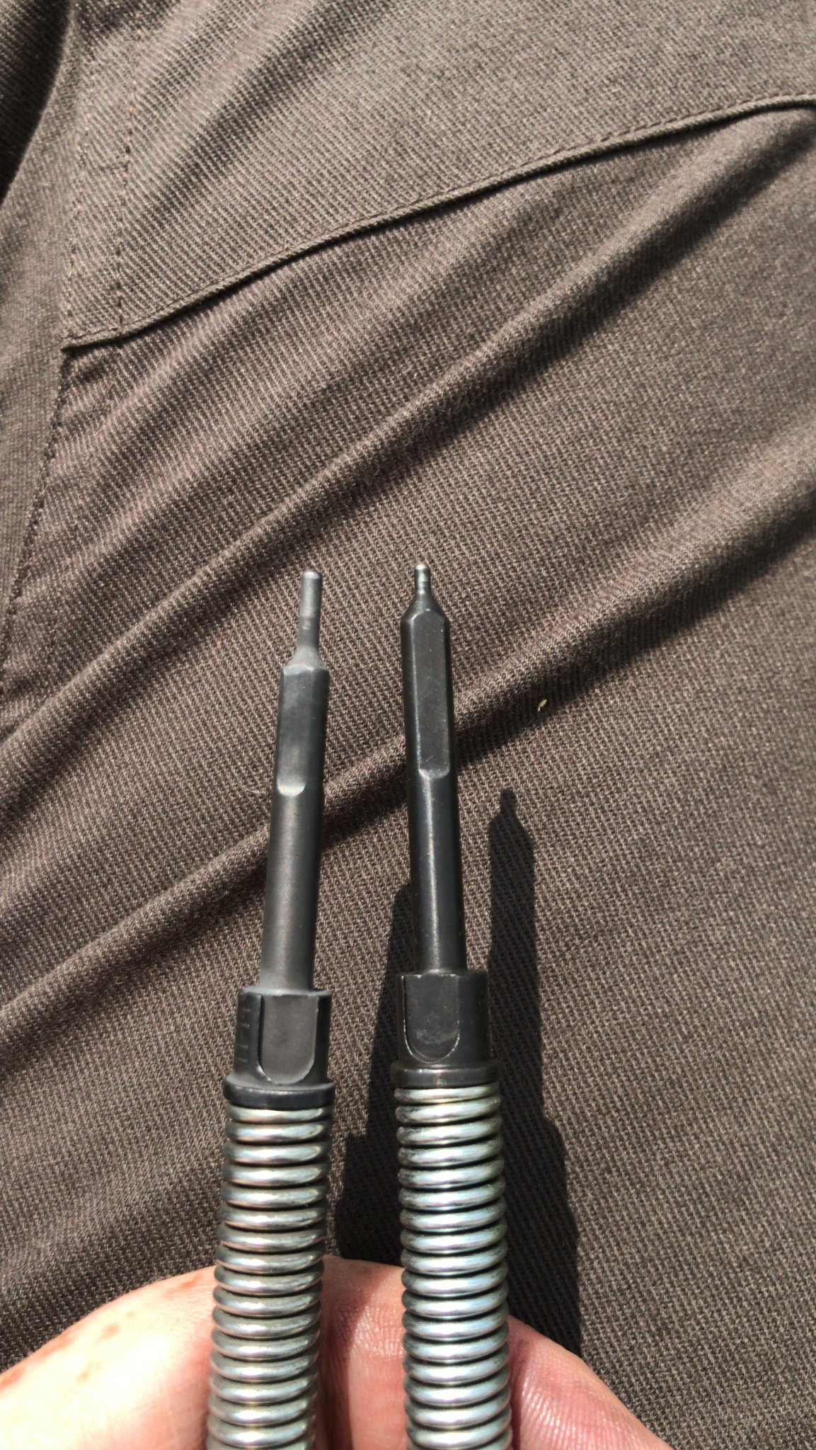

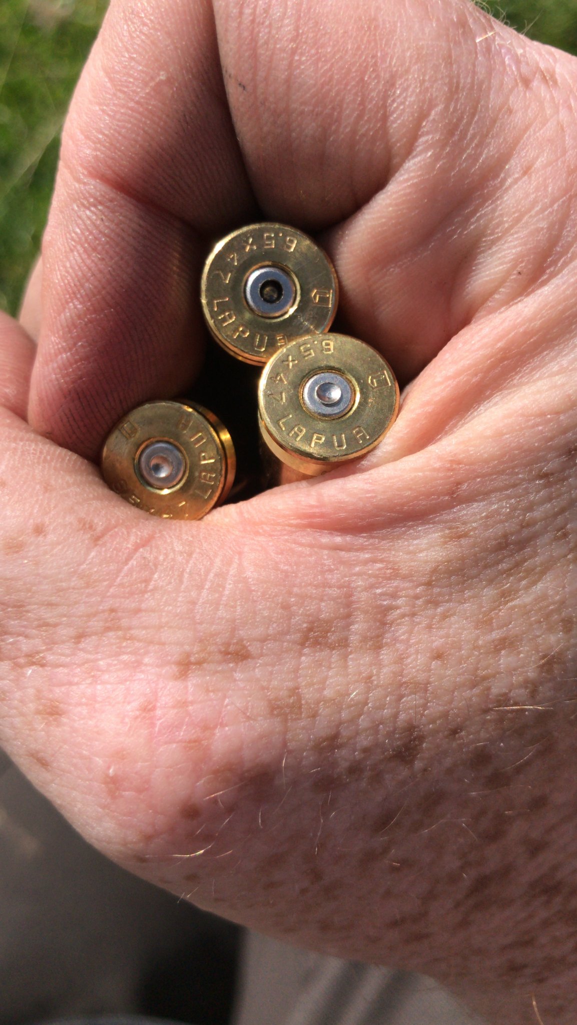

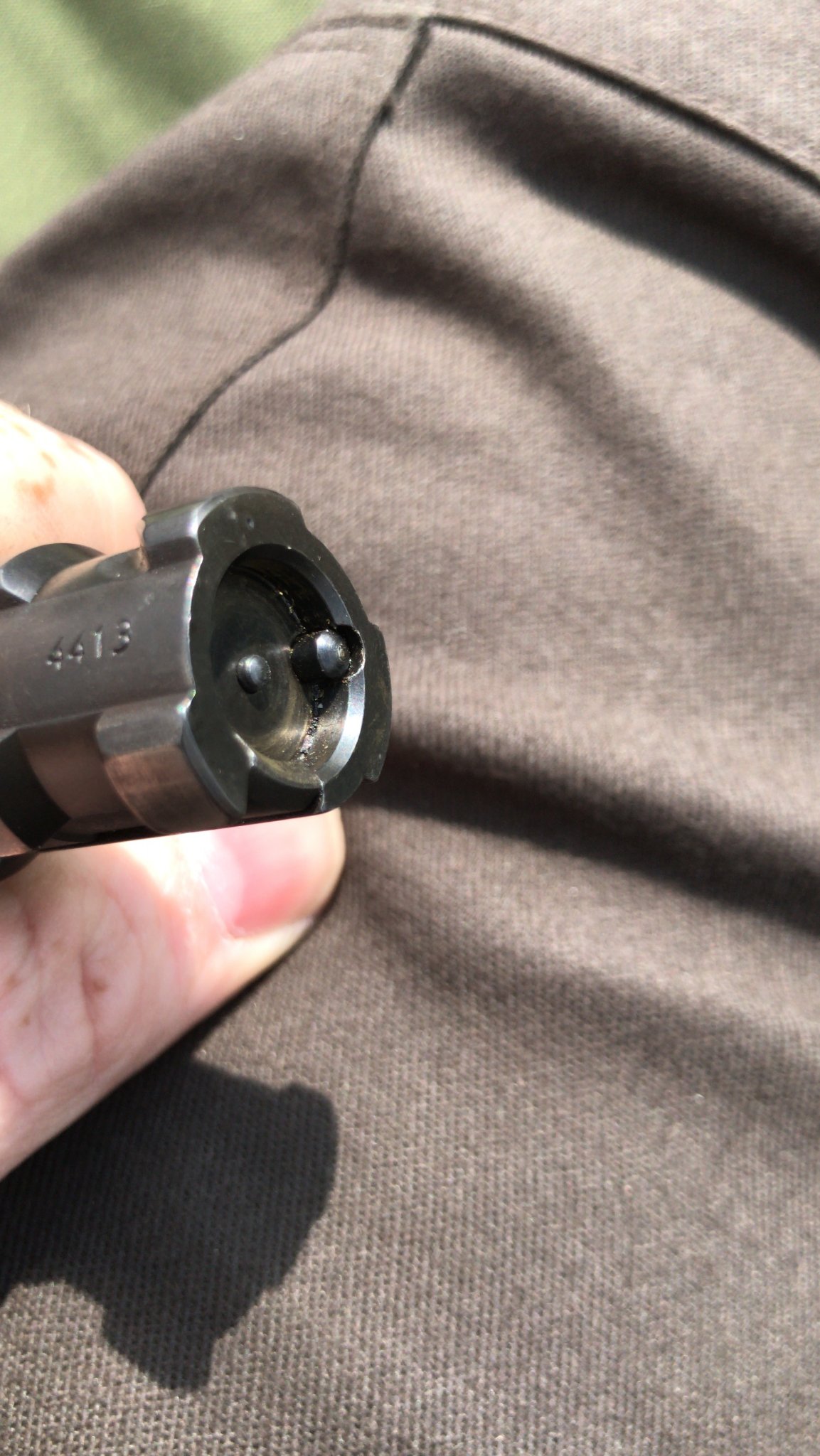

Out with my 14 AT. It was supplied as a 6.5X47 and is currently wearing a Krieger 6.5X47. I bought as a sleeper having not been used until this year. I loaded 130gr ELD-M Over 37.5gr N150. Average 2820fps so moderate. Primers were popping all over until I swapped to my pals small firing pin bolt. It slotted straight in and shot amazingly. Suffice to say I think it’s shit AI have now swapped to small firing pin. There is a couple of thousand between mine and my mates rifles. Why can’t AI just swap bolt heads instead of insisting on full
Bolt swaps.
Bolt swaps.
Excuse me if I am wrong, but to my knowledge it is not just the firing pin. The Bolt face hole is also different, which is why the old ones had to be bushed. You can either buy a new bolt body or have the old one bushes by a reputable gunsmith.
Excuse me if I am wrong, but to my knowledge it is not just the firing pin. The Bolt face is also different, which is why the old ones had to be bushed. The bolt faces are not interchangeable due to design, an entire bolt is needed.
The bolt head is held in place by two roll pins, pop these out and replace the bolt head and firing pin and job done.
Bolt swaps.
I would look into getting your bolt bushed rather than swapping bolts. LRI does great work in the US, but no idea who does it across the pond. I'm sure if you look around a bit there is someone who can take care of you for a fraction of the cost of a full bolt.
I have a guy here who can do it. It frustrates the hell out of me that we should have to do it though.
My argument is my rifle was supplied with the 6.5 X47 barrel and the rifle isn’t fit for purpose. The bolt should be rectified by AI. It wouldn’t cost them much or at least they could heavily subsidise it.
I’m in two minds just to have the 6.5X47 chamber run through with a 6.5 creedmoor reamer and run large primer brass. Although I love the low recoil and apparent inherent accuracy of the 47.
... Or you could just sell the awful rifle made by an evil company that put on a barrel that doesn't work as you expected
I could couldn’t I. But seeing as the evil company have identified there was an issue, and rectified it on current models then I will pursue a resolution that doesn’t involve selling an otherwise excellent rifle.
The small rifle primers are the issue right? What's the big deal over using small primers? I can shoot a .260 all day and sometimes with hot loads with large primers and never have a primer issue.
@blbennett1288 Yes, the hole diamter on the bolt face has to match. Can't use a small firing pin when the bolt face hole diameter is for the large firing pin. That why guys had to modify the bolt face as well. Or why AI is selling it as a complete bolt assembly.
@Scotch_egg I believe the bolt face is also expoxied to the bolt. It's not just held it in by the pins...
.. Good thing a bought a bunch of those "Zero" baseplates for my AW/ AX mags that Core (Now Altus) sold.
Reactions: blbennett1288
I’m not sure that it is expoxied in place, I will take a look now. But I’ll not be taking the roll pins out to make sure. That will be left up to my gunsmith.
@trophyhunter - are AI bolt heads epoxied to the bolt body or can they be removed via just the roll pins?
Correct, it has an epoxy for snug fit and held by 3 rollpins
All that bush the bolt will remove the bolt head as it’s easier to true up and do the procedure.
You don’t want to just swap a small firing pin in a large firing pin bolt body, it’ll create excess gap around the hole causing even more issues.
Swap to small pin face or have the large bushed.

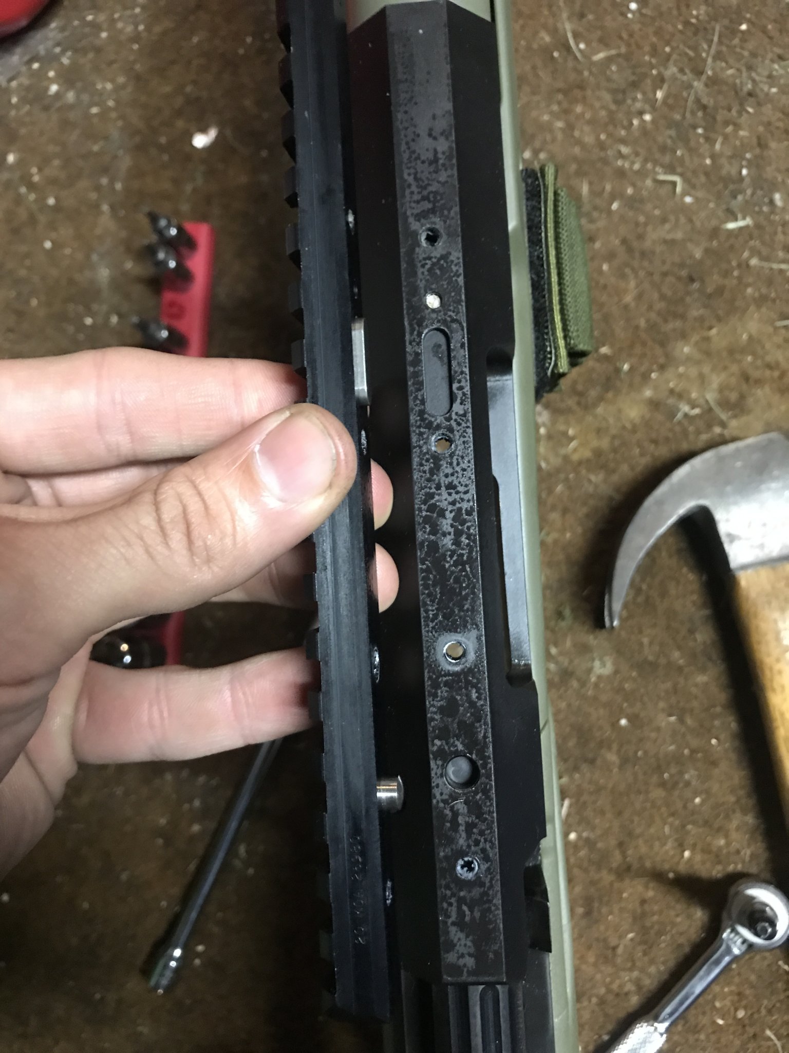

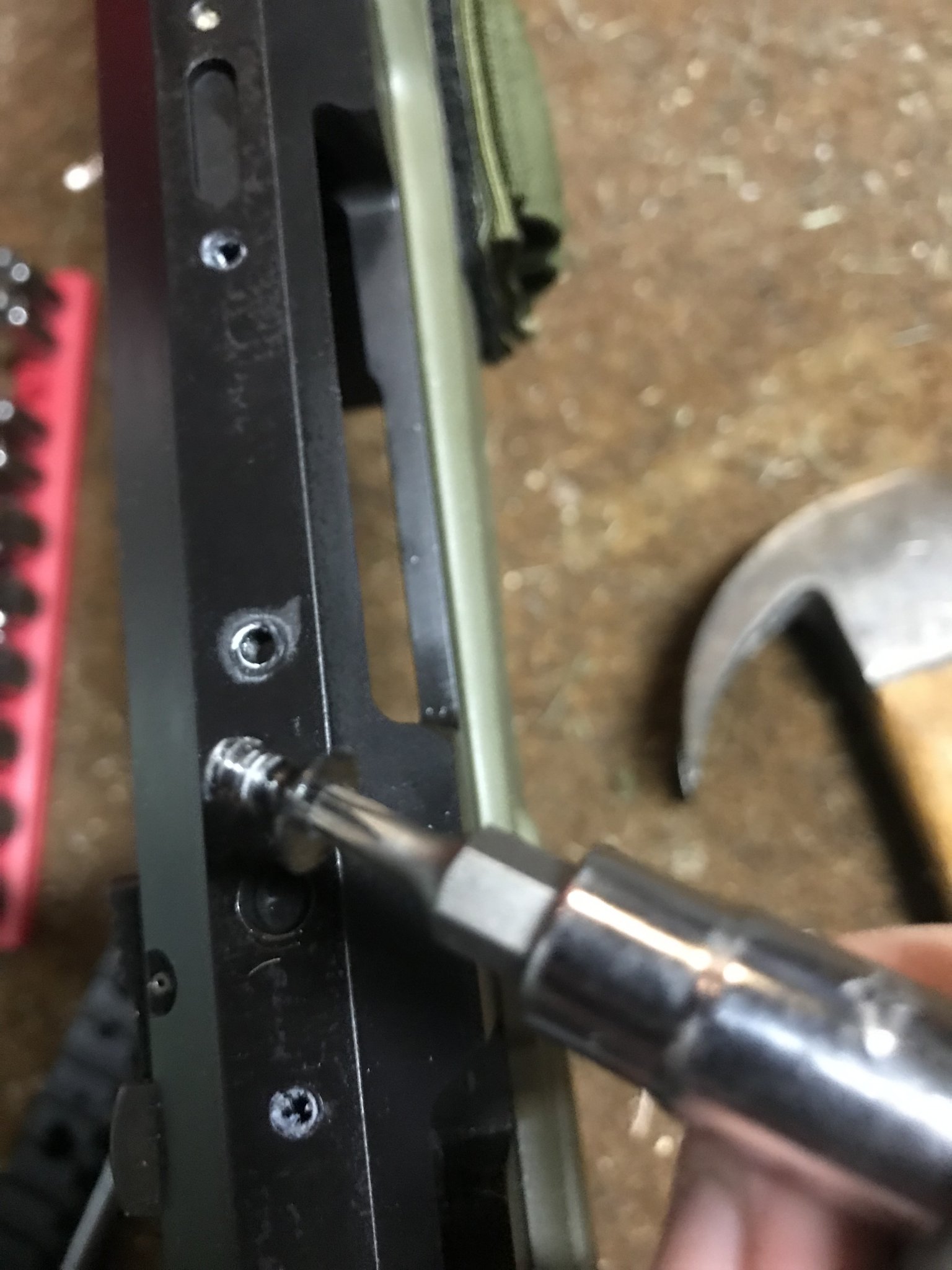

Well, I wanted to get started on taking screws off the AT’s action rail, to replace my low height mount with a NV compatible high one. 3 screws came out no problem. The 4th won’t budge and now I’ve got a rounded screw head. I should have known they cranked it down at the factory because my brand new set of metric Allen’s fit loose on that bolt. Do you guys think setting my Allen key in the hole with a little JB weld, and then hit it with a torch before loosening would work?
Do you have a small, sharp center punch? If I’m remembering right the the screws are flat heads. If not this might not work.
Anyhoo, take a sharp center punch and on the top flat portion of the screw next to the hex socket put a deep center punch mark in the screw. Then put the center punch in the mark you just made. Lay it over pointing counter clockwise. Now use tap the punch.
You’ll basically be using mark you made as a drive point to break the screw loose.
I hope this makes sense. Be careful it’s easy to mark things up but you’d be amazed what you can get loose using this technique.
Worked like a charm. Of course it did. It wouldn’t work if I didn’t have the JB weld as backup lol

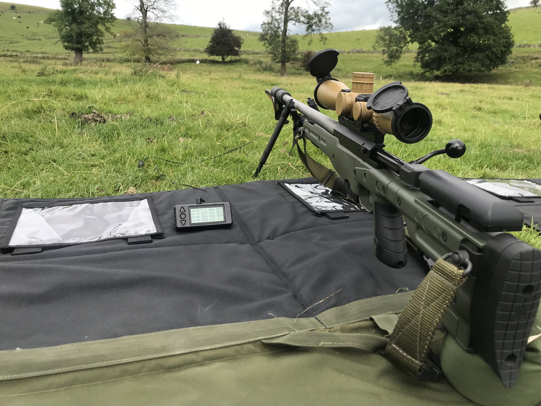

So I've decided to buy myself an AT for my 21st, and I'm looking into some options for the rest of the setup(any suggestions would be appreciated). The biggest issue is the optic/mount, at this point I'm set on the S&B PMii 5-25x56 and a spuhr QD mount.
But I'm getting mixed messages, does the AT have an inclined rail or not, there's a YouTube video from shot show that says it does, and a website that says it doesn't, also while I'm at it what is the most incline you can have on a spuhr (preferably QD) before a S&B PMii 5-25x56 won't give a decent zero at 100m.
Thanks in advance.
From what I'm aware of, I though all AT's came with a 20 MOA rail. I'd double check with Mile High or Euro Optic on it. Mine came with a 20 MOA rail.
With how repeatable Spuhr standard mounts are, I wouldn't spend the money QD and spend it on a good torque driver. The PMII is a fantastic optic, so is the NF ATACR, and the Kahles K624I. At that level you're splitting hairs on the optic, and it comes down to preferred reticle, and eye box size.
I'm not sure about how much MOA you can stack, but I know from the Kahles, I could go with 20 MOA on the rail, and 20 on the mount if I had to. But honestly unless you're shooting a super wild cat cartridge out passed 1600 yards, it's kind of silly to have that much adjustment on a short action rifle. 20MOA base usually gives plenty of adjustment on most high end scopes. I'm around 9 mils at 1200 yards on a 6.5 Creedmoor, and that's not even on the second revolution. I still have another 5 mils before I'm bottomed out on my scope.
