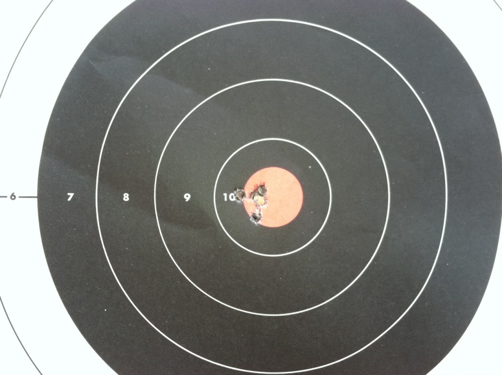

    Yes they will shoot...... This target was shot off an atlas bi-pod w/rear bag @ 100 yds using factory fiocchi 69gr match king. Try the heavier projectile, mine seems to like it.
