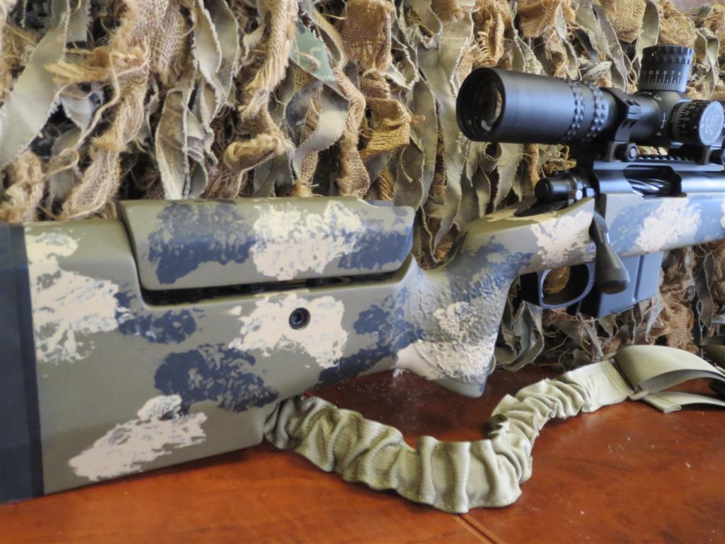

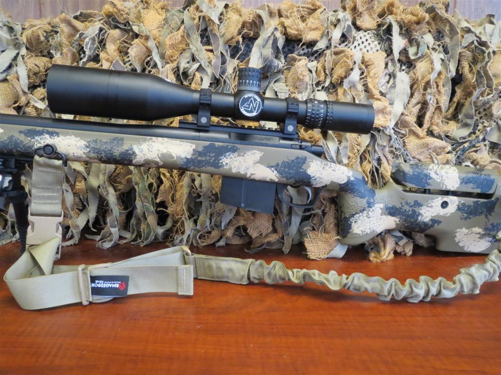

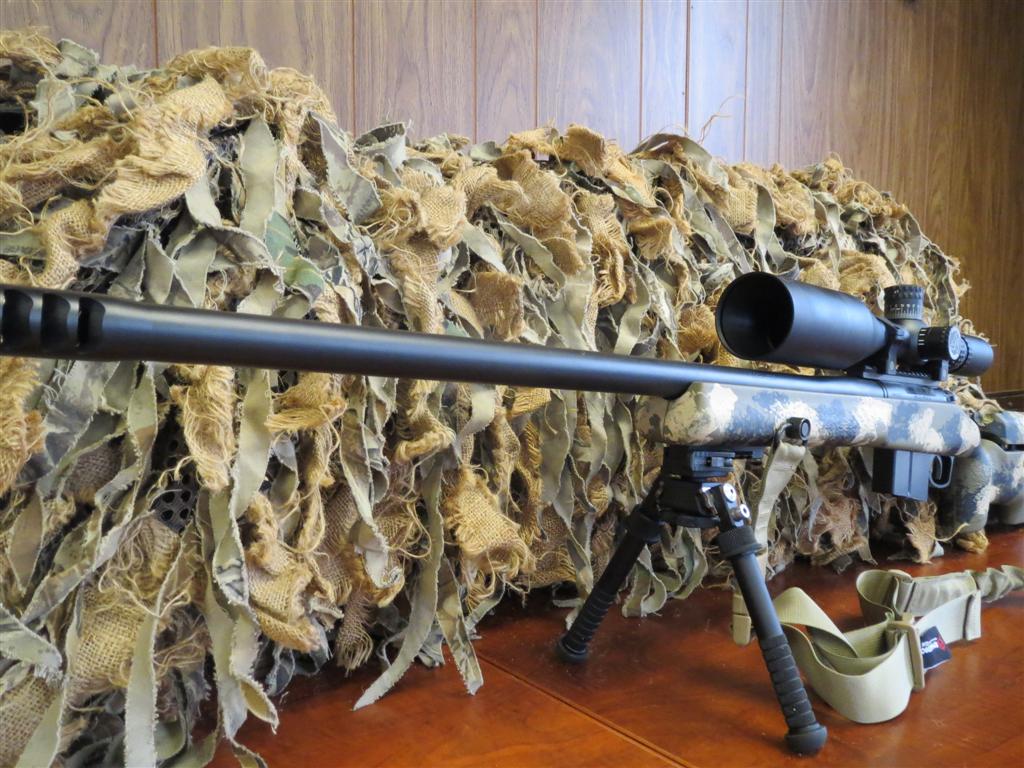

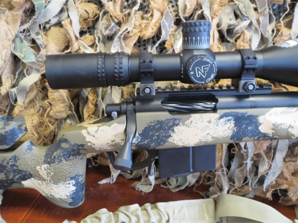

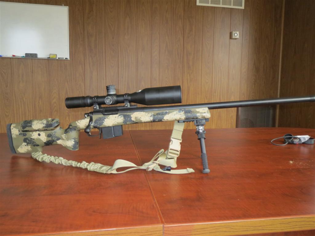

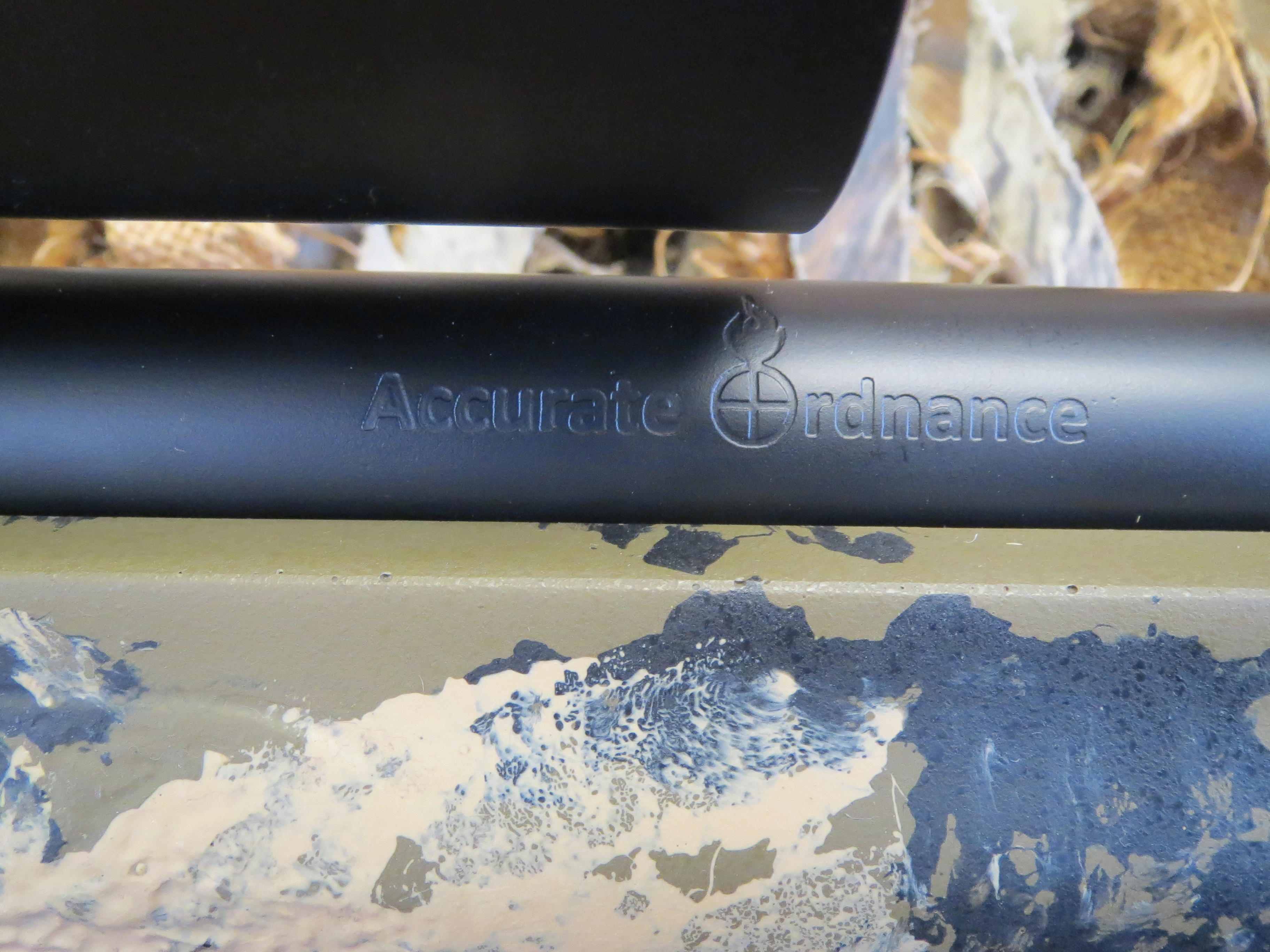

I want to introduce my 6.5x47 Lapua built by AO. 100% satisfied customer

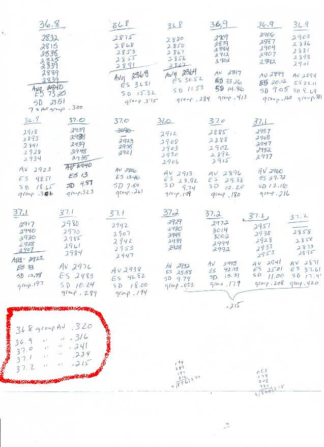

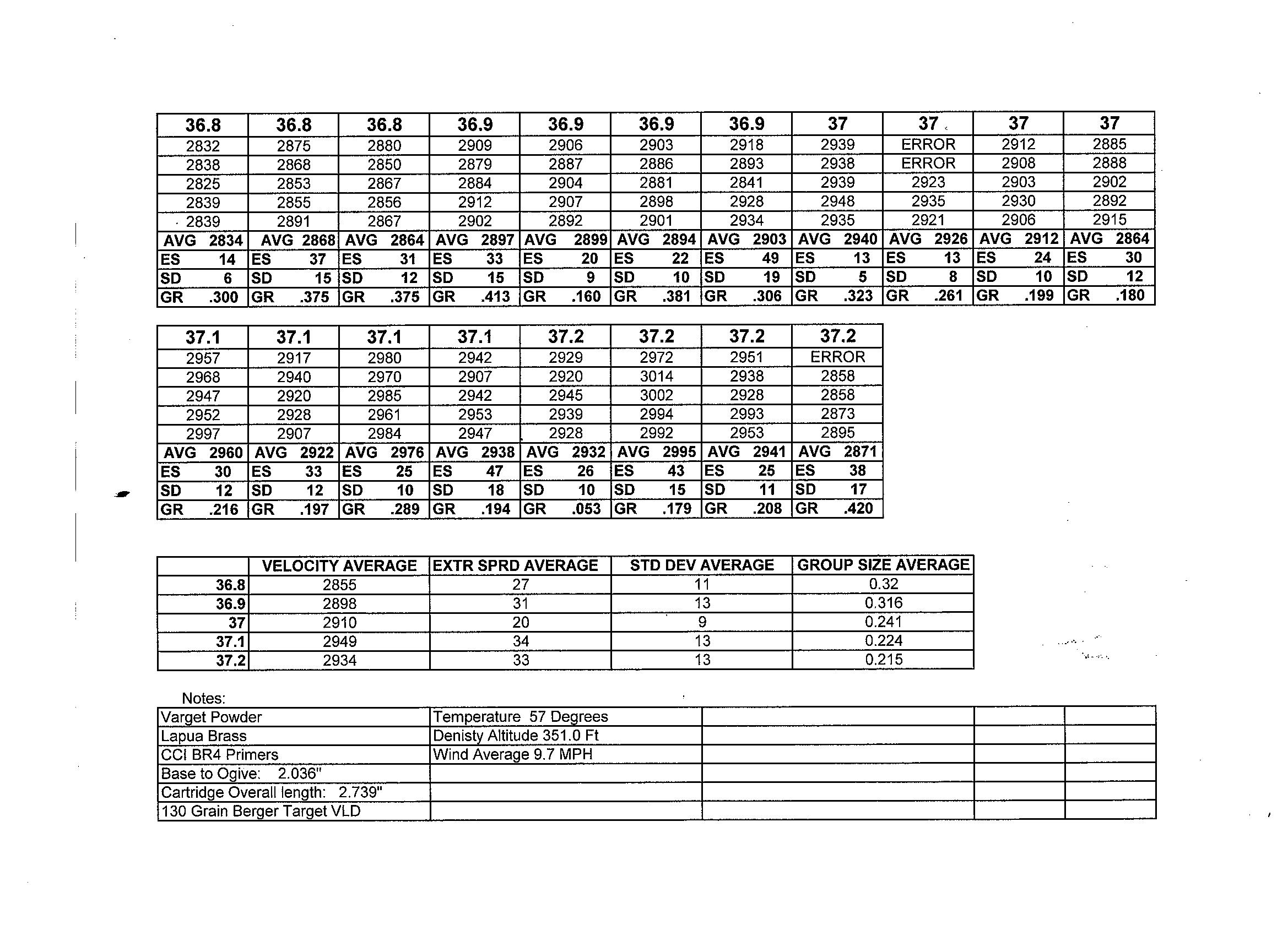

I skipped out of work on a "sales call" today at lunch. I meet my father at the range for a little testing. It was the first time either of us had used a chrono. It was a good time but raised my eye brows to what I need to do to get a consistant ES and get it down. I am wondering if its something I am doing or just the powder. I am using a RCBS chargemaster to dispense the powder.
But anyway I am still very pleased with the performance of my 6.5x47 built by Accuarate Ordnance. Here are a few pics of the targets and some sloppy stats.
Stats.JPGIMG_1524 (Large).jpgIMG_1525 (Large).jpgIMG_1526 (Large).jpgIMG_1527 (Large).jpg
Base to ogive is 2.036
COAL is 2.739
BR4 primers
View attachment 33415View attachment 33416View attachment 33417View attachment 33418View attachment 33419
COAL is 2.739
BR4 primers
Nice shooting, how long is your barrel and did you see any pressure signs at 37.2 Grs of varget?
