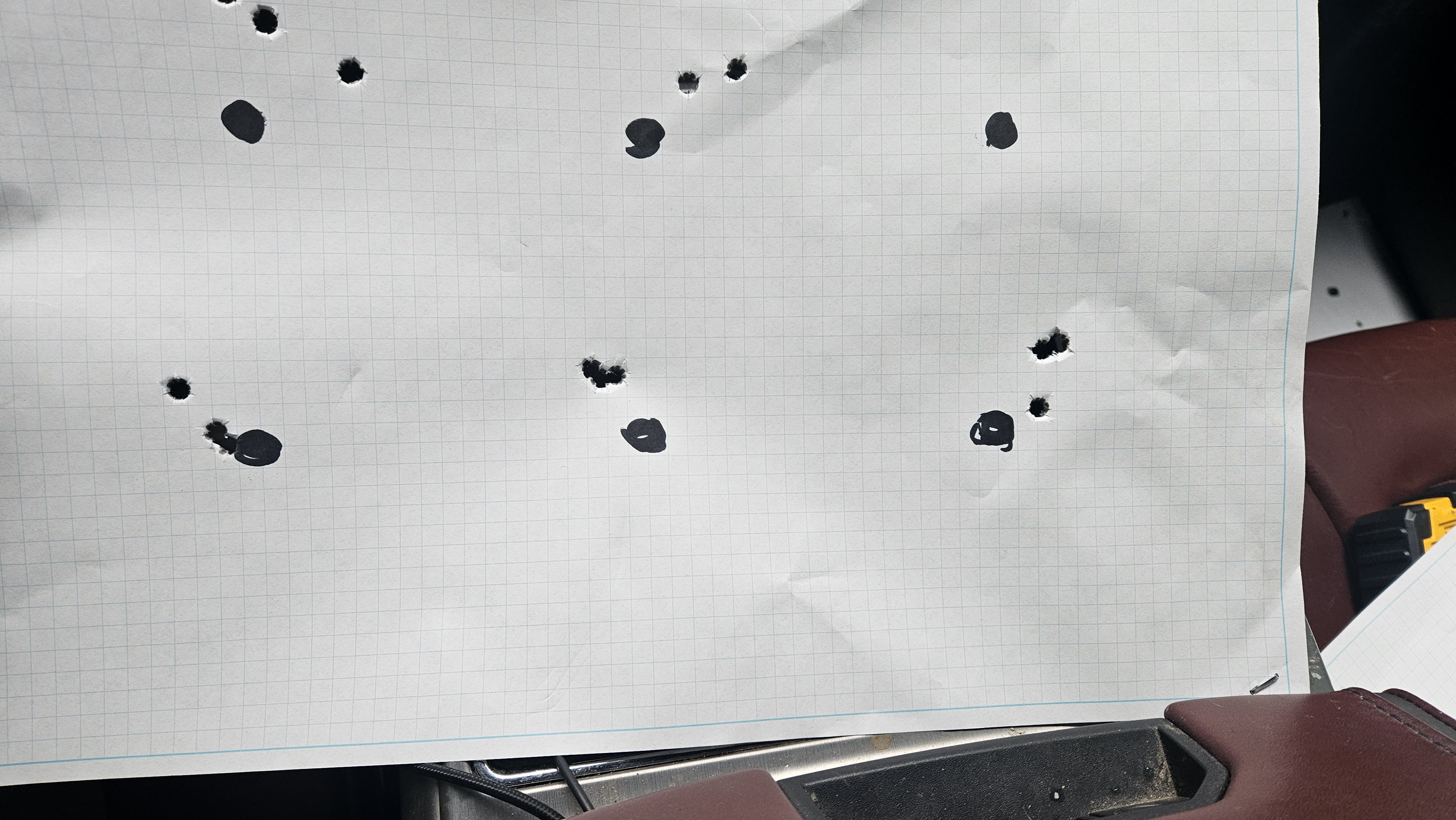

Well we finally got a brief break in the 100F+ heat this week so my son and I got the first ACE barrel out yesterday. Just wanted to put some rounds down it and get this new lapua brass fired.
I loaded up 50rd with new Lapua brass mandreled/chamfer/debur only. FGMM 205M primers, 80 SMK touch lands and 24.2gr Varget.
It was raining, windy and 70F but felt amazing after the temps we had here in the northeast the last week or so.
Zero at 100yd, shot a few groups then banged some steel and played with a few tuner settings. Found a nice setting at 20rds and then the next group was a nice little 5 shot knot.
Velocity was 2850 SD 4.5..
Ill load up the other 50 and get those shot next time out to bang some more steel at distance then get the 100pc processed and do some load development.
Very happy with this barrel so far, looks like its going to be a hammer.
The 0.100 chamber job Mike did is perfect. Puts the 80s right where I want them in the neck for max case capacity. Puts the boattail/bearing surface junction just slightly above the neck/shoulder junction.
28" ACE 1-8 0.219 HV
Manzella Precision
223 Rem Match 0.100fb
Zermatt TL3 single shot
Sidhe BR EVO
Revolution BR bedded stock
EC Tuner V2
Nightforce Competition 15-55
Nightforce rings
Seb Neo

24.0gr even is my go to load for 26" barrels. Straight hammers. I bumped it up to 24.2 just for fire these 100pc of brass because this is a 28" barrel.
Ill do a actual load workup after I have these 100pc of brass once fired and we will see what this barrel prefers.

Loaded up a seating depth test with the low node 23.8gr and I tested 0.005 closer to the lands with the 24.4gr high node...
Checked the weather this morning and it said dead calm with thunderstorms rolling in this afternoon. Not a bit of breeze outside so I ran to the range to test these out before the storms rolled out. Well, as soon as I got to the range 30min later the storms were early. Wind was blowing pretty good off and on, not the day to do a seating depth accuracy test but i was there and shot them at 100yds.
Even with the winds and off and on rain, this combo just continues to hammer out tiny groups...
I shot a 5 shot group on the cold but not clean barrel with the 23.8gr charge to start that measured 0.343"... Not bad.. I then shot these 5 shot groups next with the 4 different seating depth tests.... All the 5 shot groups were in the 0.4's with the one standing out measuring 0.240" in the nasty wind and rain.
I then shot 5rd each of the 24.4gr charge loaded with 2 different seating depths...
I had one out of the group when I caught a nasty gust of wind but both seating depth shot really good measuring 0.244"
I had 6rd left of the 24.4gr load and shot a piece of steel at 200yd which stacked right on top of each other. I shot the last round on the top of the orange line to check POA/POI and it splashed right where I was aiming.
