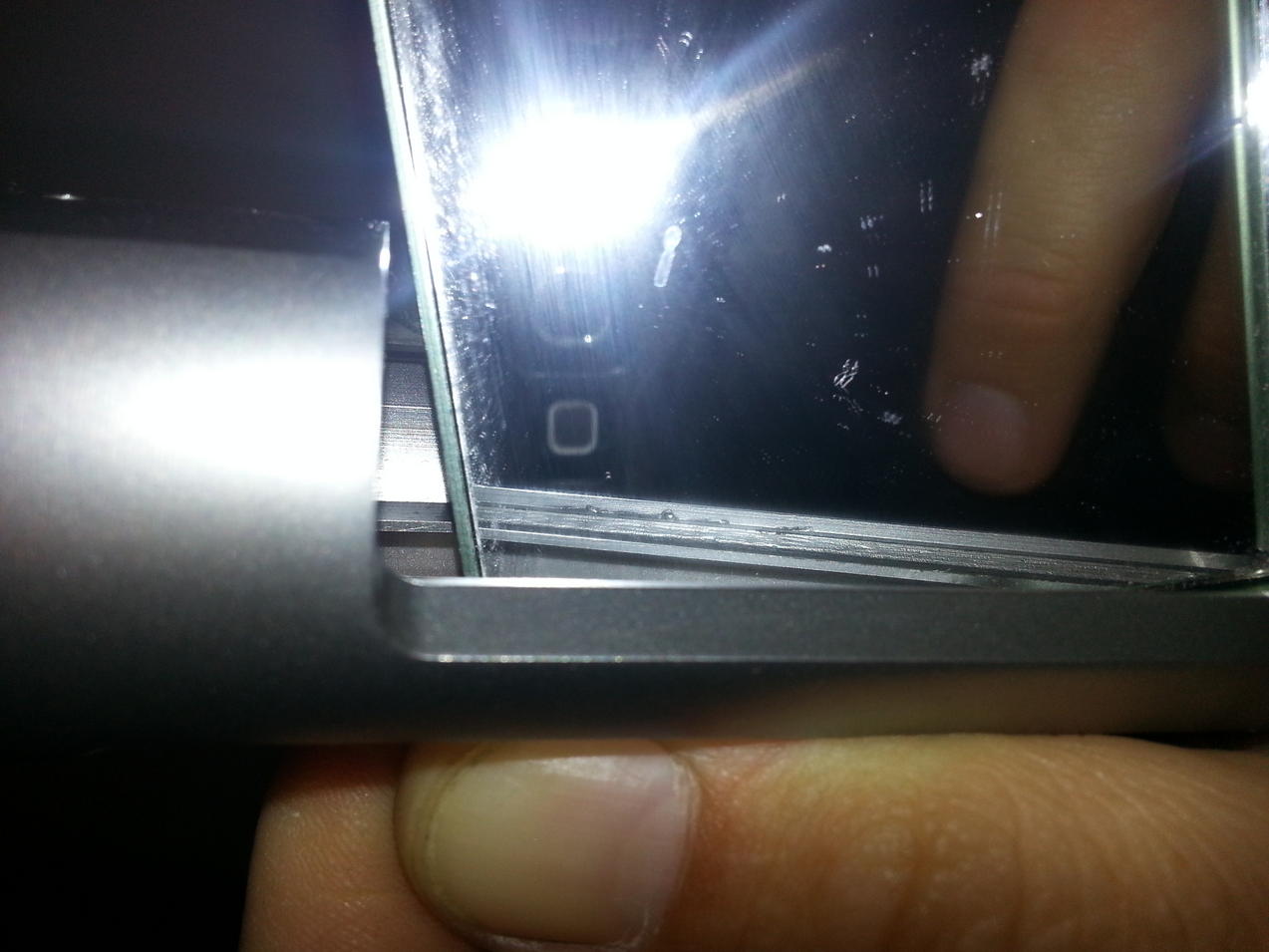

So new 5r out of the box mounted scope for fun to see how it would look then took everything and cleaned all factory gunk and grime wow you would think they would come a little cleaner. So now the good stuff, there is a rough spot in the action right below were the lug rides. Its only on that one side and does not affect the workability of the action and you cant feel it unless you put downward pressure on the bolt as your closeing it. Either way less then perfect. Now what do you guys think is it worth sending back to remington or should I just have a local smith file it down which im sure is what remington will do any way if they do anything at all. Also anyone ever seen this on a factory rifle remington or otherwise?

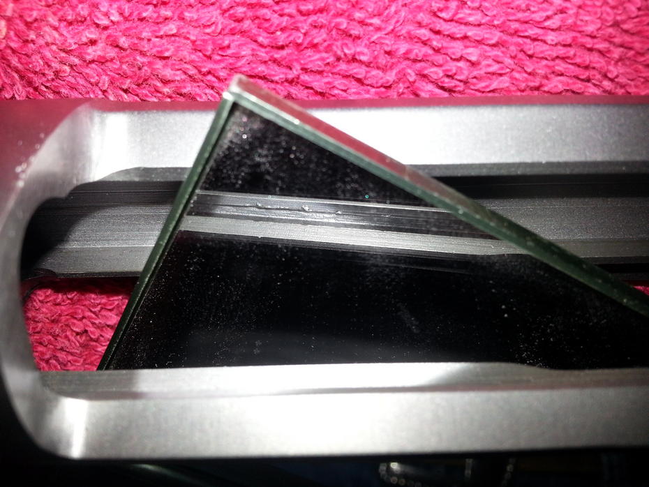

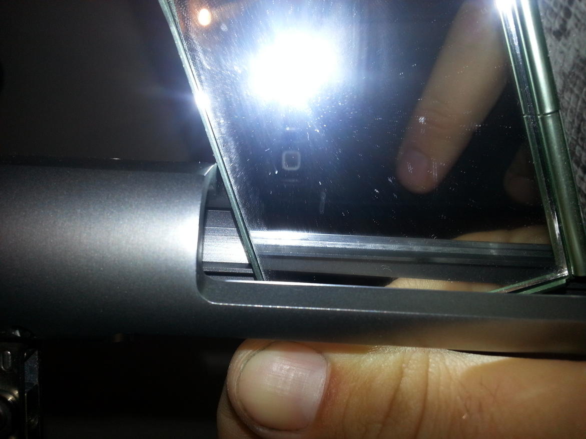

I will try to get better pics tomorrow. If you look real close to ejection side of the action were the bottom of the lug rides, there are some small metal burrs and below is a gouge which the burrs came from. You cant see gouges from pic. Will get a mirror tom. and post more pics.
I can seem to see anything in your picture. My eyes are going to crap...
At least give them a call. They might do something right since there CS is 50/50 at best.
Well that is crappy. I dont know whats up with Remington, but Im done buying new Remington guns.. Im thinking of getting a 300 rum made with the 2013 Badger Action, but Remington (To me) seems to not watch the quality as well.
That isn't gunk and grime so much as protective coat of gunk and grime to keep it from corroding. Most all new guns of any brand come with thick stuff caked on.

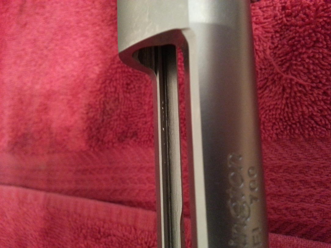

What I see it looks like there's a slight burr where the lug rides the raceway. You could put some lapping compound on the channel and work it about 100 times and it will take care of it. Or you could just keep shooting the thing and it will wear in on its own. Its not going to hurt anything if you ignore it. It will go away. Remington rifles to be quite a bit better as the wear in.
It's a little beyond a burr...Looks like whoever was "working" on smoothing the injection port slipped...
I'd definitely give them a call...That's really hard to miss, too.
You dont think this will have/cause any wear on my lug?
What I see it looks like there's a slight burr where the lug rides the raceway. You could put some lapping compound on the channel and work it about 100 times and it will take care of it. Or you could just keep shooting the thing and it will wear in on its own. Its not going to hurt anything if you ignore it. It will go away. Remington rifles to be quite a bit better as the wear in.[/QUOTE]
It's a mass-produced action. The only "Premium" thing Remington did was screw in a 5R barrel.
If you want it smoothed out you'll probably be best served (and happier) getting a local to polish out the burr for you. My guess is (if you send it to Remington) you'll get lip service about "That's how we make them," and you'll be out shipping to them and back. You could insist they send it to the Custom Shop, but you'll never know if (and when) they'll be able to take a look at it and correct anything.
Unless I'm missing something, my screen isn't that great. If nothing else, take it by a local smith and ask his opinion in person. I'm sure it would be cheaper than sending it back to Remington for a "go screw yourself" response seems about half the people get from them.

Break out the dremel and smooth it out (don't be scared :). I just picked up a new 700 police for a .308 build and I don't have this issue as the channels are nice and smooth. From the look of the photos, I don't think it will affect the rifle any and what little imperfection that is there will smooth out over time. As long as the bolt operates as required and it is not hanging up, roll with it. JMHO

I would definitely not send that back to Remington. I wouldn't dremel it either. I'd just get a small stone and work off the high spots, and perhaps put some rubbing compound on it and lap it in.
Hell, leaving it won't hurt anything and it will go away with time.
Just file it down and call it a day. It's a nice rifle. I'll be glad to entertain taking it off your hands for a "damaged goods" price!

So to crack at it. 5mins had her whooped into shape! Used an old points file( used for points on a distrubter cap for you non auto mechanics) well a broken piece of one anyhow, that and some 220 grit emory cloth. Bolt moves great and cant even snag a patch on it! Thanks to all for ideas and comments. Lots of good info from hide members.

Looks really good. I can't even see a hint of the burred areas. Good call on taking matters in your own hands. I'm sure you have more self satisfaction this way as well.
P.S. - if you go back over it with 600 -1000 grit and polish with flitz or similar it will be like a mirror; if you want of couse. May not be needed.
Glad you got it slicked up! Looks good to me!
