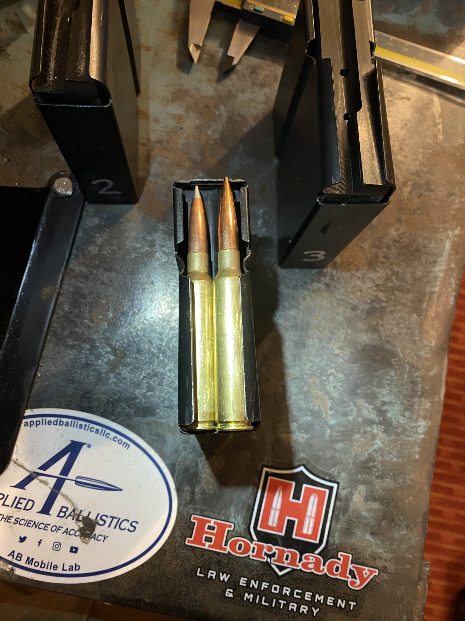

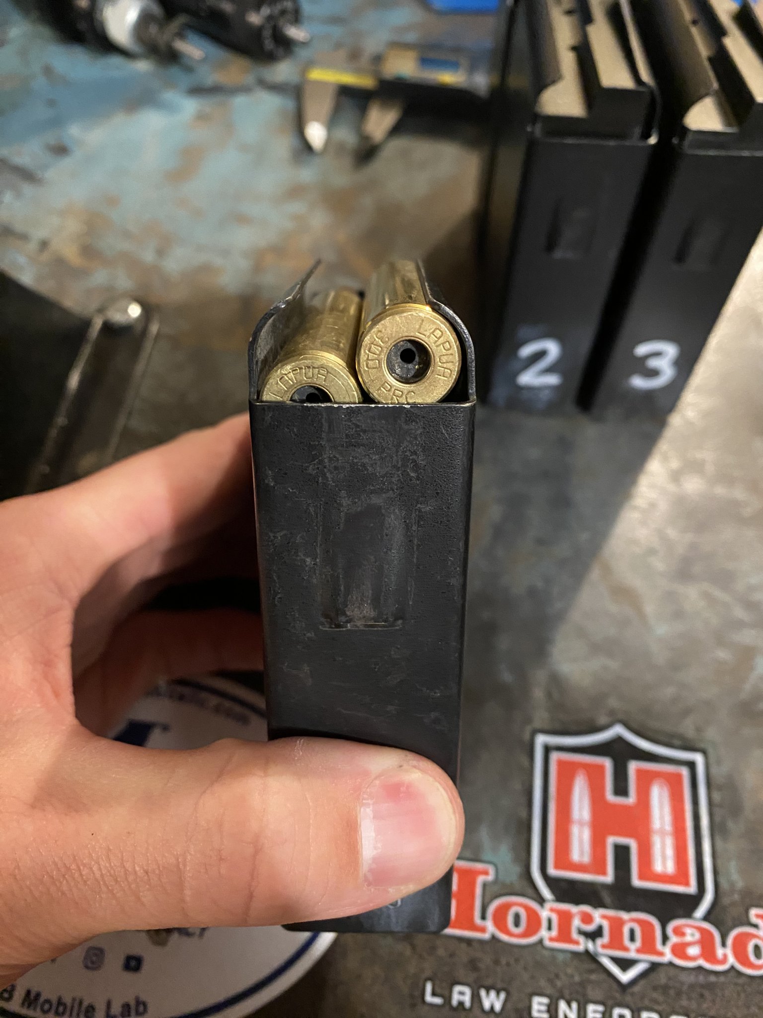

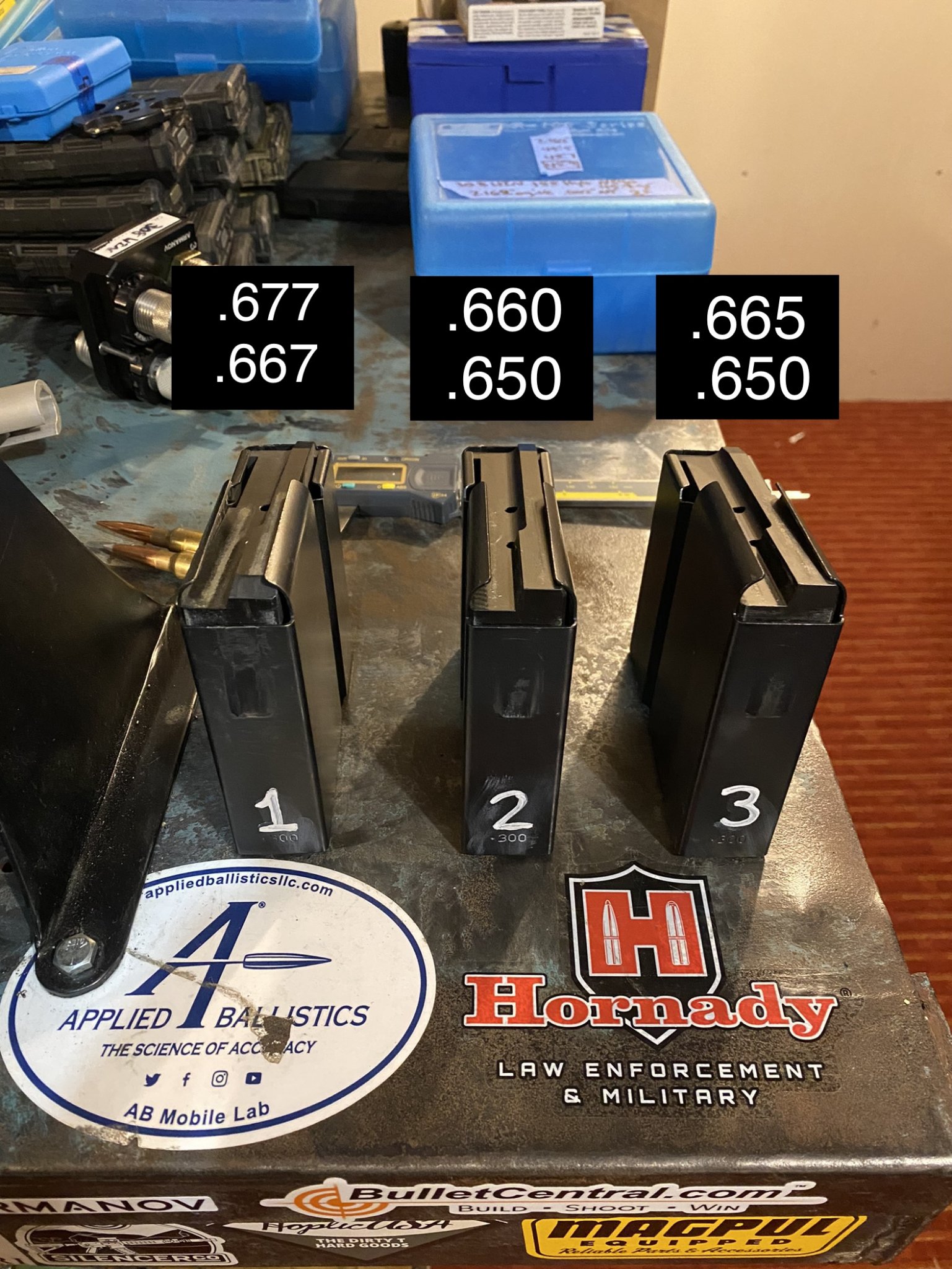

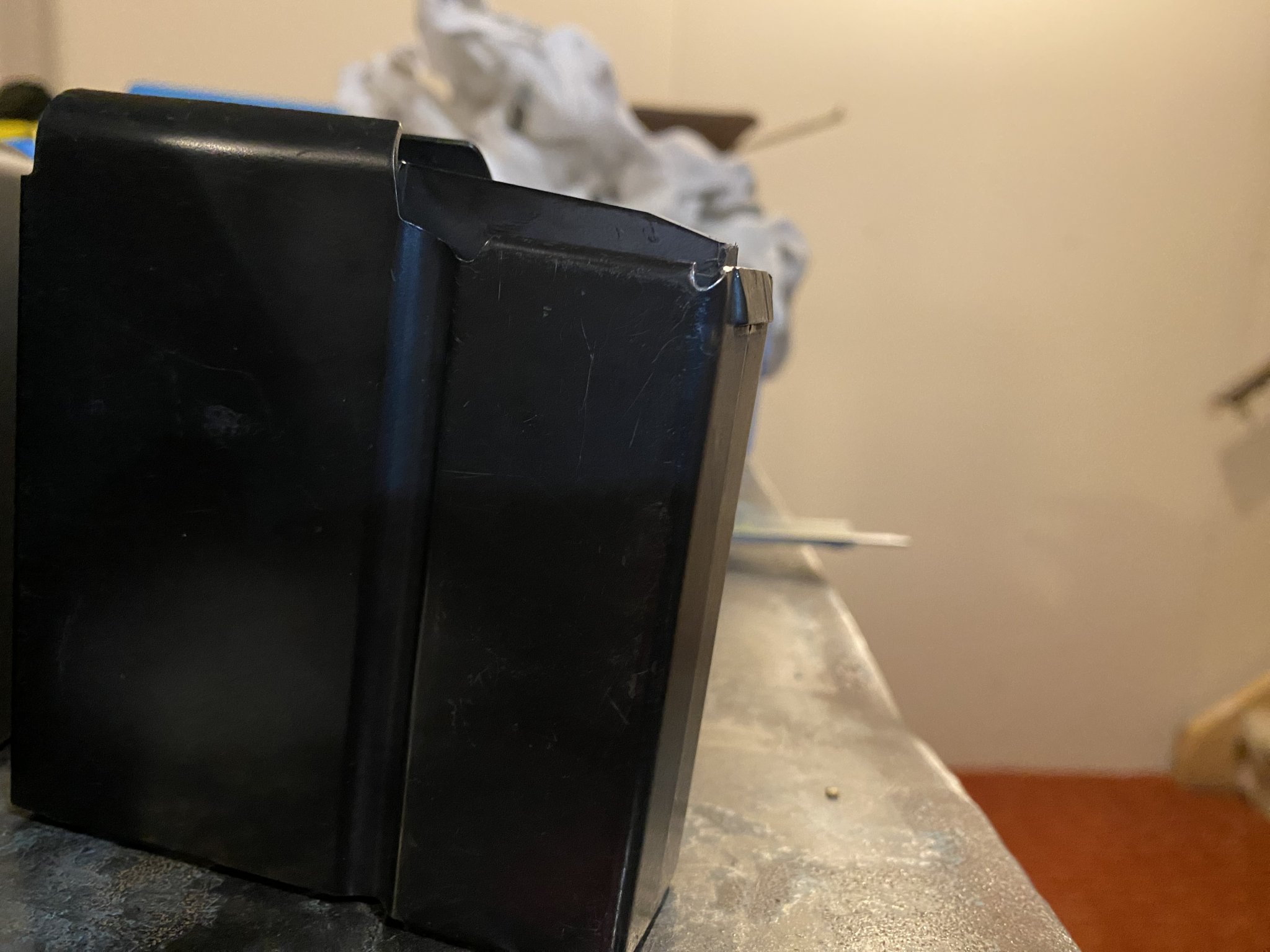

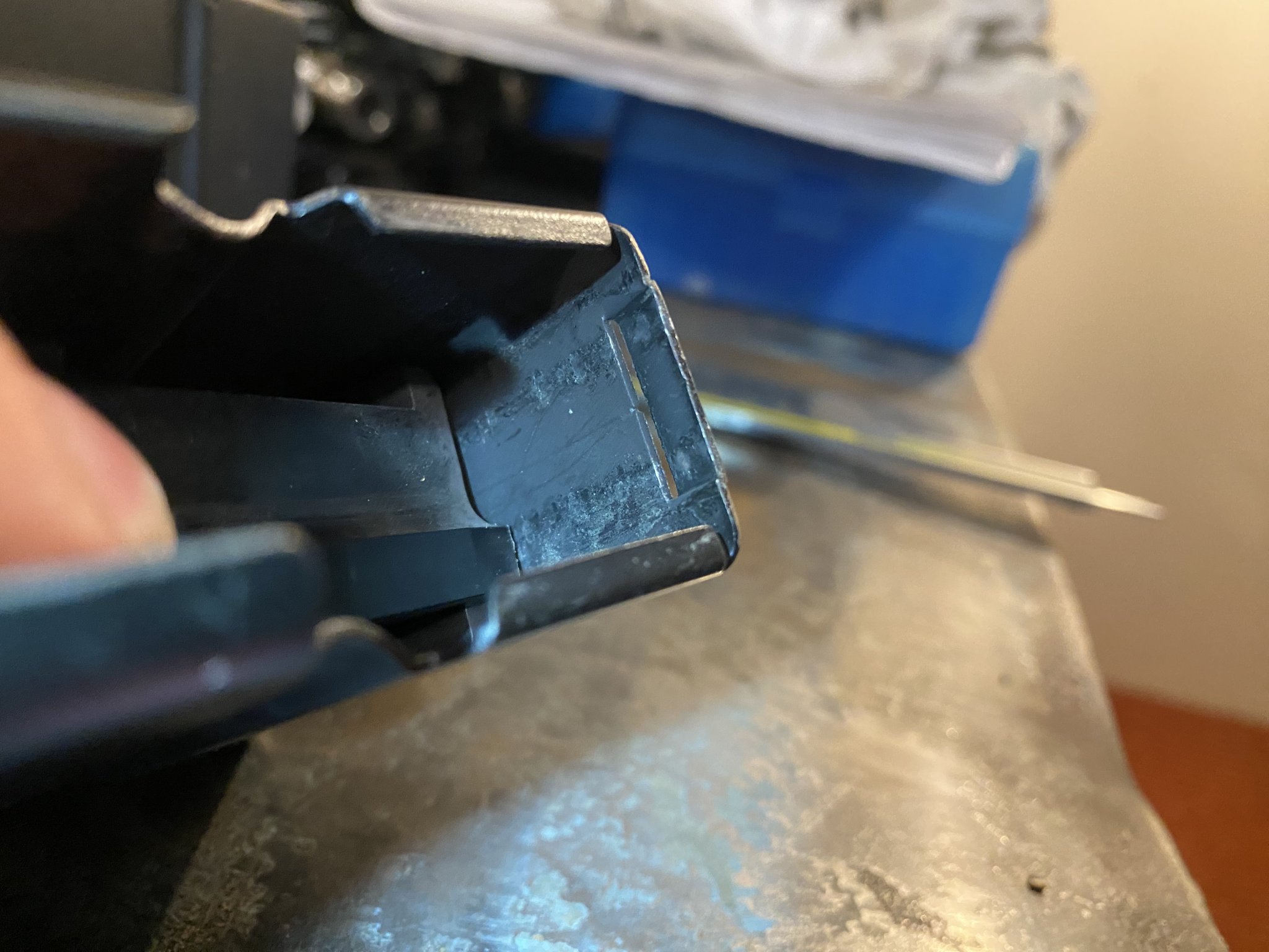

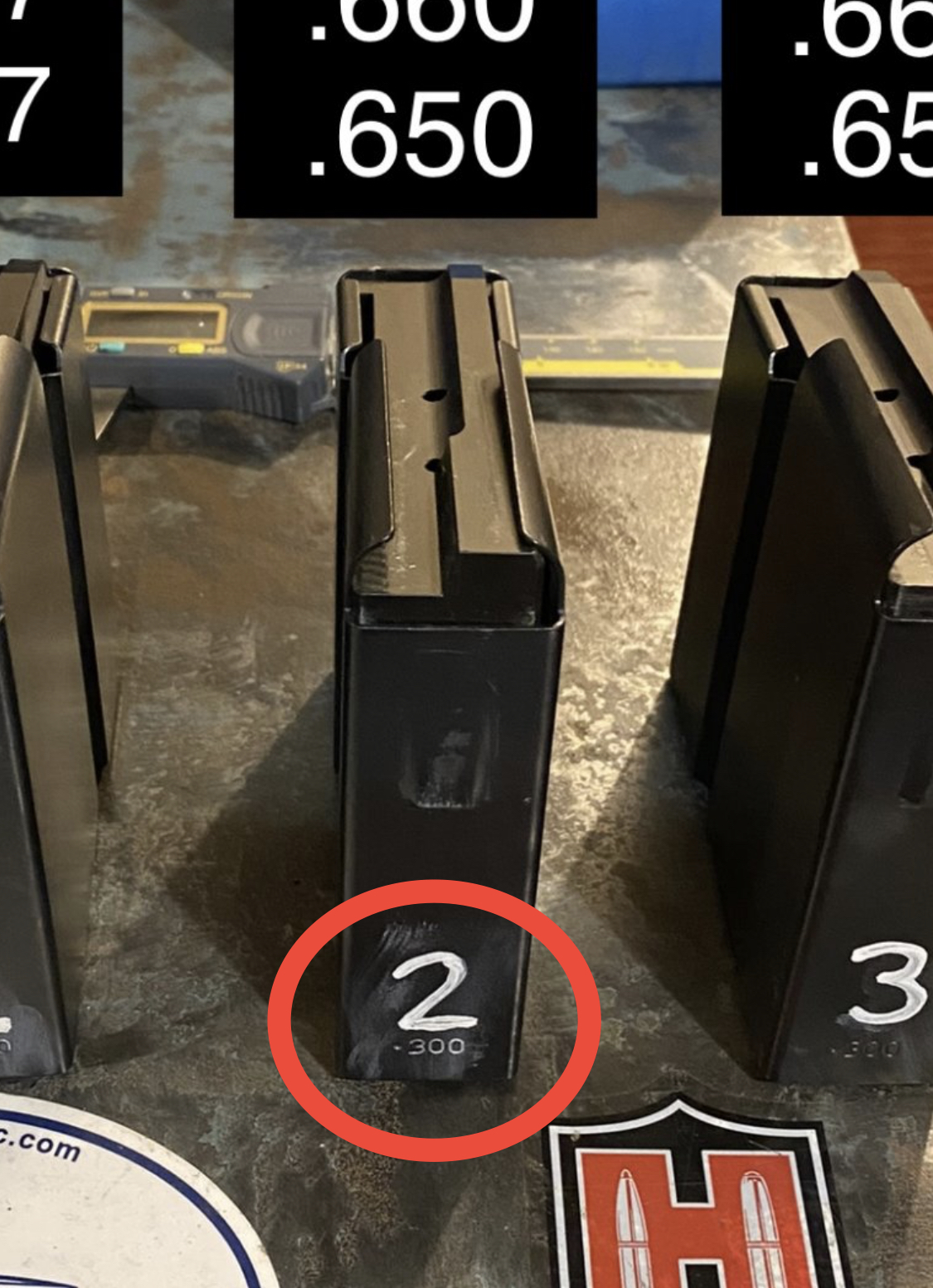

Ok, so here are a few pics of the modified 6867 12 rounders I have. These are all 100% functional mags used in my old MC and now SR. The feed lip dimensions as noted are front on top and rear on the bottom. Obviously as you can see by the variance this isn’t an exact science, but ballpark with about a .010-.015 flare towards the front of the mag works best.
Also note the locking tab on the front of the mag has the top angled inward. This acts as a ramp to help cartridges not hang under the lip of the receiver. You can see the a-tip tracks on the inside of the mag and on this “ramp”
You’ll note round presentation is very high in the mag, but this is consistent across the three I have. Once the feed lips are flared outward the round stack presents a lot straighter. Sorry for the lack of rounds, all I’ve got on hand are a couple proof dummies.

Thank you for taking the time to post this. When you say that these are ”100% functional” can you confirm that they do work both during shooting and also cycling live (or dummy in this case) rounds out of the mag by simply running the bolt?
I can definately see the difference in the clearance at the neck and the beginning of the shoulder on your mags vs. the plastic bottom 10 round mag that I have. This is the area that binds on my mag with the round stack and prevents the stack from returning to the correct position. You can see it in the pictures from my earlier posts.
Yep, these were tuned by basically filling up the mag, running the bolt until it was empty, and rinse/repeating until there weren’t any failures. They work in feed testing on the bench and in live fire.
The other ass pain about these like I touched on in the prev post is spring pressure on the front of the round stack. Not all of these 6867’s are created equal, and I’ve seen some not have enough ass in the spring to push the nose of the cartridge up the “ramp” in the photos, which leads to a nose dive when you try and run the next round in the chamber. This unfortunately can’t really be tuned, and you’ll notice mag 3 in the pics has the least use, largely because it has the weakest spring.
The spring issue is double bad with the new plastic baseplate mags because it’s trying to overcome friction from the round stack being pinched together by the taper of the mag body at the shoulder junction. You’ll see some that look like the follower is stuck in molasses the round stack moves upward so slowly.

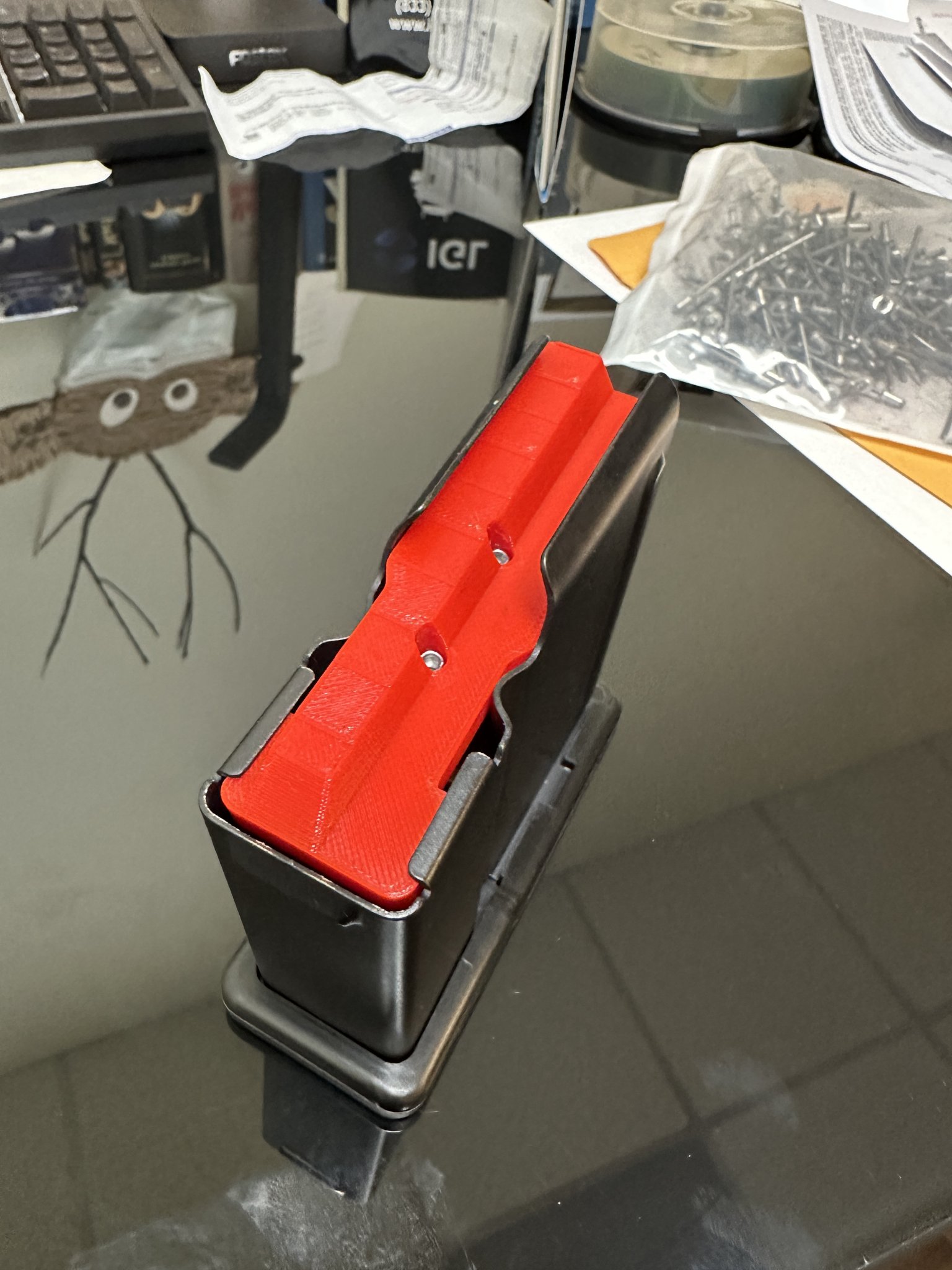

UPDATE: We’re working on some in-house solutions for this. We should have preliminary testing complete by the end of next week. I’ll keep this thread updated to our progress. The goal is to provide a solution that will continue to work with .300 Win Mag and/or be reversible to allow this functionality. We don’t want to alter the magazine in such a way as to require the user to buy another mag if they want to go back to .300 Win Mag.
We have been working with a new 3D printed magazine follower design. The good news (so far) is that this will be a cost-effective upgrade and still allow interchangeability with .300 Win Mag cartridges. We will do live fire testing next week, but benchtop testing has shown greatly improved function with 300 PRC cartridges.
I will post an update as soon as we have completed live fire testing with 300 PRC and 300 Win Mag.

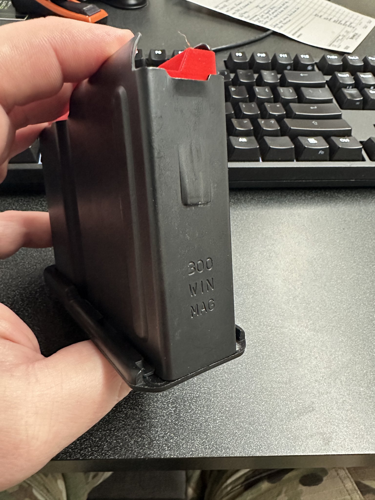

just to let you know that's a 338 LM , magazine 300 WIN MAG has narrower body.
Again, no.
Like I mentioned earlier those are .300WM mags from a decade ago when the PSR was a thing. Same body and follower as a .338 mag, different feed lips. That’s why those are 12 rounders and not 10’s.
Obviously the pics with "300 win mag" are self explanatory, but here was some discussion earlier in the thread saying PSR mags were generic. and the SKU page on Mile High shows they are marked "30 cal" or ".300" etc -- not the same as the Win Mag specific ones (AXMC/ASR etc). Some body please correct me if I'm wrong tho.
Obviously the pics with "300 win mag" are self explanatory, but here was some discussion earlier in the thread saying PSR mags were generic. and the SKU page on Mile High shows they are not marked "30 cal" or ".300" etc -- not the same as the Win Mag specific ones (AXMC/ASR etc). Some body please correct me if I'm wrong tho.
lol ok, you’re wrong.
UPDATE: Live fire testing is complete and the magazine ran flawlessly. We can also confirm that compatibility with .300 Win Mag is maintained. This truly is a better mousetrap. Upgrade cost is $40 which includes follower, installation, and feed lip tuning (if necessary). Return shipping to the customer is not included. Reminder: This upgrade is for the AI factory 10 round ASXR magazine in .300 Win Mag with the plastic magazine base plate for use with 300 PRC. Please contact us at [email protected] I will DM phone number on request.
UPDATE 07/08/23: We now have a revised 300 PRC follower for the older AI .300 Win Mag magazines with the welded, non-removable steel base plate. We've done nearly 2 dozen magazine upgrades for customers with no reported issues. Please don't hesitate to reach out if we can help.
