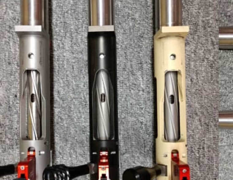

Here are mine. The gray and tan are AW cut, the black is AICS cut. I've noticed no difference in functionality running ARC or AICS mags with 6.5 Creed, .308 or BR based calibers in any of them.
