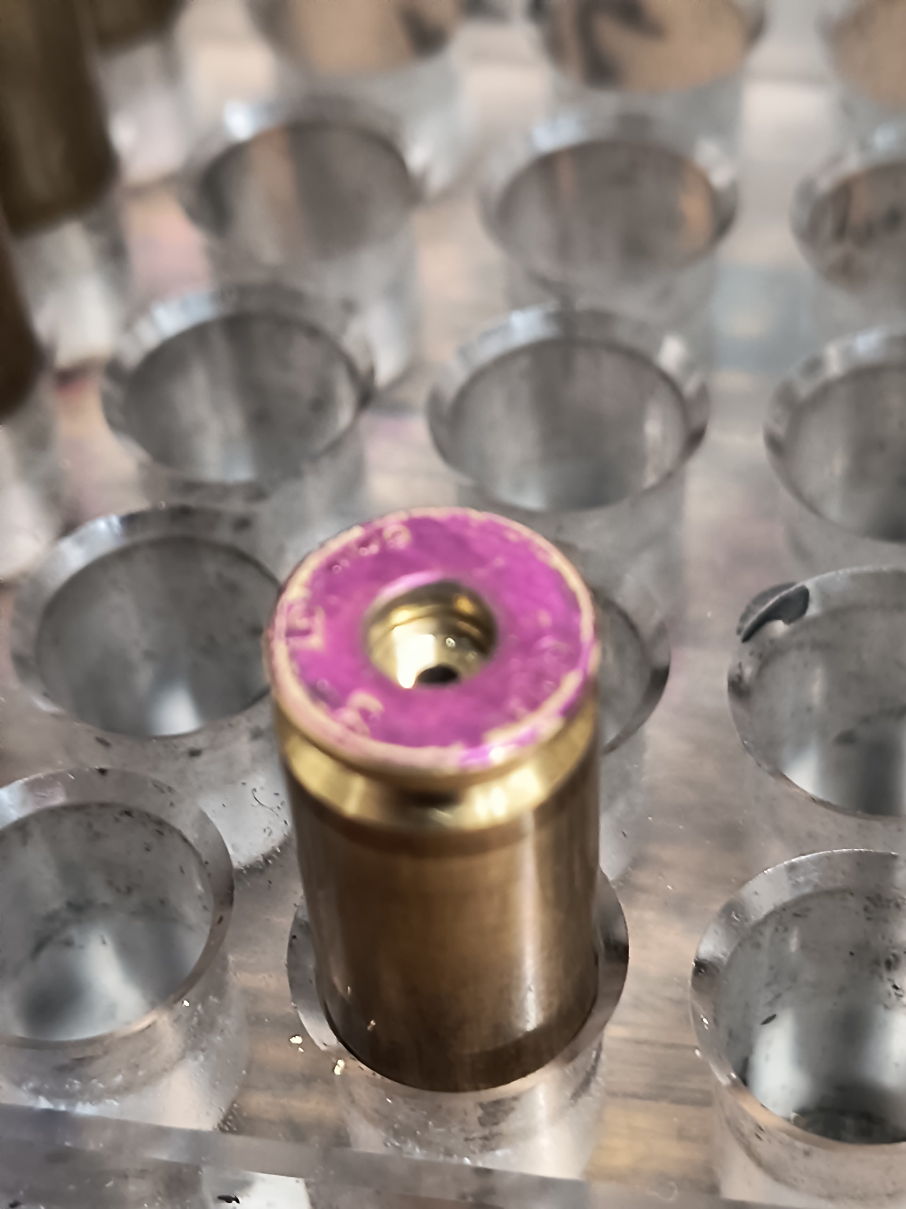

    So with my alpha brass I have found the bottom of my cases to not be flat and the shoulder to be .01 away from first firing.
    After first mild load the brass smears the cartridge wording slightly as that base flattens against the bolt face and the shoulder elongated to my rifles chamber.
    Putting a straight edge on the bottom of my brass revealed the concave bottom. Is this normal with alpha brass? I also get heavier than normal bolt lift.

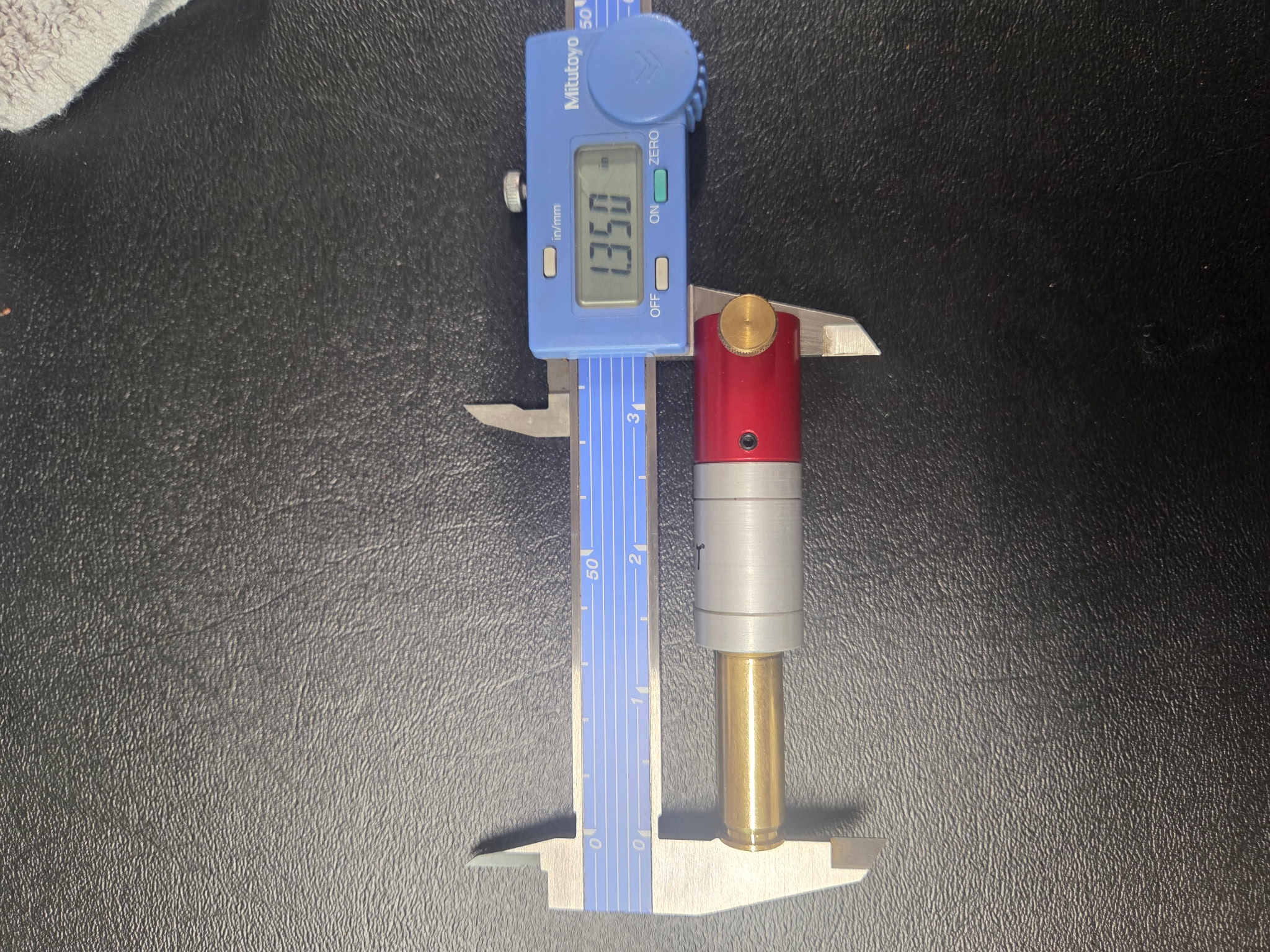

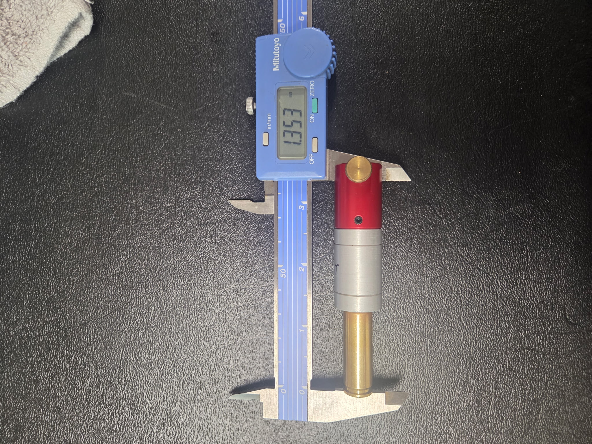

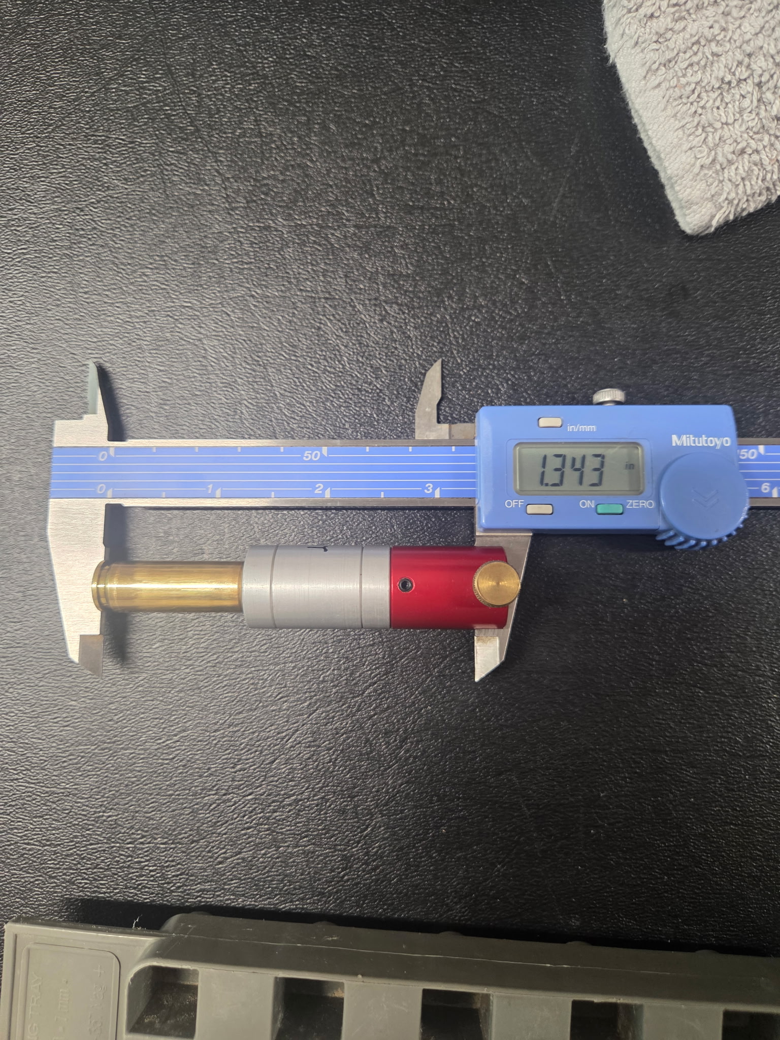

    So the cartridge is 6gt
    Measured it with a starrett digital caliper and a headspace comparator no bullet in case.
    Going to order a Wilson case gage and use a interapid indicator on a granite to recheck.

    1.343 Alpha V.
    1.353 Alpha O.F.
    1.350 Hornady V.
    1.353 Terminus shoulder length.
    I don’ t know anything about 6GT dimensions but if those were my measurements, I’d write them down as reference and keep doing what you’re doing. Looks fine to me. Hornady’s load book is useless unless you are using their brass so…back off the load a little more and try the bullet jam method I mentioned above. Or do nothing and accept that the alpha brass is experiencing some case thrust on first firing.

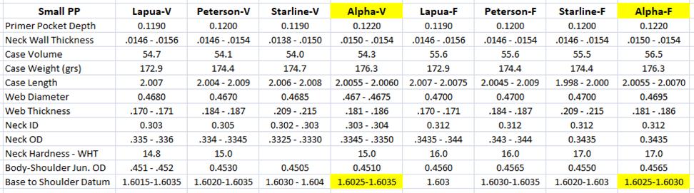

    I didn't have any of those issues with the .308 brass I got. Here's a comparison of measurements I've taken (V for virgin, F for fired):
    In the case where it was really good, was your brass expanding .010” on the first firing? I’ve had predictably low SD’s with Virgin Alpha as well, but typically in cases where the brass is only expanding a thou or two on first firing. The new 25 x 47 brass I referenced above only expands .002” on initial firing. That chamber is cut particularly tight. As expected, the SDs were very low from the start.
    Yeah, you're right . . . brass expanding .010" on firing isn't going to produce such good results. I've never had that problem.
    As you can tell from my chart I posted above, my virgin Alpha brass fit nicely into my chamber (a Krieger barrel). :)
