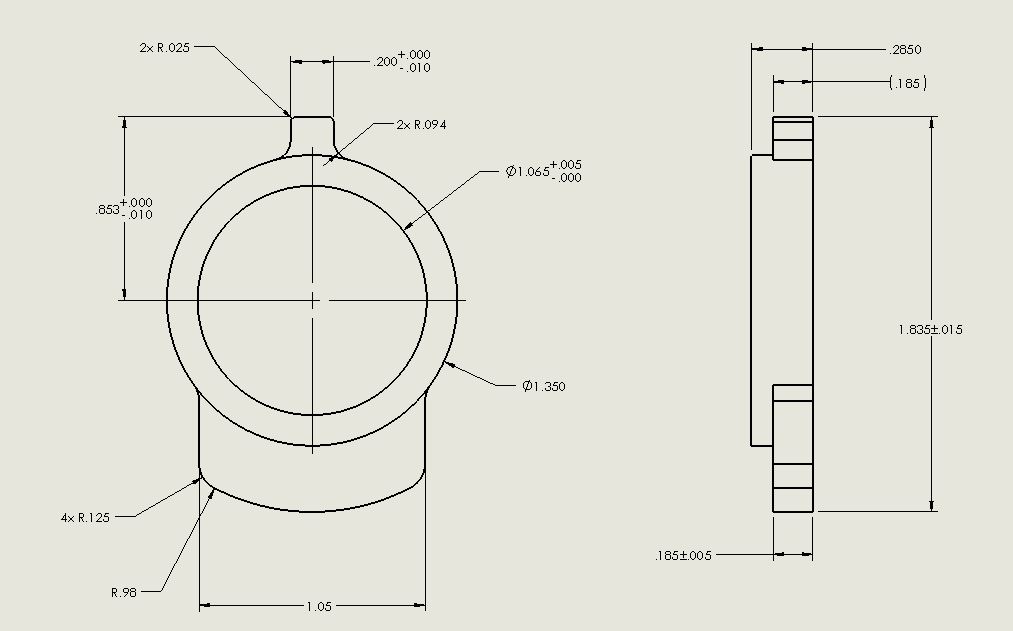

I was thinking it was just a .100" spacer used with the stock Nuke lug. Without pulling my Nuke down I'm thinking it's .187" thick like a factory M700, so maybe a 287" thick lug? One piece would be much better than two IMO. I would try that. Does anyone sell these lugs?
Mine mics out at .1850-.1852 so that's what the print reflects. If you make this print exactly you can't use the wedge lock on a XYLO, but if you have it made with a 1.25" boss forward of the original lug part instead of 1.35 you'd be set.

@Ledzep would the spacer be the same as the one to run an origin barrel on a TL3? which i believe PVA makes
i'm pretty sure the one i had a friend make was .100" x 1.25" OD. i forget what the ID was
I think you are misremembering your Orgin recoil lug dimensions.
Yeah, that should be the same thing.
now im trying to figure out how to run an Origin or TL3 barrel on my Mausingfield
i guess it would just be a TL3 barrel with the .100" spacer ring
or an origin barrel with a .200" ring
if im reading the prints correctly

TL3 S/A Barrel, 1 ring
TL3 L/A/Origin, 2 rings!
I'm kidding. I'd have a .200" ring made if you want to do the latter.

So if you took a tl3 long action barrel and added the spacer ring from pva it should headspace right on a long action nucleus gen 2
You'd still be .100" short. The TL3 S/A barrel tennon is .100" longer than ALL of the ARC actions, long or short. The TL3 long actions have a .100" longer tennon than S/A, and .200" longer than the ARC actions. TL3 has a difference long and short, ARC doesn't.
To clear things up, if I have an Archimedes action and wanted to use a bighorn/zermatt shouldered prefit barrel, I would need to get a short action TL3 barrel and one of the PVA origin to TL3 spacers, and it would then work perfectly correct?
So the long action needs 2 or one that is .200
Reactions: Ledzep
I‘m confused on this. The Hunts Long Range Orgin to TL3 lug is .150” so I would think the PVA Orgin to TL3 spacer would have to be the same? We want .100” spacers to fit a TL3 SA barrel on an ARC Nucleus or Archimedes right? Edit: Yes it would work because the PVA spacer is .100" thick.
It's not about lug thickness. It's bolt face to recoil lug face (or receiver face in the Archimedes and MF). If you were to put a depth mic on the face of a TL-3 and measure to the bolt face, it would be .100" longer than if you put a depth mic on the face of an ARC action and measured to the bolt face, thus the necessity for a .100" spacer ring.

Thanks for the tip on the barrel spacing @Ledzep I'll have to turn two spacer rings just incase I come across any TL3 barrel deals.
the Origin's factory recoil lug is .250" so the HLR lug reducing to .150" thickness would be a difference of .100"
I got it now. I was focused on the HLR lug and not the spacer. Thanks Ledzep and j741!
