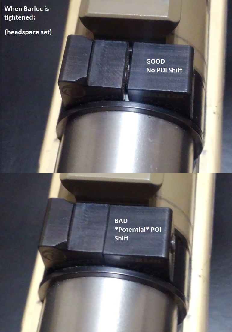

Ted did testing on it and found that you can get POI shift with the Barloc. He also did testing that showed that you can get POI shift with a traditional shouldered barrel torqued on, so I believe he decided to continue barloc sales and don't believe a change will be made.
I have done some testing personally because I have access to a 100yd indoor range that limits outside influences and allows for really good precision testing. What I found is that you need the barrel to AT LEAST butt up to the barloc before tightening the barloc screw. In order to make that happen in my PVA prefit I had to ream the chamber a little deeper.
Originally I would bottom out the Barloc when tightening it, after pushing the chamber forward like .007", it makes me screw the barrel in .007" more to head space properly, and it contacts the loose barloc when headspaced on a GO gauge. The barloc still has a gap when the barloc screw is tightened down.
With the Barloc bottomed out I got POI shift with 'moderate' barrel impacts. With a gap still present I haven't documented any POI shift with what I'd consider reasonable impacts. I hit it fairly stoutly on a wooden frame to simulate me dropping the rifle or not pulling the barrel out of a barricade before trying to move, etc... No POI shift. I didn't go full retard with it-- I'd imagine if I wailed on it with a rubber mallet I could get POI shift but I don't see why that's a relevant test.
Have not personally tested savage style barrels with the barloc.
To put the above in picture format...

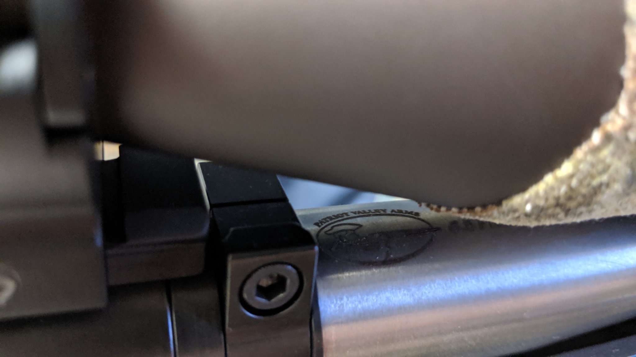

I use a Barloc with a Savage prefit and barrel nut, and part of the assembly instructions are to tighten the nut until you can slip the spanner wrench between the sides of the Barloc. After tightening there’s still a gap that’s about the same as what Ledzep’s image shows.
I haven’t noticed any POI shifts on reasonable impacts with this setup. I wish I could buy another couple, for other builds, but ARC isn’t selling the main part of the Barloc right now, only the washers/lugs/nuts/screws.
