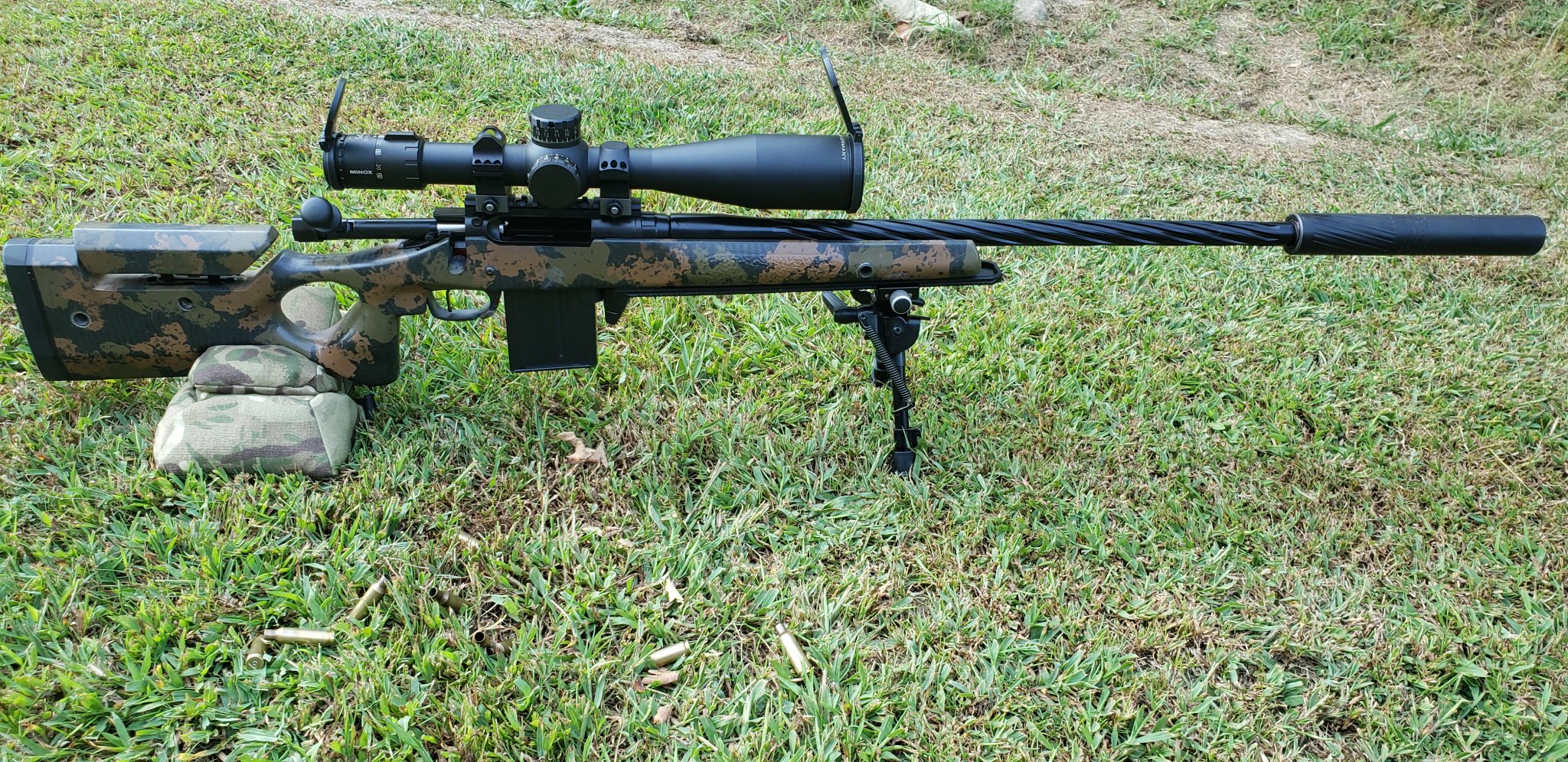

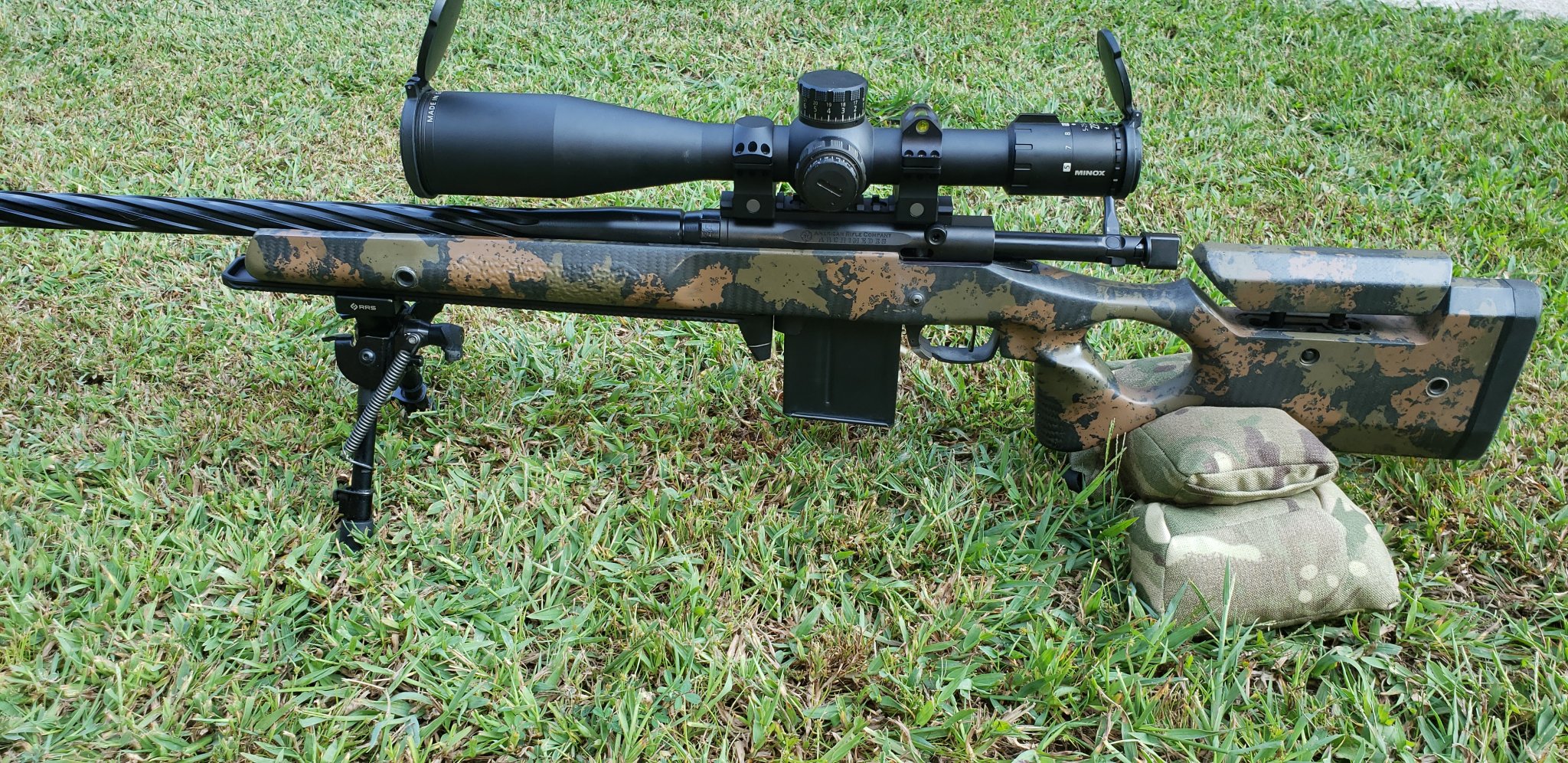

Fired a few down mine today, and Im liking it. 6.5x47 runs flawlessly with Alpha and AICS mags. Triggertech diamond did not show an issue. This action is stupid smooth and can be ran fast. The pivoting bolt handle barely moves and you dont notice it. This feature may aid in extraction, but honestly does nothing for the feel of the action. I do believe this is going to be one of the actions to beat. Ive been running a Mausingfield since it came out, and will be using an Archimedes now. I bought several Archimedes actions with plans to build a few, but got impatient and built on other actions. However, I am keeping this one.

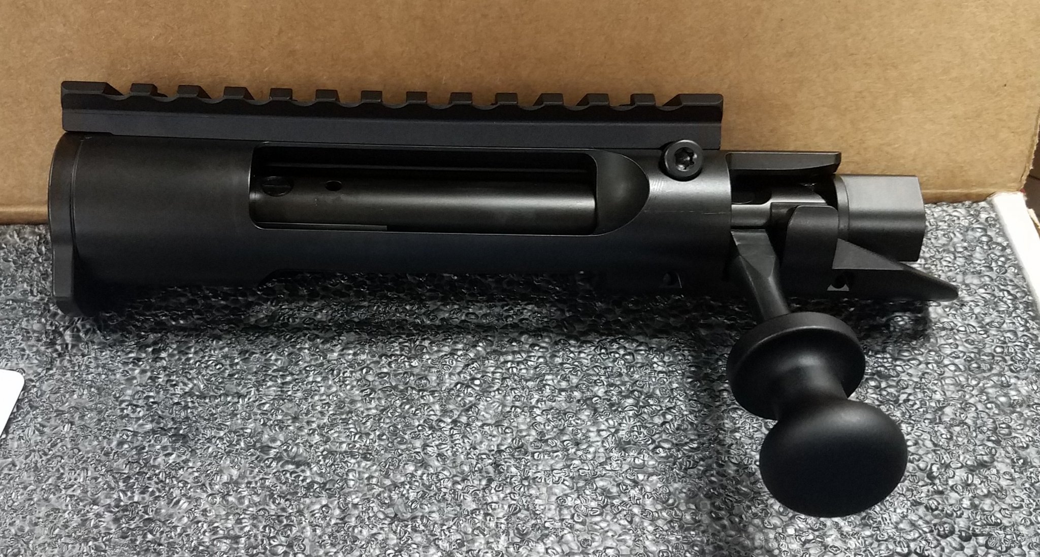

I'm waiting to pick mine up from the FFL, as I'm currently out of pocket, but after seeing some of the pics, I'm feeling like we are getting more than we thought we were with this action when we put down for the pre-sale. Meaning, I wasn't expecting the integral lug and I definitely wasn't expecting the keyed scope rail. In my opinion that's the best system design on the market.
Interested in the head space news as well. Already have a bunch of MFs and Nukes with associated barrels and spares.
That’s basically how I feel for my upcoming 300 PRC build. There are a lot of excellent actions on the market, but damn if this one doesn’t have a hell of a feature set to beat.
