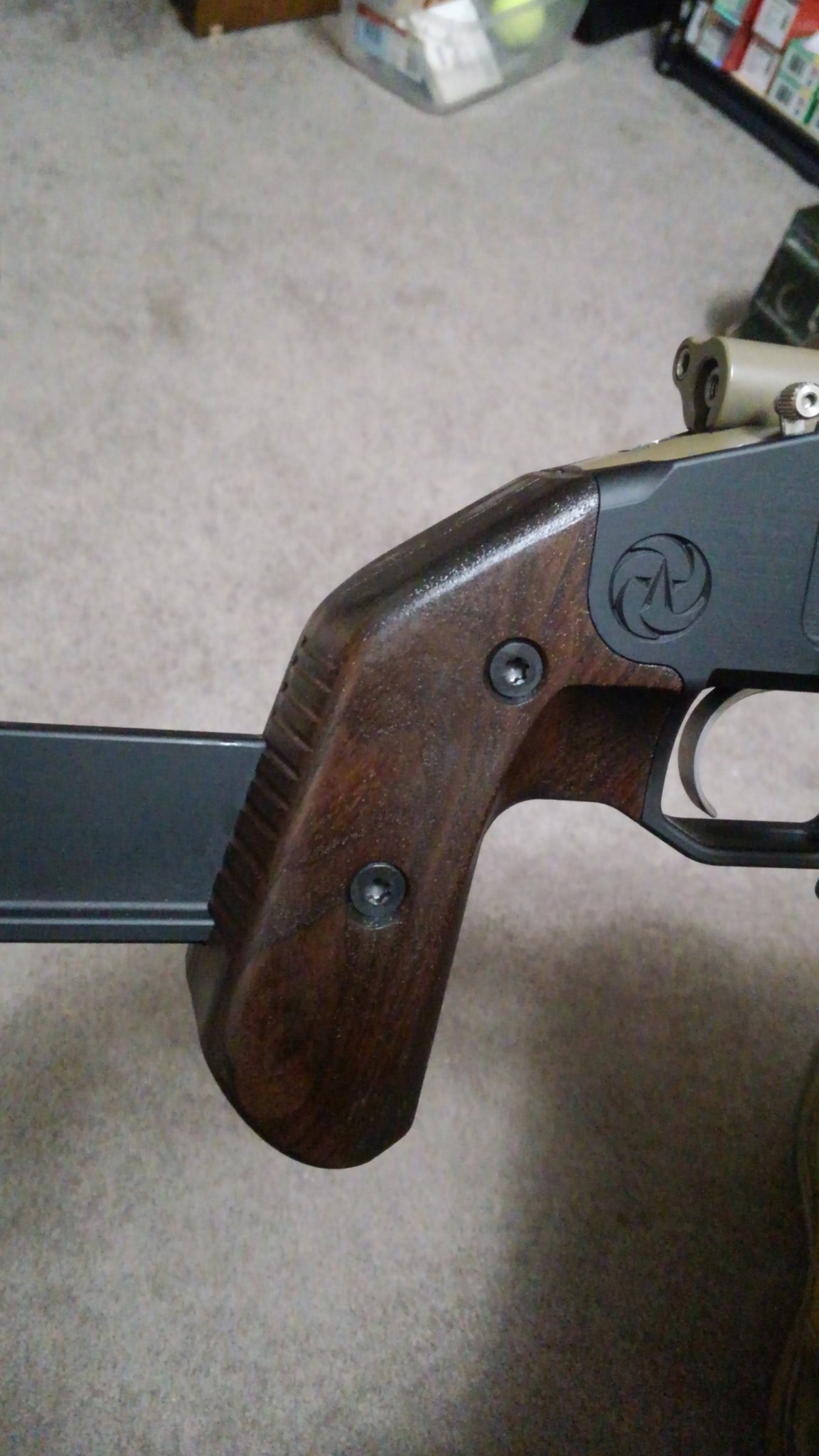

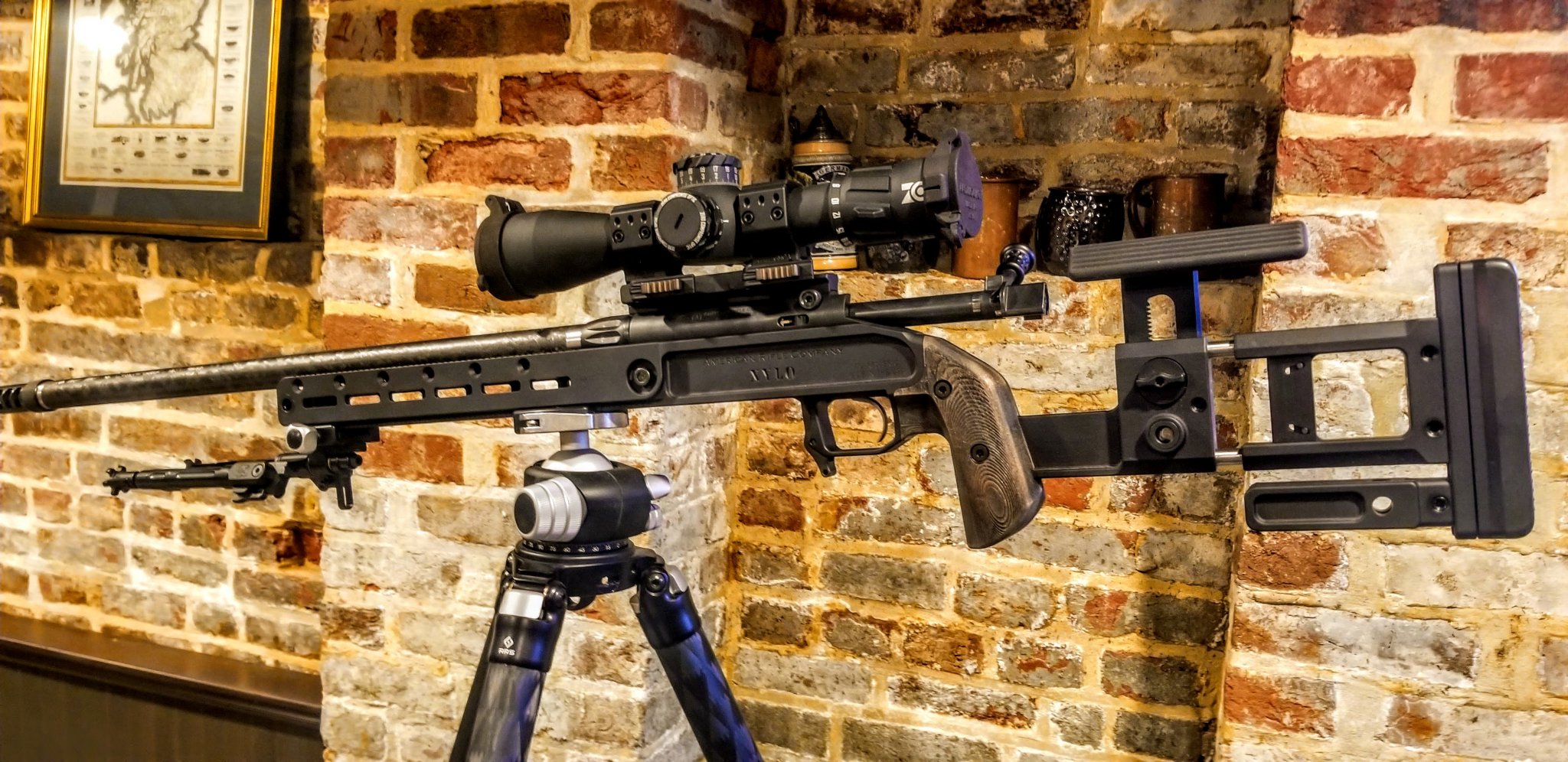

That looks like a Gen 1 Mausingfield. I don't see a ton of them. I also have a real early one, and while I like all of my MFs, the first one (mid two digit s/n) is amazing.
Reactions: Ledzep
Yeah, S/N 29. If I recall it's the first of the first "production run" of them. 1-28 were internal testing and sent out to shooters/builders to give initial feedback. Quickly approaching 10k live rounds on it. Incredibly slick now-- not that it was ever a slouch.
Are those the 1.36" height QD-L rings? How do you like them?
Yeah, on their website it's 1.38" M-10 QD-L mount. I like it a lot. Return to zero has been well within .1 mil for me going hand-tight with the mounting screws/knobs; I use it to swap between a .300 PRC ELR rig and this rifle until I get another AMG. POI is repeatable enough I can use 4DoF zero angle to not have to re-zero the scope between swaps (zeroed on the one that hits higher).

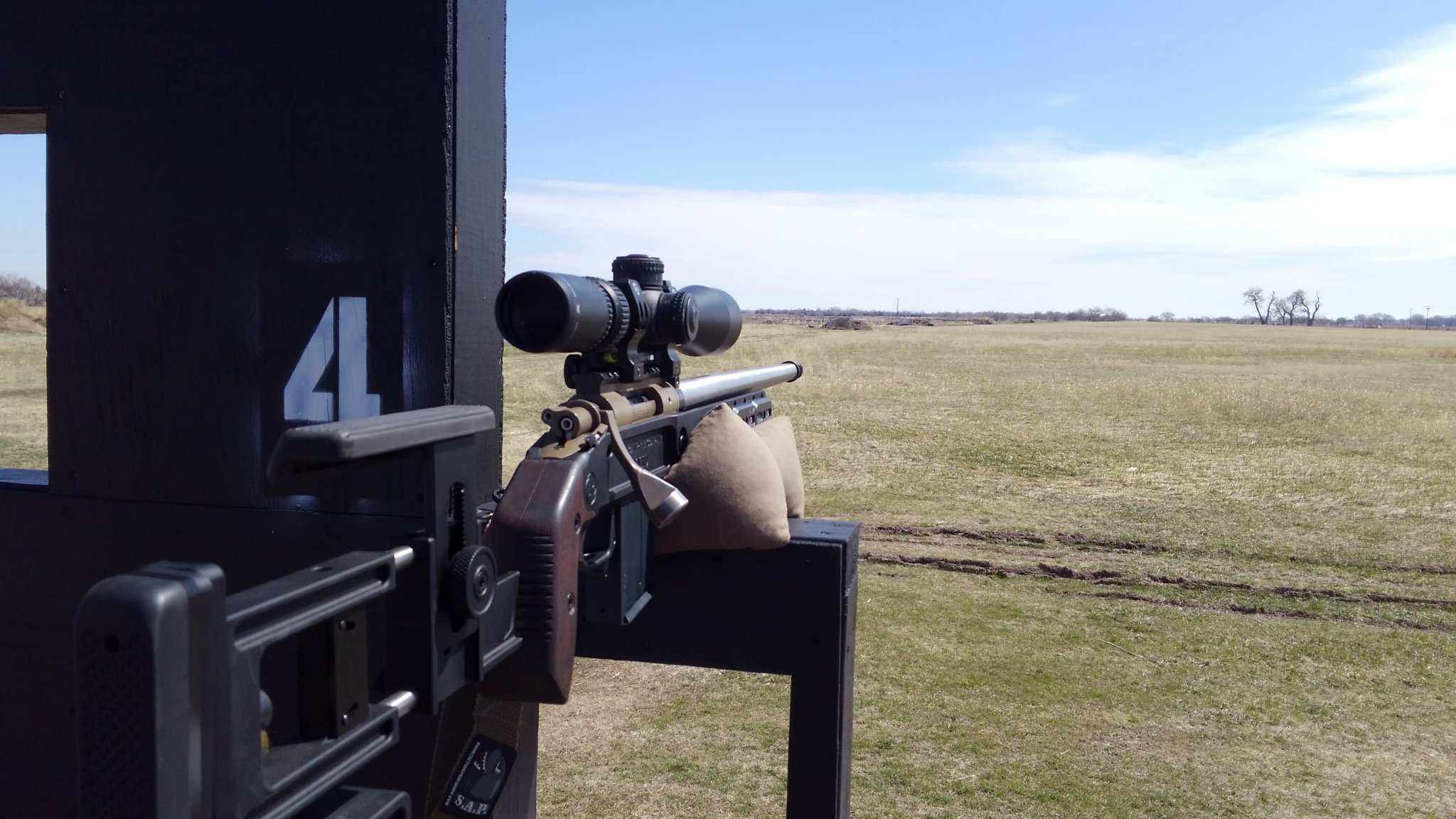

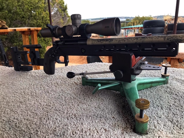

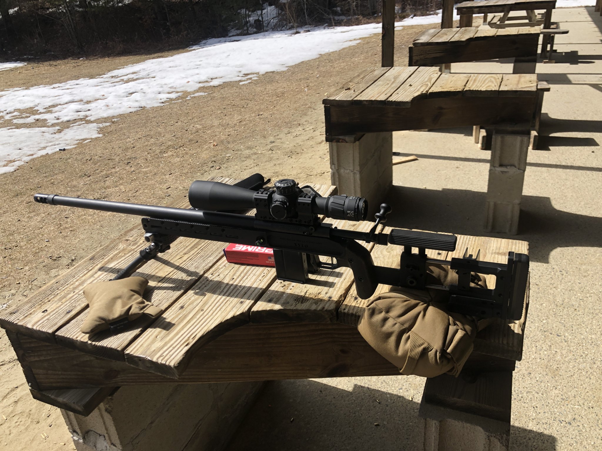

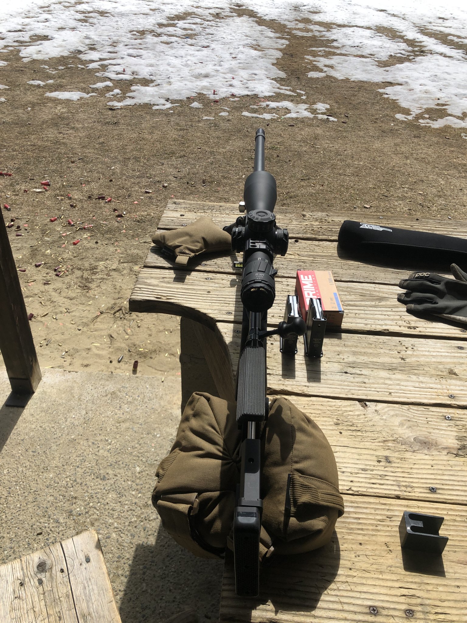

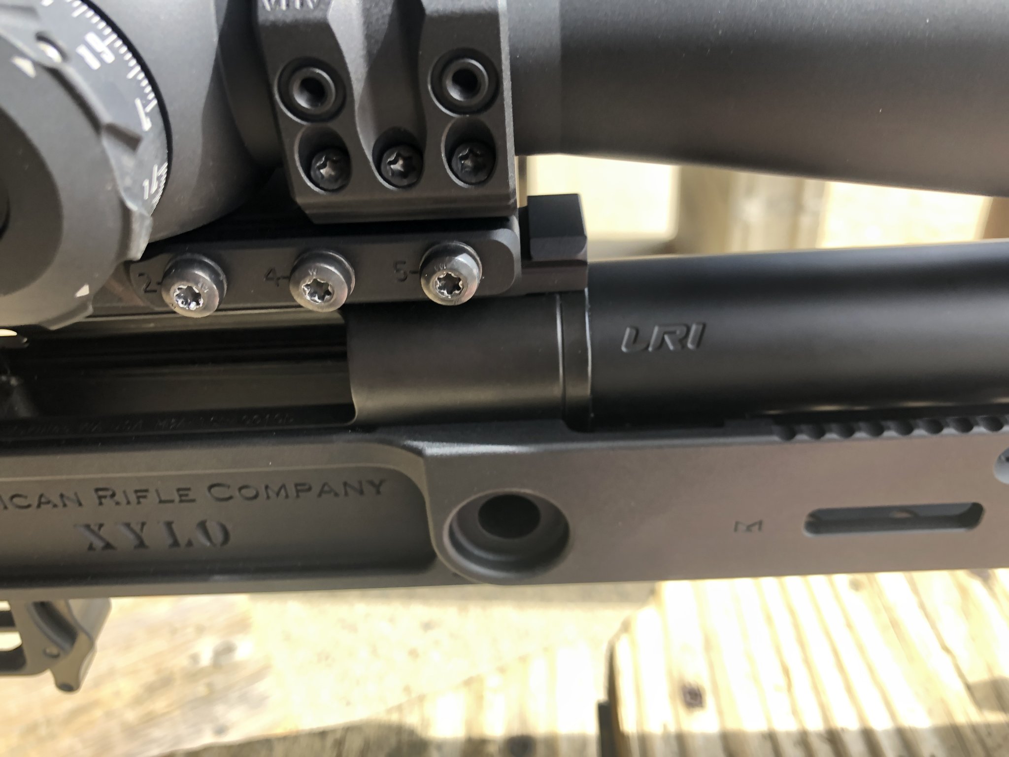

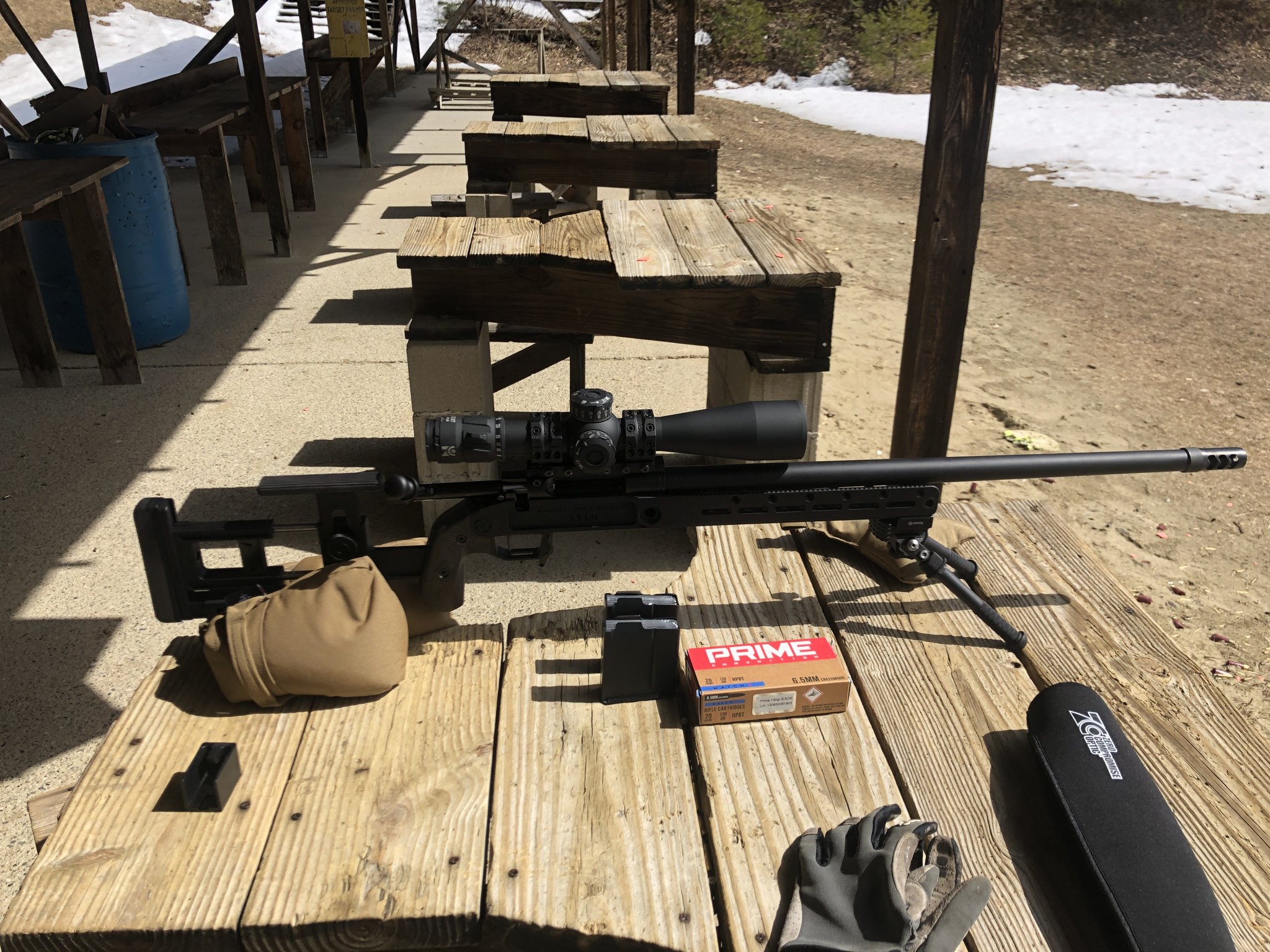

Got out this morning and ran some rounds though my Archimedes with the Xylo installed. I shot a group in the Foundation first and then swapped and tightened down the recoil lug wedge lock system as well as the action screws (obviously). Point of impact shifted up about 1.5" at a 100 yards between the two but was the same for windage.
Overall I think the chassis is amazingly well thought out. I like all of the features and improvements since the ShotShow version. I only used the Accurate 223 mags at the range today, but last night I bolted in a Mausingfield and ran about 100 6BR dummy rounds through it using the MDT 6BR mags. I had no issues with the bolt touching the mag lips and both actions fed perfectly the entire time.
My only regret is changing my cart at check out back to only one stock during the pre-order. I'm wishing I had another one already.
Sorry for the crap pictures, but I only brought my cell phone to the range this morning.

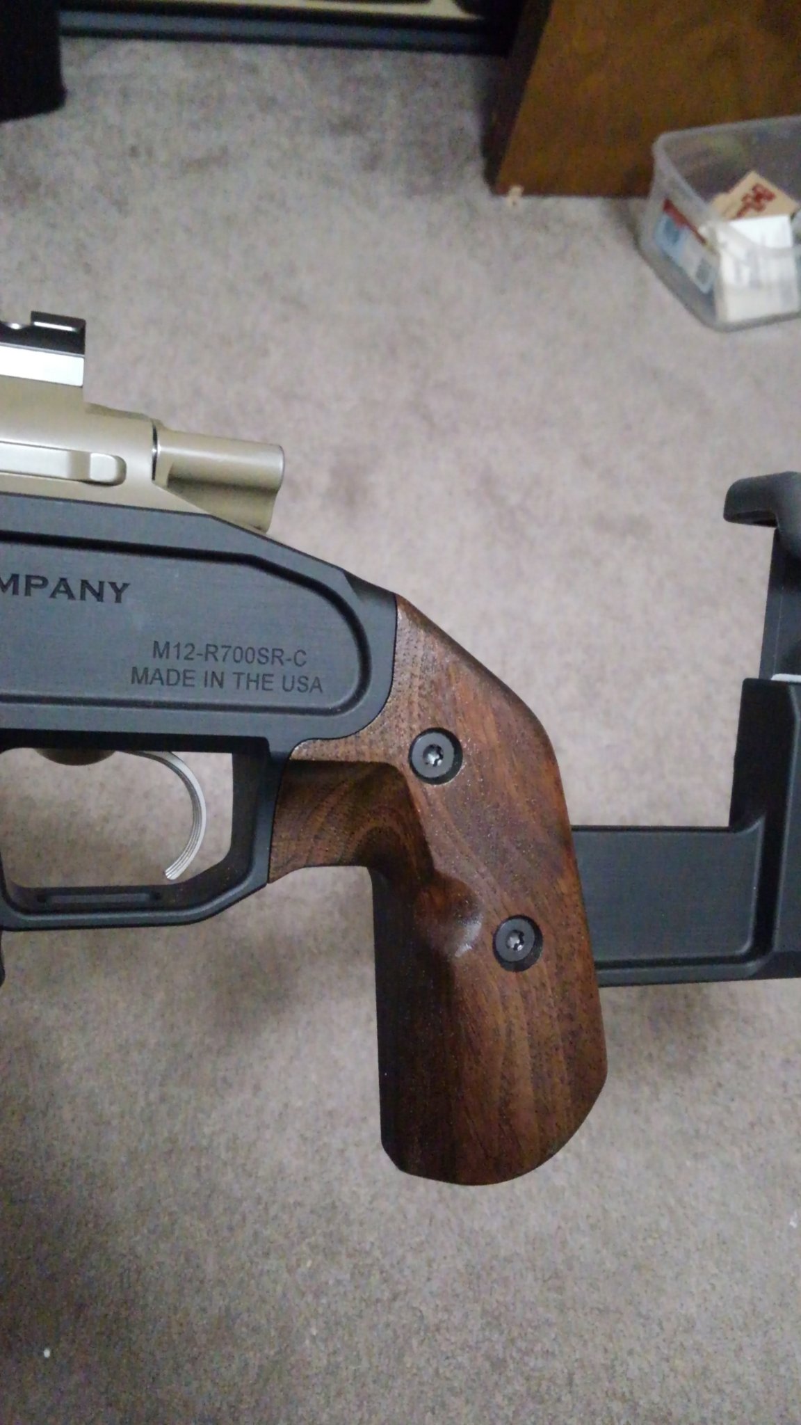

If I order a trigger tech special and it has a bolt release will it matter? I have a mausingfield action. I don’t see many without in stock and I guess if I use it for something else I might need it...
View attachment 7267392View attachment 7267393
You can remove the bolt release easily, so no issue.

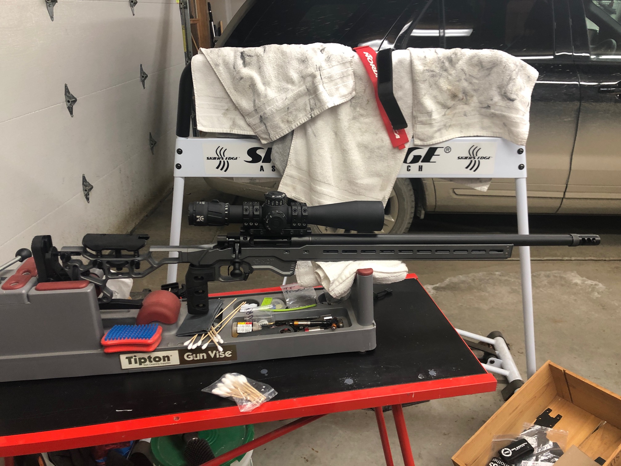

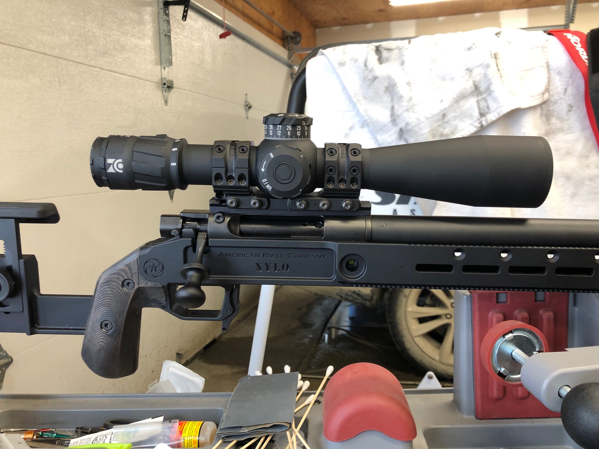

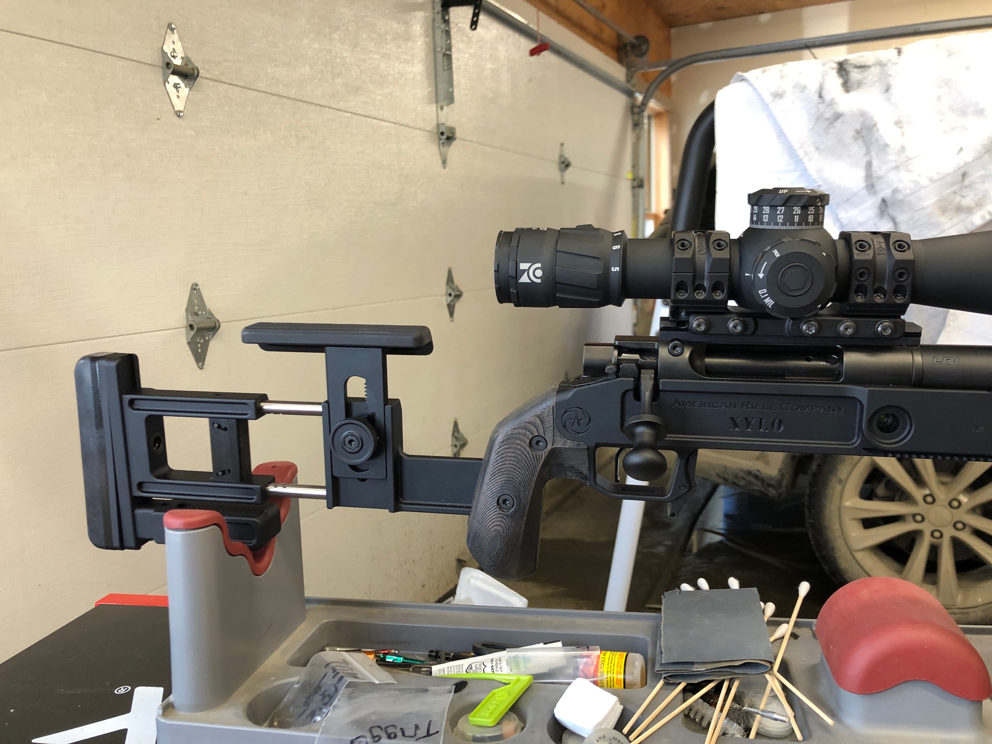

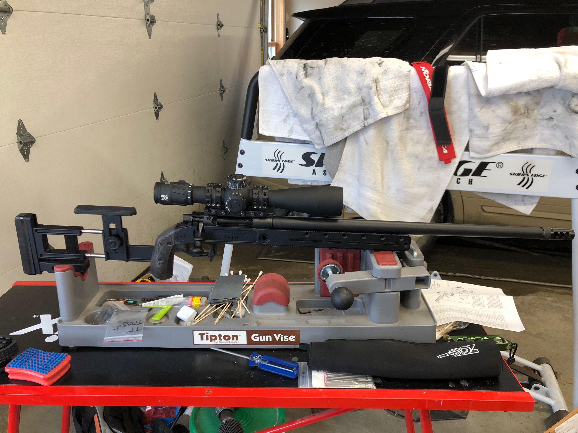

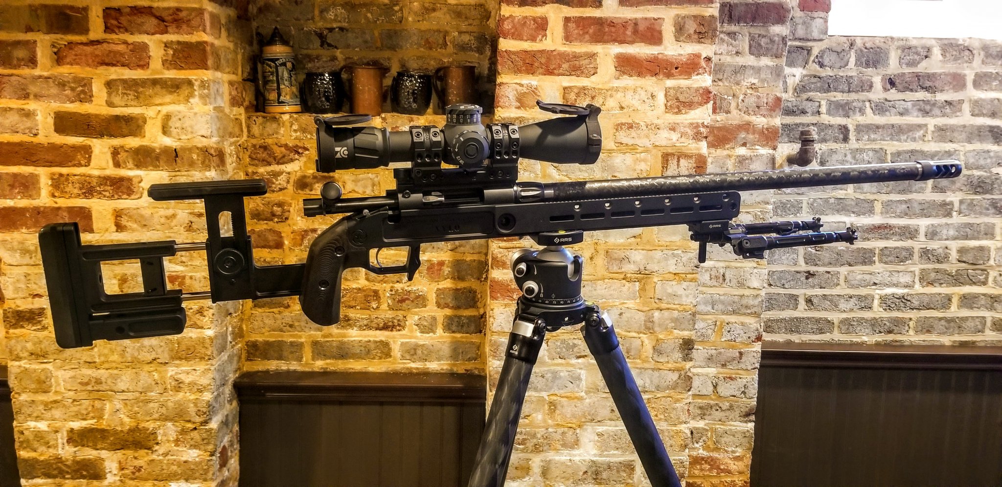

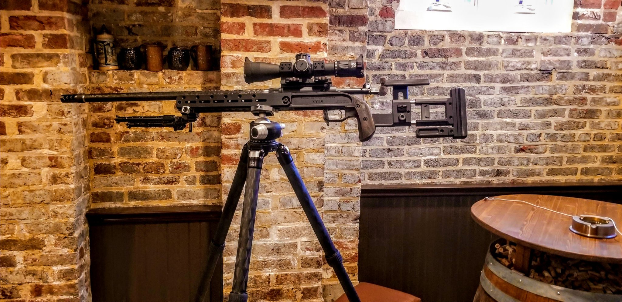

I got my rifle put together yesterday. Archimedes action, LRI spun up a 6.5 Creedmore barrel ceracoted to match the color of the action, and a Zero comp 5-27. The lug lock system is genius, once bolted up this probably the most rigid chassis or stock I've ever owned. The fit and finish is out standing. With the M24 barrel profile it balances 3-4" on front of the mag well. The bump on the mag release holds the mag tight, and you can rest the rifle on the magwell, and it cycles with no rubbing. Had my doubts about the grips, but feels great in hand. Going to zero today if my range is open. Starting to think @karagias is some kind of mad genius. Sorry for the messy garage, kind of in between seasons here.
Great looking rigs guys! Could somebody please measure the distance from the front of the magwell to the tip of the fore-end for me? Thank you!
Bear in mind this is from pixel scaling in Ms paint so it could be wrong but it said the MDT hole spacing was just a little narrower than the Xylo's holes.
I figured that was the case. ARC has talked about internal forend weights but nothing on their site about it.
