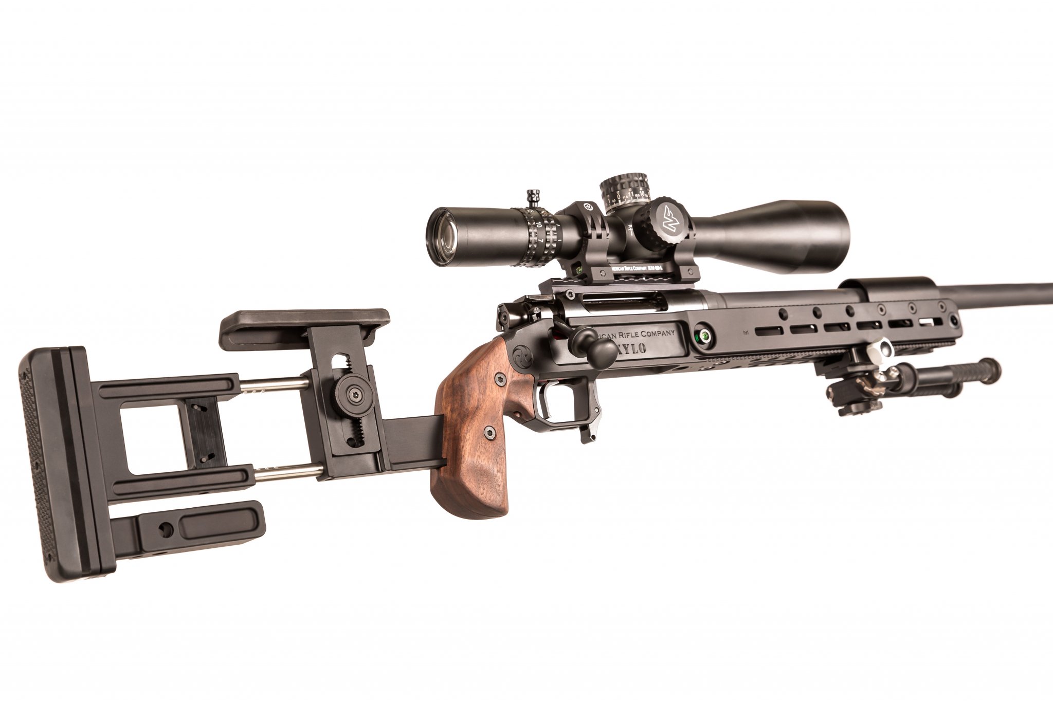

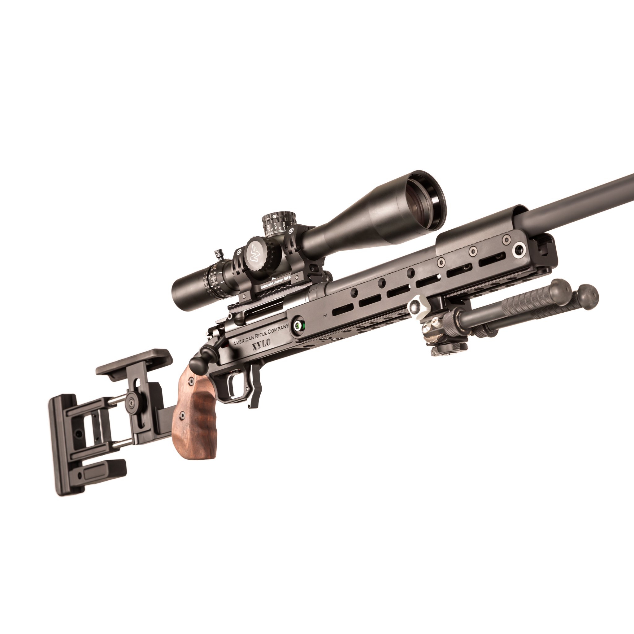

That grip is looking good!
What's the EFR type thing up front on the stock?

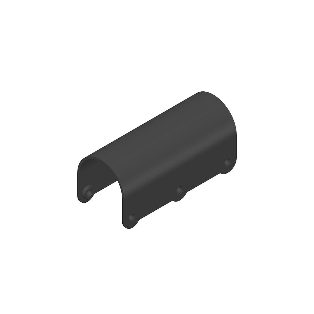

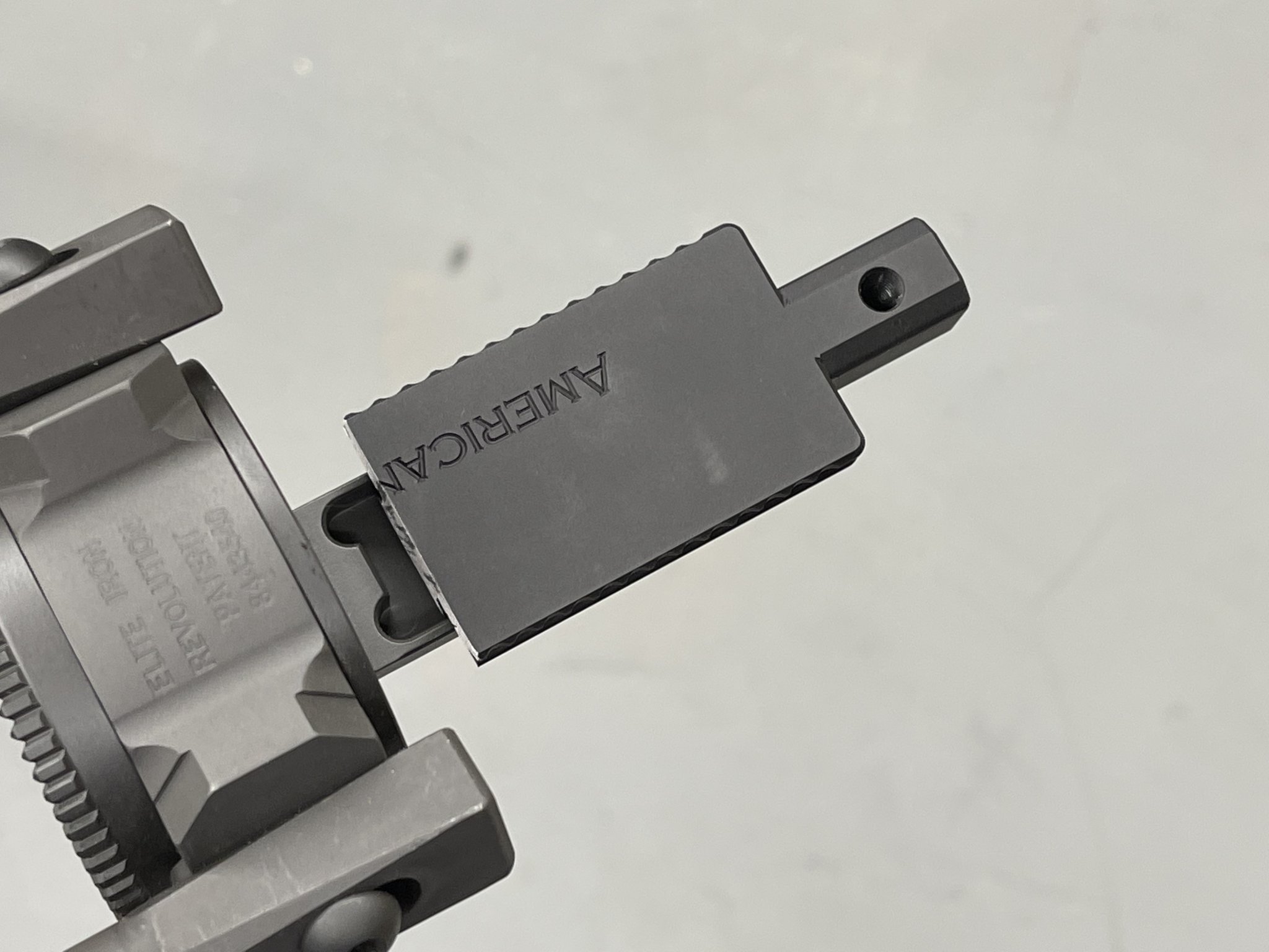

Steel bag riders are now available on the website. In stock and ready to ship!How about it, @karagias? Any prospects for commoners to be able to order the steel bag riders? Unfortunately both my barrels for the Xylo rifle are 30" and the current setup is pretty front heavy.

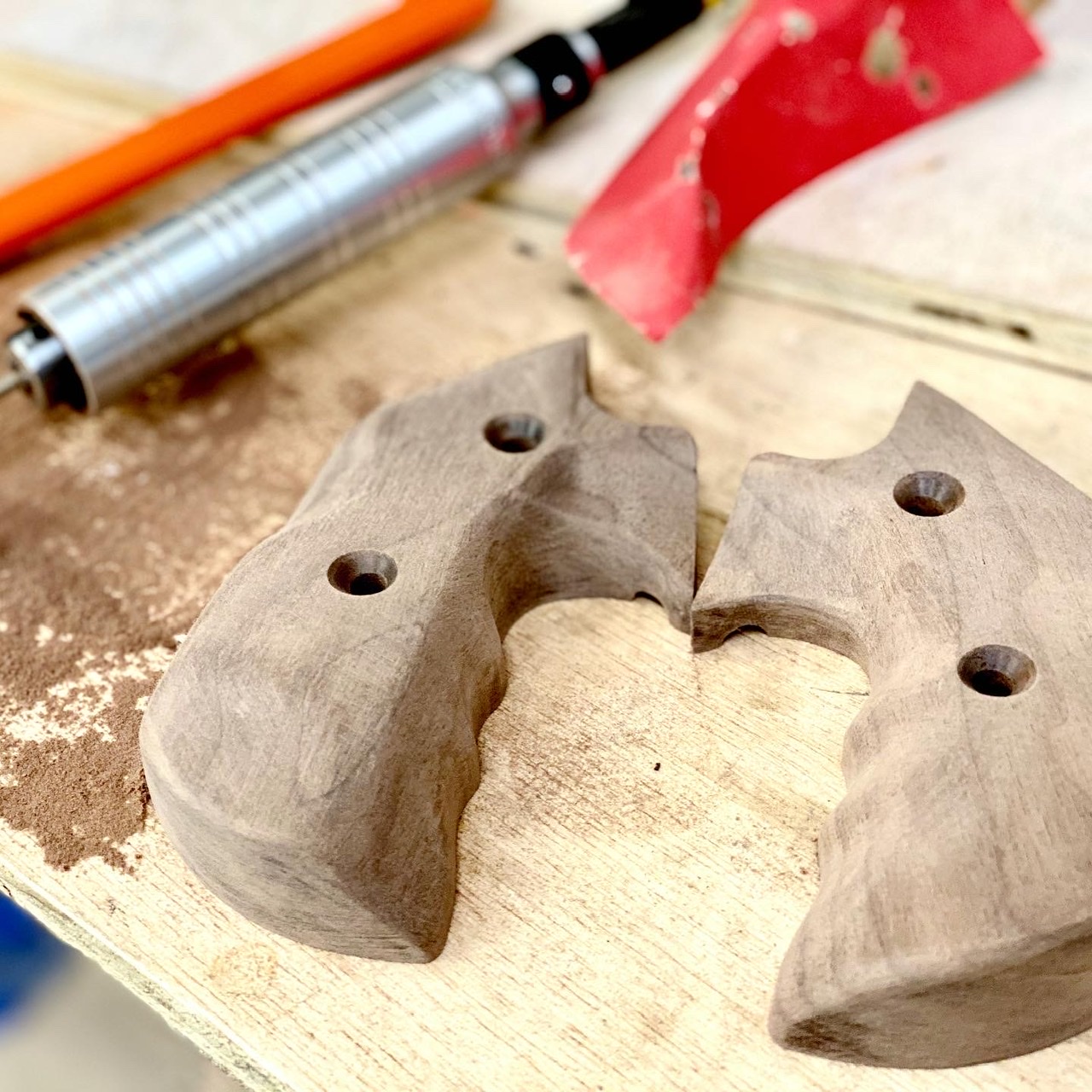

I fitted the grip using a rotary flex shaft and a sanding bit and finished with Tung Oil, no stain.
That looks way more comfortable then the stock blocky grips lol
Yeah, it's a really great fit now. I debated whether to get really aggressive on fitting it perfectly vs. generally and chose to stay conservative since others will shoot my rifle as well. It looks sharp now.
One of my favorite things that I did was create a shallow depression for my thumb to fit into on the back of the grip. It's a consistent indexing point for me.
Xylo Steel Rear Bag Rider
www.americanrifle.com
Cheers
And mine is installed now, looks great, fits my giant rear bag perfectly. Excellent.Steel bag riders are now available on the website. In stock and ready to ship!
Cheers
