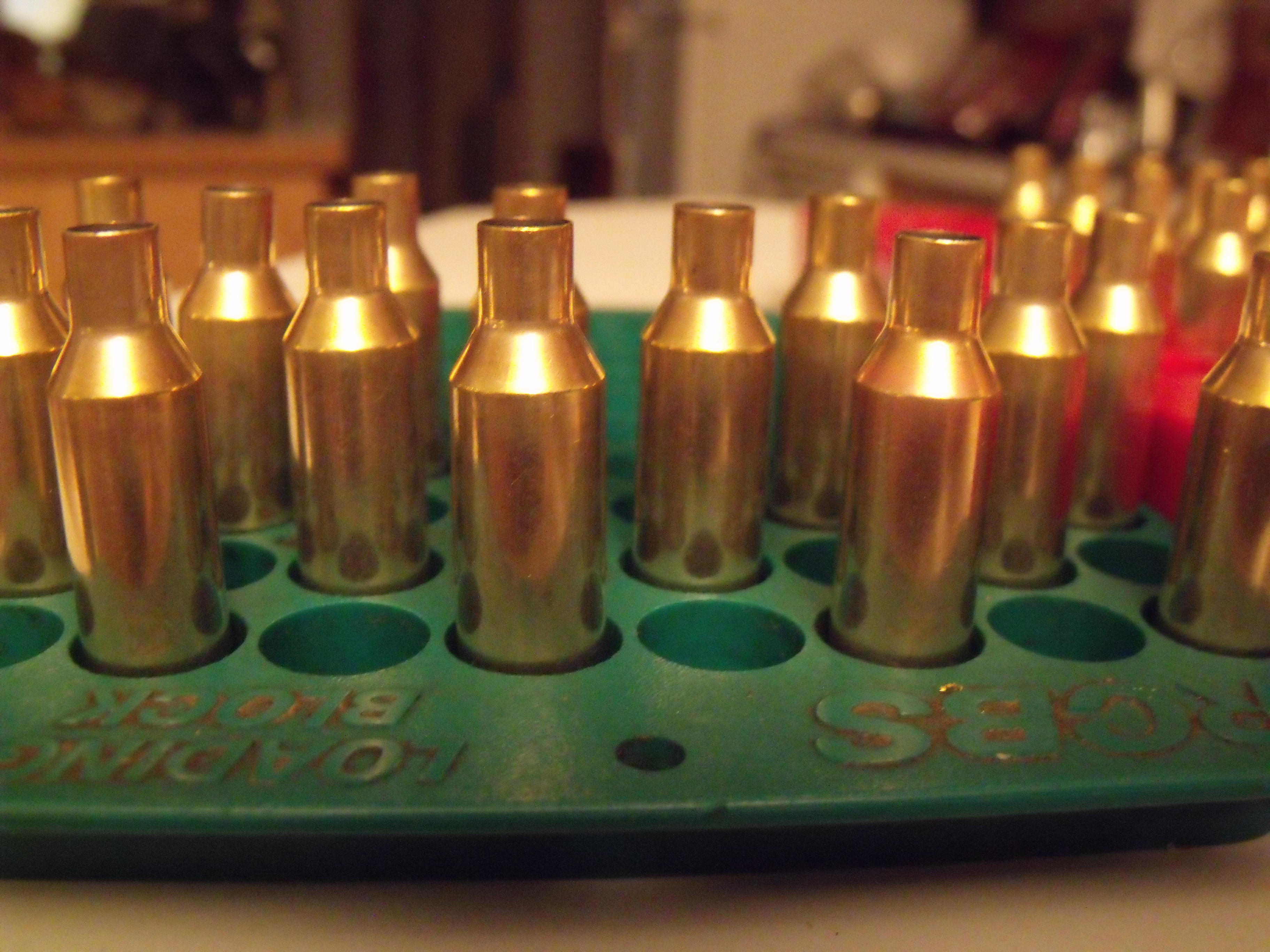

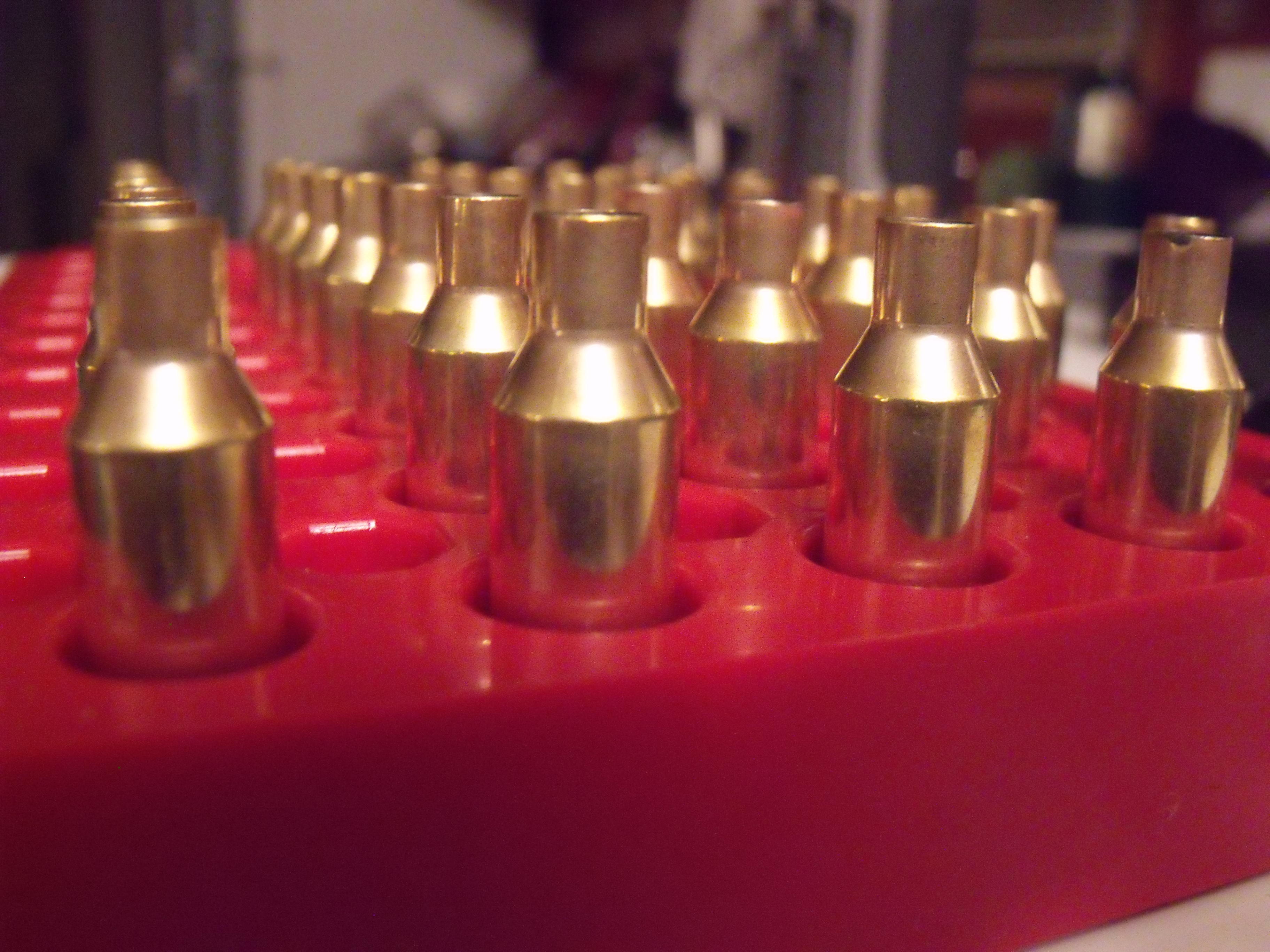

So i received my new benchsource annealer and i have started to anneal my brass and i seem to have a problem telling if its good or not. I have the 750 templaq running two torches with the case about 1/2"-3/4" from pencil tip of blue flame(mid neck)(6xc norma), with a cycle time of 3.25 sec (red tray image) 3.75 sec (green tray image). The templaq is turning clear right before it leaves but i am not seeing hardly any discoloration of the case. Now i know it varies from manufacturer to manufacture and i have read people say it may show very little change, yet every image i look at its obvious the discoloration (annealed not new brass). I have also watched a few videos on youtube mainly the benchsource video by accurate shooter and it shows the brass giving off an orange flame right before/as leaving which i thought was bad. The more i read and watch the more i realize how many different opinions there are. Any help would be appreciated.

case color and depth color mean nothing. Trust in your templaq it is as close as you need to be. Get the room as dark as you can, you should see the neck "just start" to glow right as it leaves the flame. NOT GLOWING but just starting to change color. Good luck.

I have been relatively successful following the above advice, and I concur with diego-ted that you should see a light light light brick red, in a dark room, just as it leaves the flame. The brick red I look for is "faint" and almost immediately gone as I come "out" of the flame. It is not that hard to accomplish this setting.
