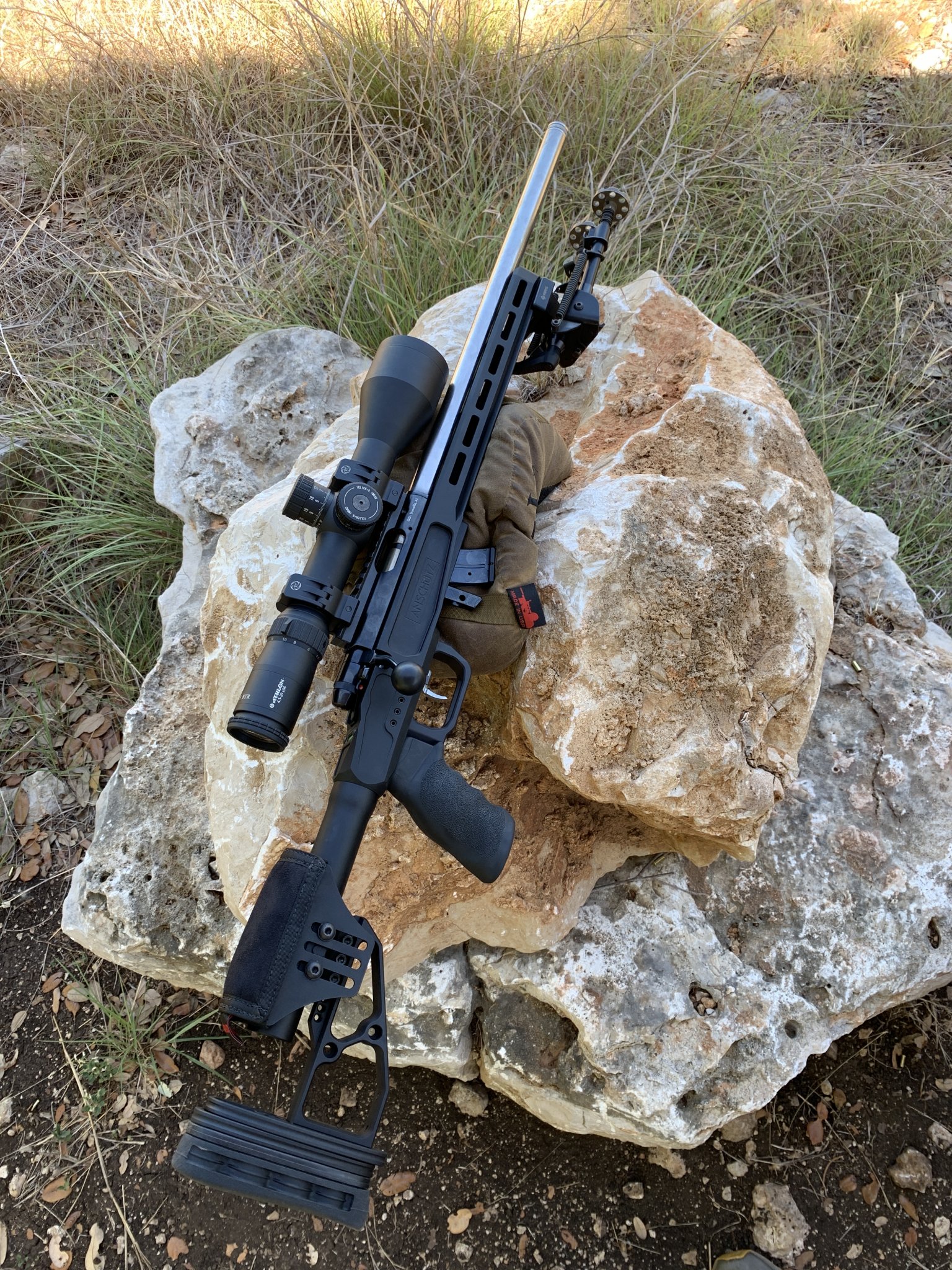

Well dip took a month and a half and still no 25moa scope rail so I cancelled that order and had Murphy precision send me a 30moa one in under a week.
Seems to prefer eley club to lapua so far at 100 yards. I’ll actually lot test it once I get a few rounds through it.
It’s butt heavy and balances right for offhand but it’s a bit awkward balanced on a tatertot, it’ll rock right back off the bag unattended. Maybe once the dead air mask gets released from jail it’ll even out a smidge. If not I can always load it up with mlock weights for prs stuff.
