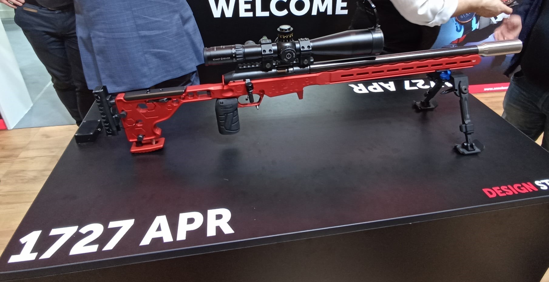

The chassis systems have landed as of now at ANA. 2 of us are in Germany so it’s the office manager and 2 sales guys there. They are working as fast as they can to get all the preorders out.
For all of you European guys, the gun will be displayed at IWA and I highly encourage you to email the sales email at the German factory. They are going to catalog it and any and all encouragement from EU consumers and dealers will make them move faster.

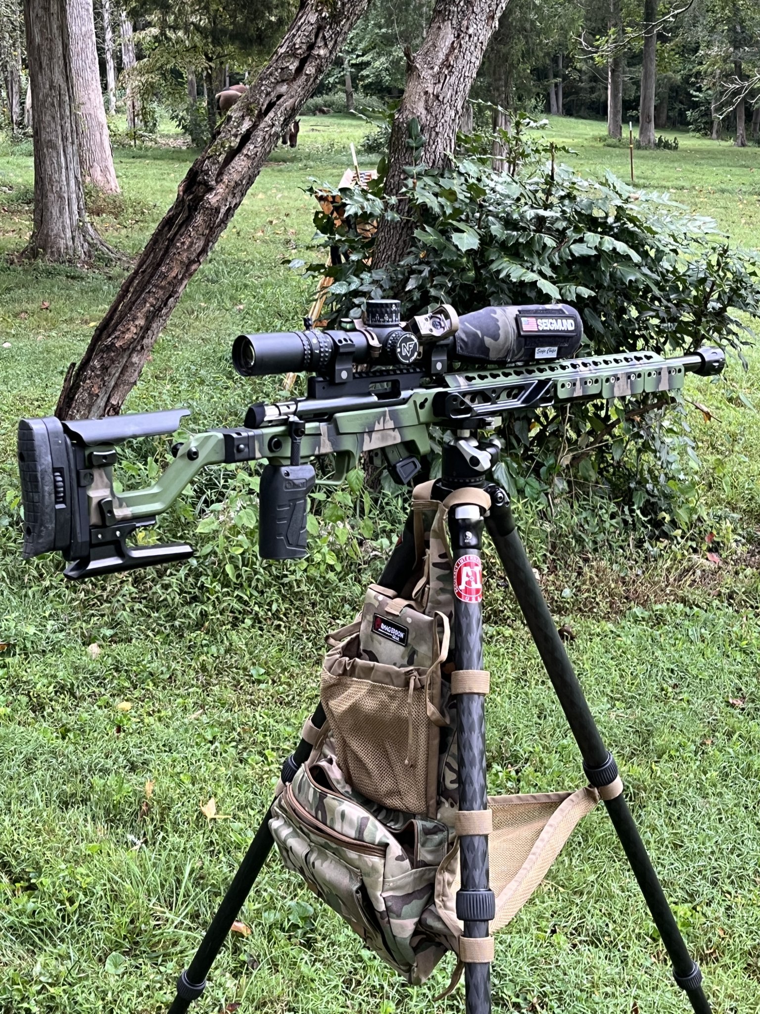

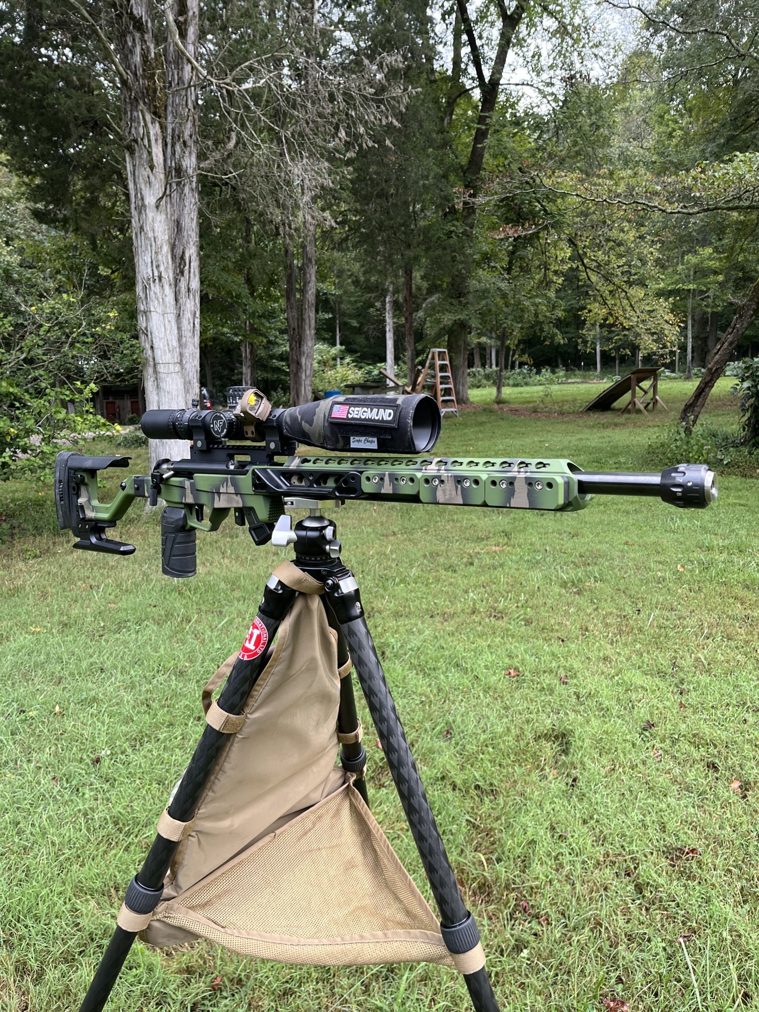

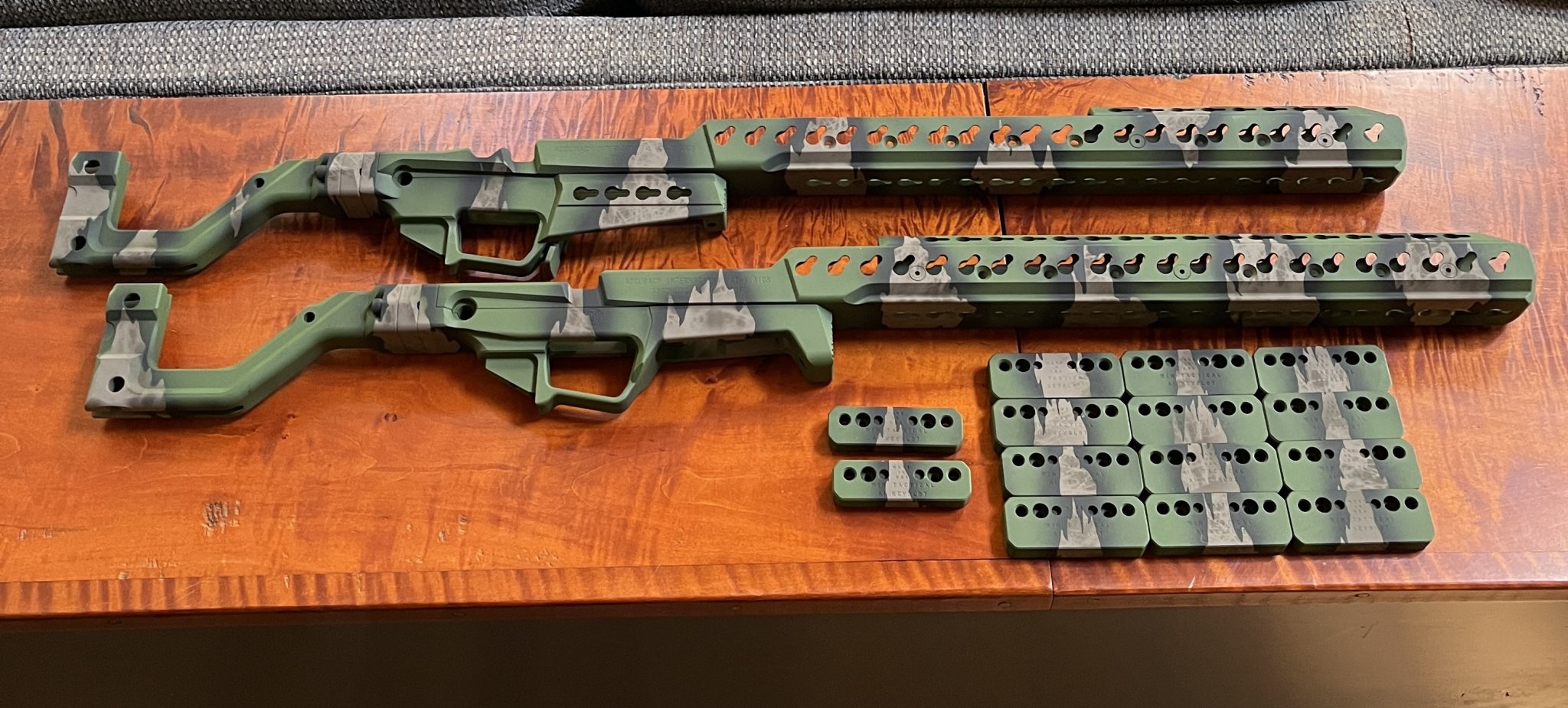

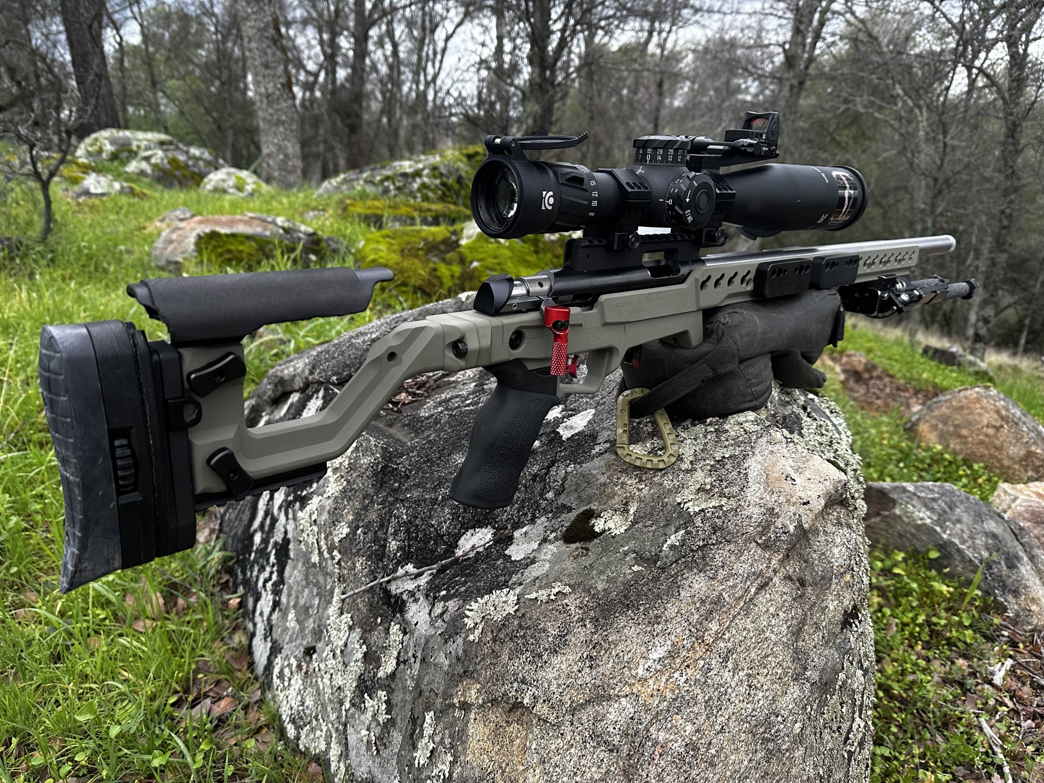

Had West Michigan Cerakote paint up these Accuracy International AICS and some weights. Top is my AT-X AICS for my RimX, ignore. The 1727F needed some camo to really fit in around here :ROFLMAO:
View attachment 8496388View attachment 8496389View attachment 8496390

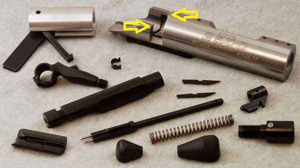

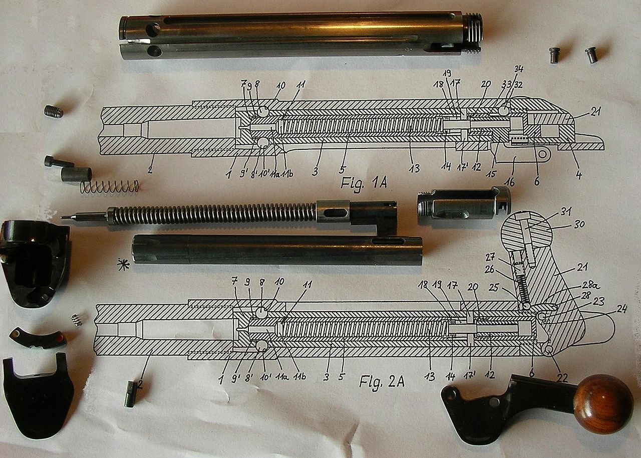

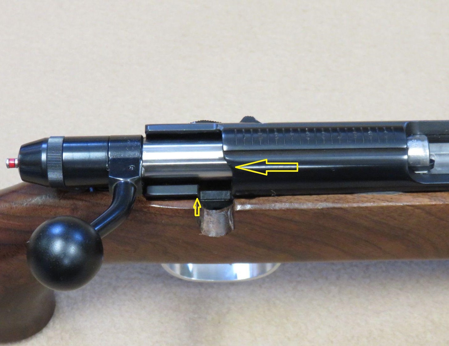

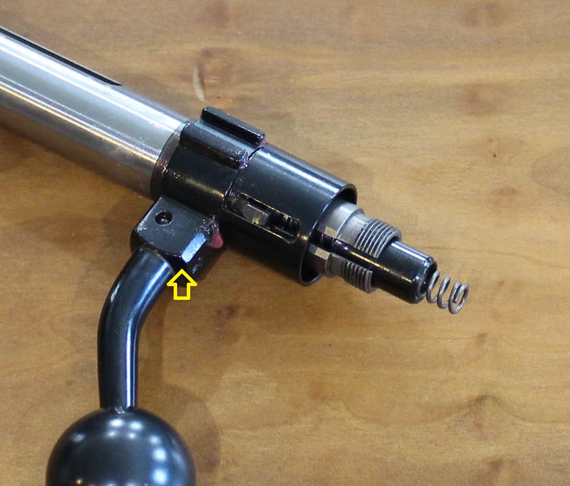

Its down to market size , Fortner builds what 400-500 actions per year for Anschutz, Ball lockup patents are long expired and there are a bunch of centerfires using them. Having worked on a design of an action or two , i do not see these as overly complex to do. I just do not see them as top choice for precision action, lacking both extraction and locking cam in reciever itself ,this is where it gets complicated more so in centerfires as you design a cam inside the bolt , with rimfires you are still just straight line pushing it but particularly now as we are getting more bullet engraving than in the past.
0df50b1e-284e-47ac-8350-94be91ac5de1-jpeg.28554
That is not the current Fourtner action. But I am not sure what you mean by they "lacking both extraction and locking cam". The bolt extracts cases with ease. The bolt contains a cam that moves the sleeve allowing the balls to sink into the bolt to unlock the action and then as the bolt is moved forward it hits the bolt face and the cam forces the sleeve forward moving the balls into the extended position to mate with the recesses in the action locking the bolt. It is a fast and excellent action, just pricey and lacks things other action have. There have been several 1827F non-repeater actions made into BR rifles and they can produce excellent scores. They just don't beat the top actions enough to get top shooters to try them and to overcome the cost, availability and proven success of the more common custom actions. This means that the market is going to be very limited and force the Return on Investment calculations to become extremely unfavorable.
No that is not a extraction and locking cam like in typical rotating bolt action , even on rimfires but much more prominent on centerfires , these ramps give you leverage closing and opening .
What you are mentioning is internal lock to lock the balls in place so you do not get bolt thrown in your face ,from my limited time with fortner it relies on inertia for primary extraction and umph for closing
Centerfire ball locking actions thus utilise a cam on the handle , kinda like Archimedes action to aid primary extraction
Primary extraction cam is part of a the bolt handle machanism.
I recognize that you do not understand some of these terms or cannot see how they are accomplished in another action type. That what I meant when I said " re-thinking the concept". There are multiple ways to satisfy each and every requirement, some work, some don't. often the test is the use case. In a BR use case there are reasons that the traditional bolt rifle action fills the need better. In the olympic positional sports the Anschutz/Walther/Bleiker/G&E rifles rule. In Biathlon the Fourtner Rules and in PRS/NRL the 22LR R700 clones rule. Our use of the AI/Fourtner guns can play as well but I have outlined the reasons they are not going to ever dominate, but there is no reason they cannot compete because they do have all the needed pre-requisites.
