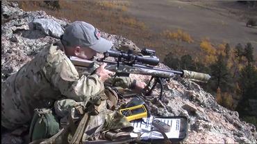

This is Wade S, the winner of the SHC in Douglas... targets beyond 1000 yards, and many alternate positions.
Shooting in the mountains is the biggest load of horseshit out there regarding levels... If you want to go back to the East Coast and something like ASC, I shot that several years since the beginning and nobody was using a level, not a single shooter, and hitting.
You focus on the Reticle, not the terrain around you. You don't focus on the target and whether or not it is straight... I can careless if the target is straight. The rifle if set up correctly in your shoulder pocket cannot be anything but level. If it is not, you feel it, as well as see it. This is Day One common sense.
Guys above who said they noticed the rifle being canted after using a level, well that is called a Clue... adjust the rifle.

As if you guys have never adjusted your bipod to get you "close to level" and then used the cant feature built in the bipod to adjust with...
Hmm, must never have thought of that... adjusting the bipod.
Look he is leveling the shot without using a level... voodoo, magic, or what ?
It's hard to see, but the other images of the Online Training Angle Lesson, you can see I have one leg 3 notches out and the other is closed.
Mountains of Korea, no levels ever used.
Clearly there is more ways to skin a cat, if the level says you need to level it, what do you do to level it, well I do the same exact thing but I can feel it is off.
Legs uneven
Posted on FB today... they get it, you adjust the bipod.
I mean really, it's so obvious I find it hard to believe someone would be like, "Hmmm what happens if the ground is uneven"
