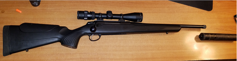

Tikka T3X lite 6.5 creedmoor chopped and threaded 1/2'' at 16" going to chrono tommorow. Robbed cheek riser and pistol grip off of T3X ctr stock.
