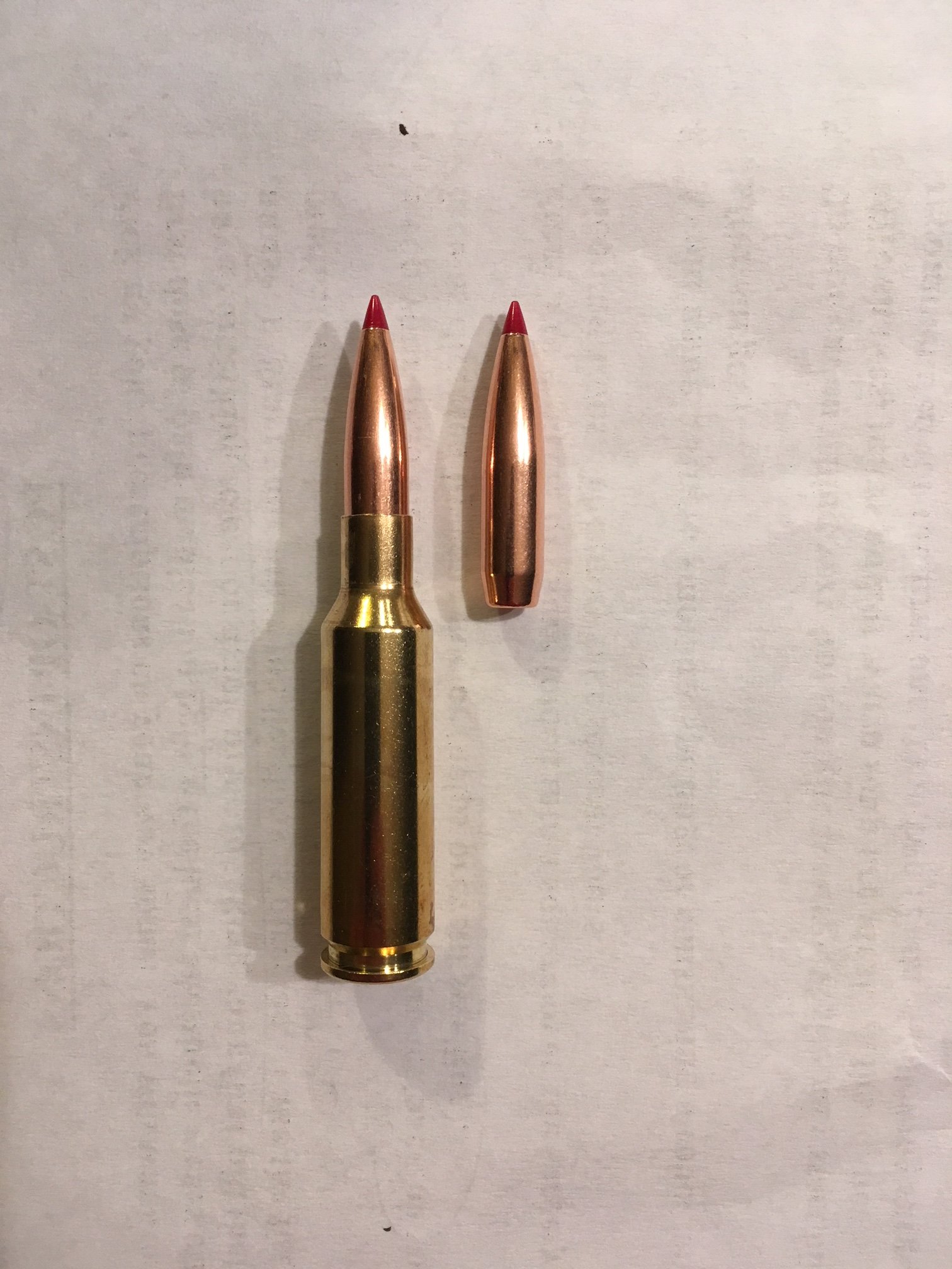

Congratulations on your tremendous rifle set up ! What is your overall seating length on the 123s ?
I'm not sure what it is without the comparator.
3.128" is base to Ogive, 10 thou off the lands.

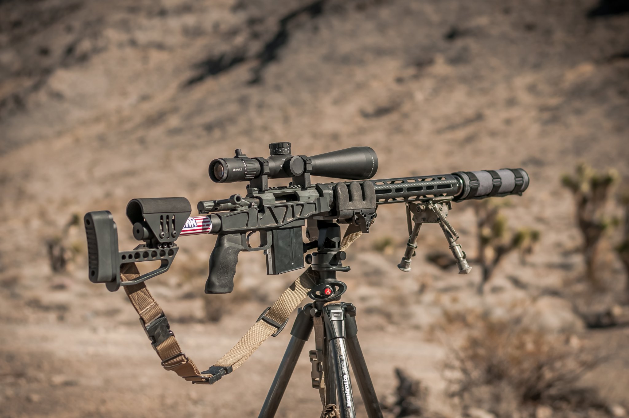

My DMR shorty 6.5 CM V4.0
Bartlein 5R med Palma at 18” with KG Made Rogue 30 suppressor
Just brake/mount
With suppressor attached
18” is longer than I typically go. I usually run them at 16.5” but this time I had a long hand guard to contend with. I very happy how it came out and will be putting some factory ammo from Prime, Winchester, Speciality and Gorilla ammo through it.
Weight with the suppressor is 9.6 lbs. I’ll be mounting a Leupold Mark 5 HD to it soon!

Looking good Joe! Impressive weight with the can honestly. Which MK5 did you go with 18x or 25x? Still 123gr Scenars with the 6.5CM?
I haven’t been reloading nearly as much as in the past. I’ve actually just stuck to H4350 and 140 Bergers. That way it’s also the same projectile for my 6.5 SAUM.
My last 16.5” was moving them at 2,660 FPS with a Delta P suppressor attached. I’m expecting to gain some speed with the new set up. I also have my fingers crossed Prime does well so I have a good factory option for the days I can’t put in time behind the reloading bench. I have the 5-25x enroute. I gotta order some 35mm rings, lol.
My Kahles will be a good scope to use for comparisons and I can always bust out the Hensoldt too. I’m excited about the Mark 5 HD and hope this is the start of a new direction for Leupold.
