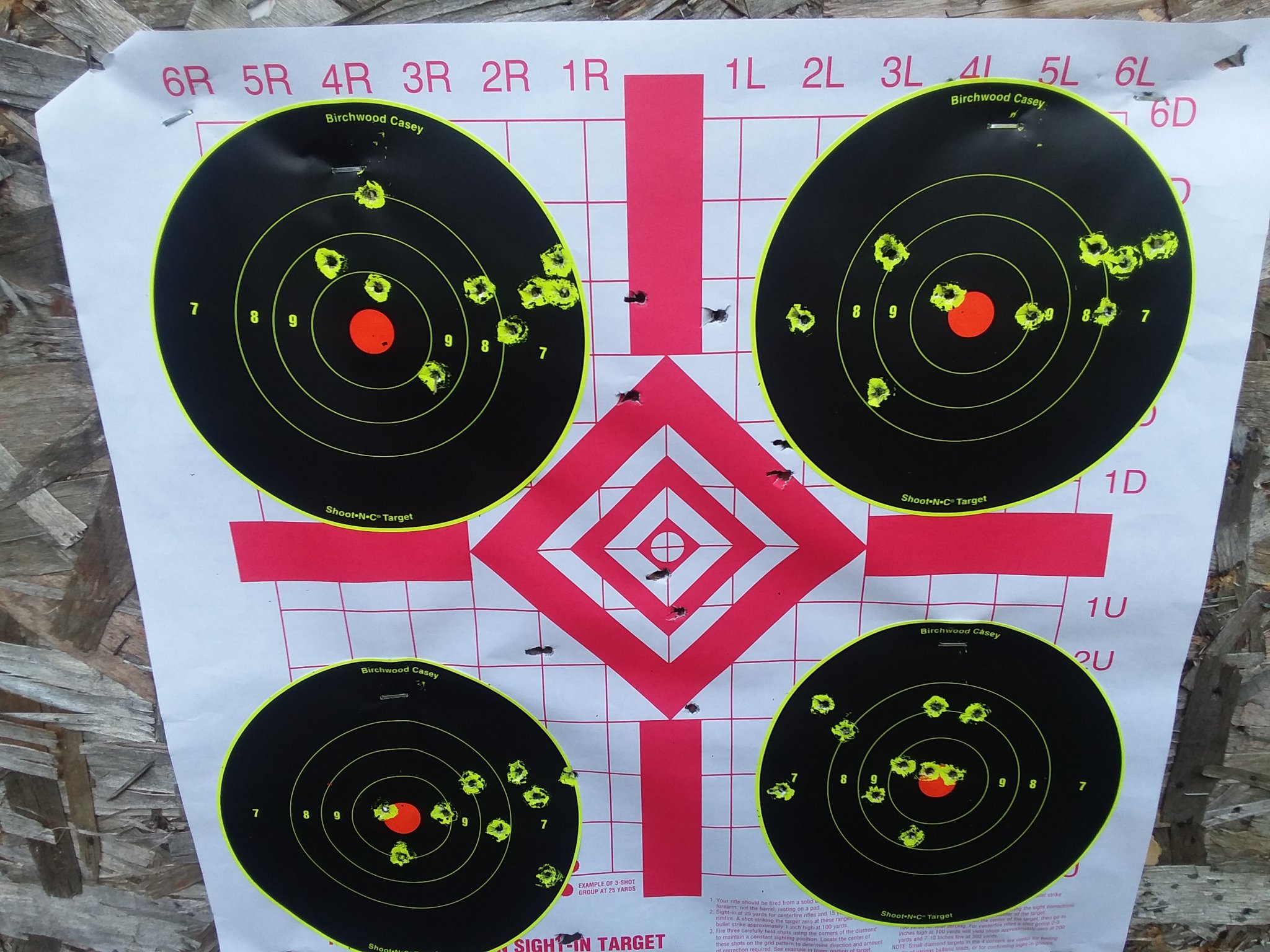

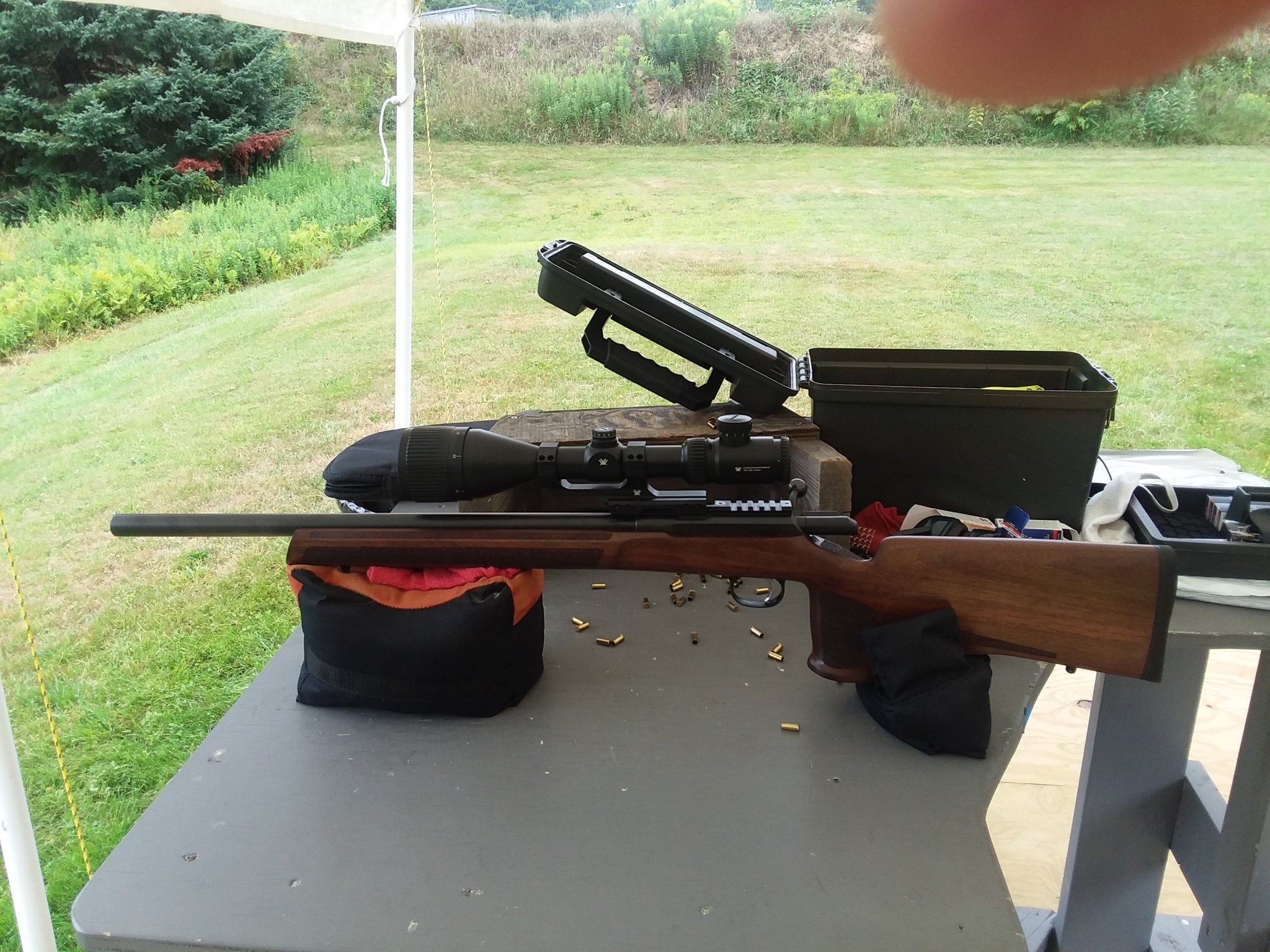

My new CZ MTR 457 22LR, the 6" targets are @ 50 yds sighting it in, 100 yds and 200 yds respectively. I love it. Hopefully it will be less windy next time and I can tighten up the groups. I'm using a Vortex Hog Hunter scope and Eley Practice 100 ammo. I have not adjusted the trigger yet, but like the way it came so far, I'll put a guage on it and see what it will adjust to.

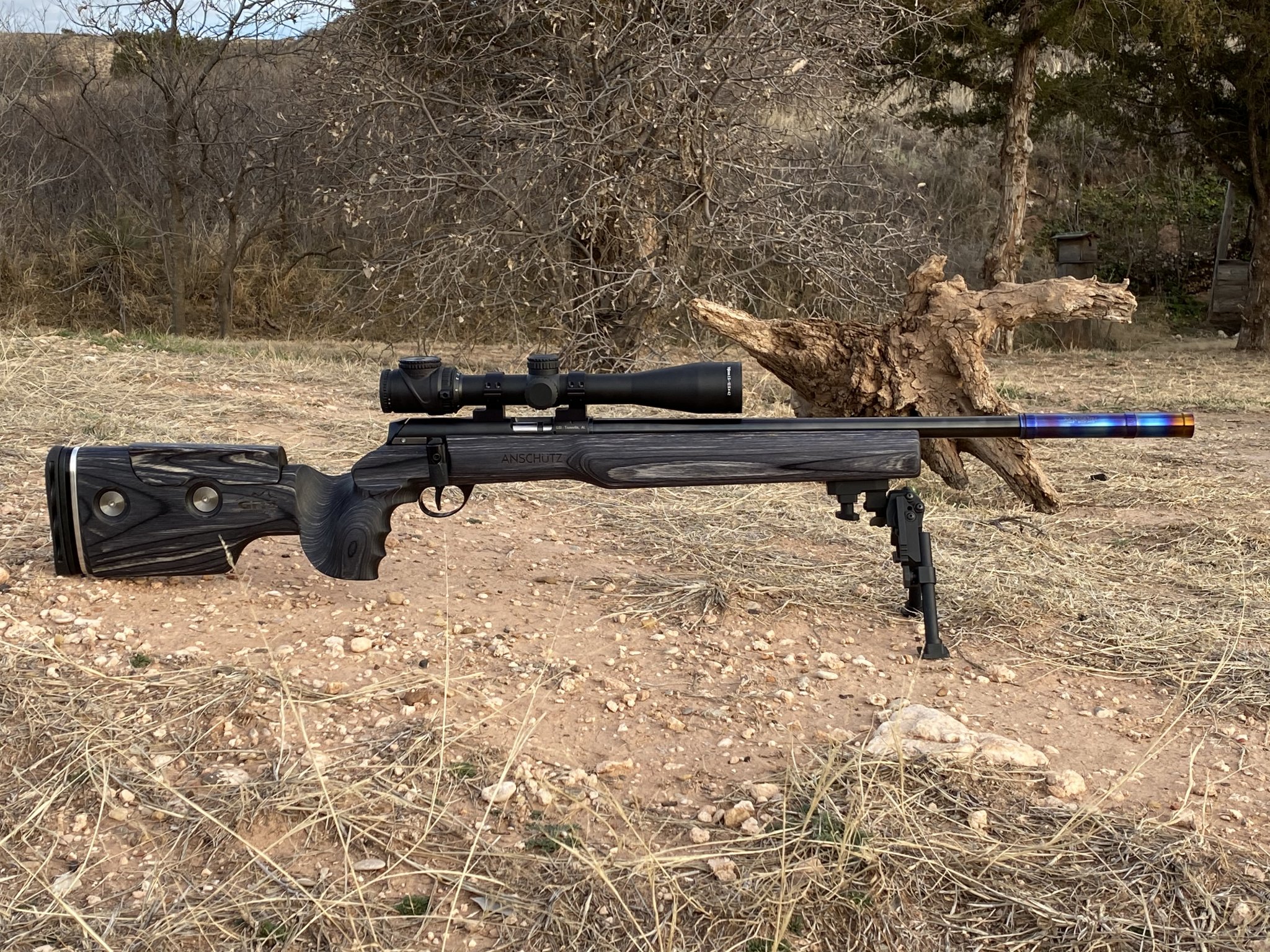

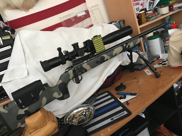

I have a used low round count CZ 455 Varmint already had a DIP Mag Well and Trigger Spring purchase price $330
Glades Tactical Bolt Handle $60
Boyds Pro Varmint Stock $ 150 Shipped ( Home Made Rattle Can Paint Job)
used EGW 20 MOA Rail $25
Pillared and Glass Bedded $8 in Materials
Mueller 8 - 32 Target Dot Scope $235
Vortex Scope Level $25
$833 All in ( Less than a Precision Trainer) and this Rifle Shoots 1/4" at 50 yards all day long

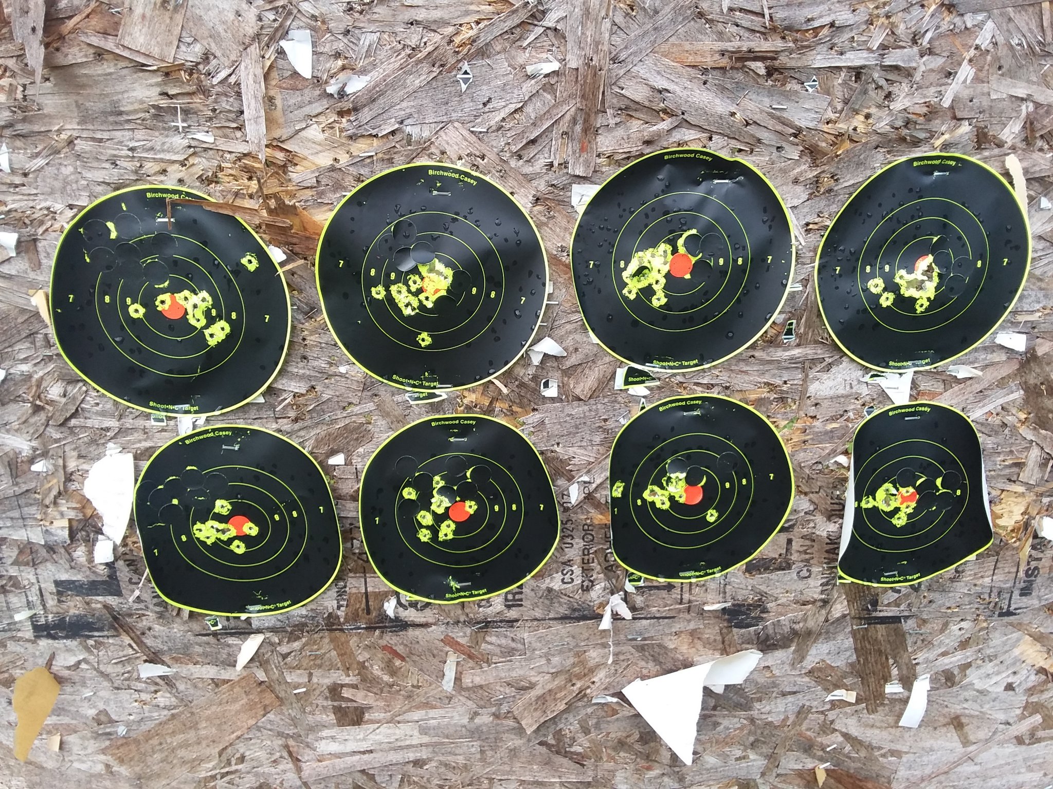

Well the 3 that I have owned have all shot excellent! Here is an example of 2 separate days 50 consecutive rounds each I shot at 100 yards outside off the ground with a Harris bipod and a TAB rear bag, no wind flags were used, and a random lot of Center X (actually a different lot for the 2 days).
