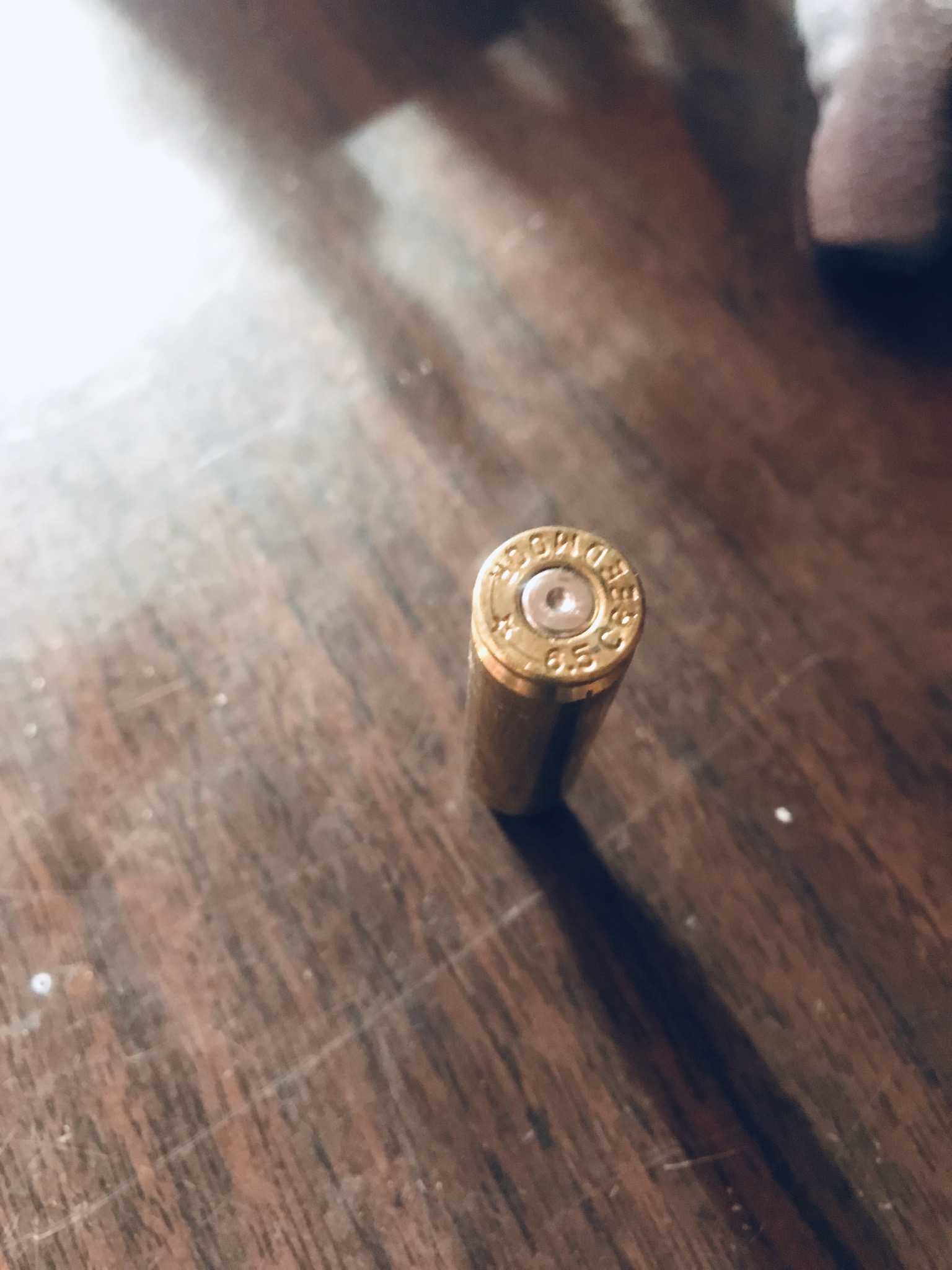

I have purchased a small quantity of both Lapua and Starline brass for my 6.5 CM RPR.
The volume I measured for each case is as follows: Lapua ( 51.5 gr of H2O ), Starline ( 50.6 gr of H2O ). I have only fired a few dozen rounds of reloads so far in the RPR.
