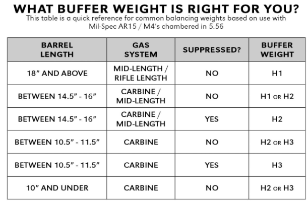

I shoot all of my ar15/10's suppressed. I am running h3 buffers in all to slow it down and most have adjustable gas blocks. Is there any downside to a h3 or any benefit to a lighter buffer if the rifles run fine with an h3 suppress or unsuppressed?
If it works then dont change it. You never mentioned barrel lengths. That is the most important factor to what buffer you 'should' need. H3 is a heavy buffer that is usually best for 14.5 and under barrels when running a suppressor. 14.5 and over the H2 will work just fine suppressed or unsuppressed. Refer to the Geissele chart below. I have found it to be pretty accurate. I also run their buffer's and springs though.

More reciprocating mass equals more recoil. Other than that, if it's running how you like, don't change it.
