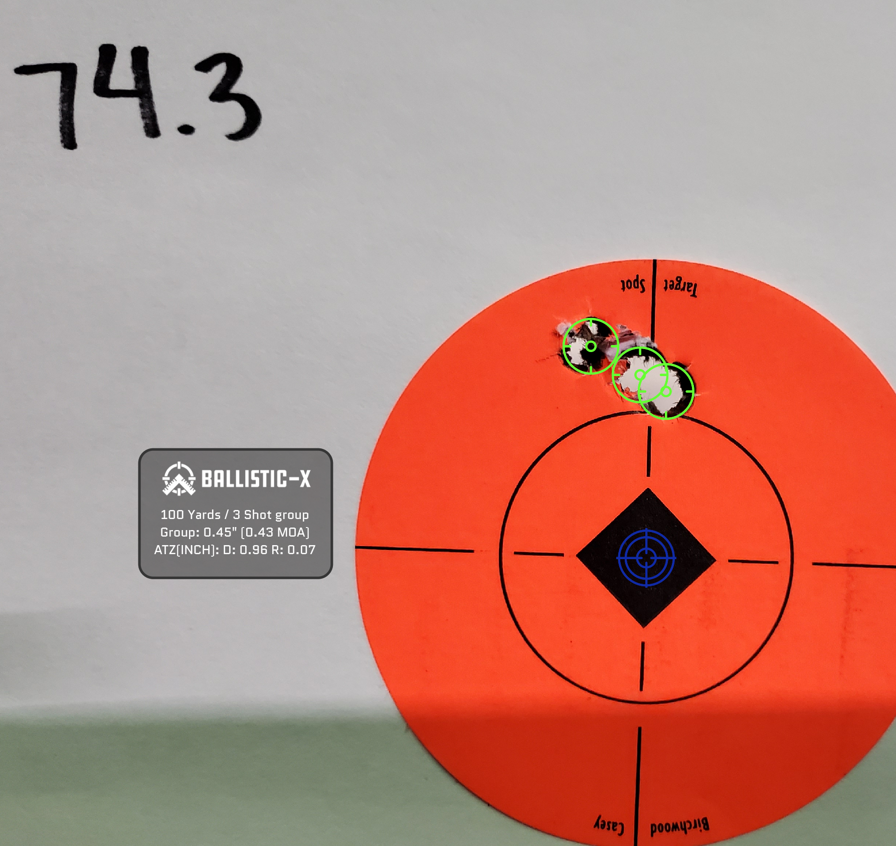

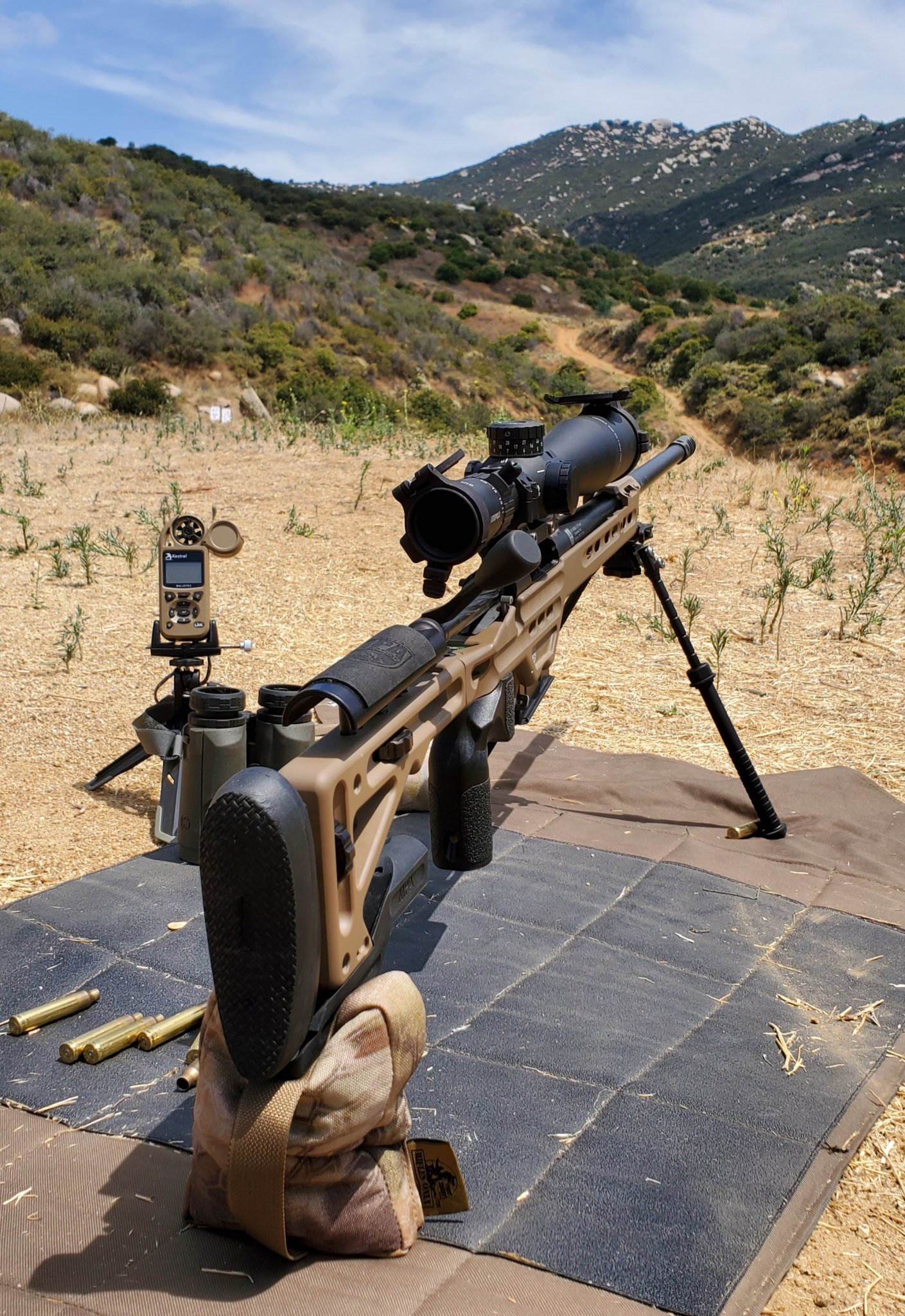

Bought a MPA 300wm here and love it. Shoots nice groups and had great success out to past 1500 yards.
Ballistic-X-Export-2020-04-21 21:03:56.559715.png
Going to do more load development to find tighter Velocity spreads
Reactions: NamibHunter

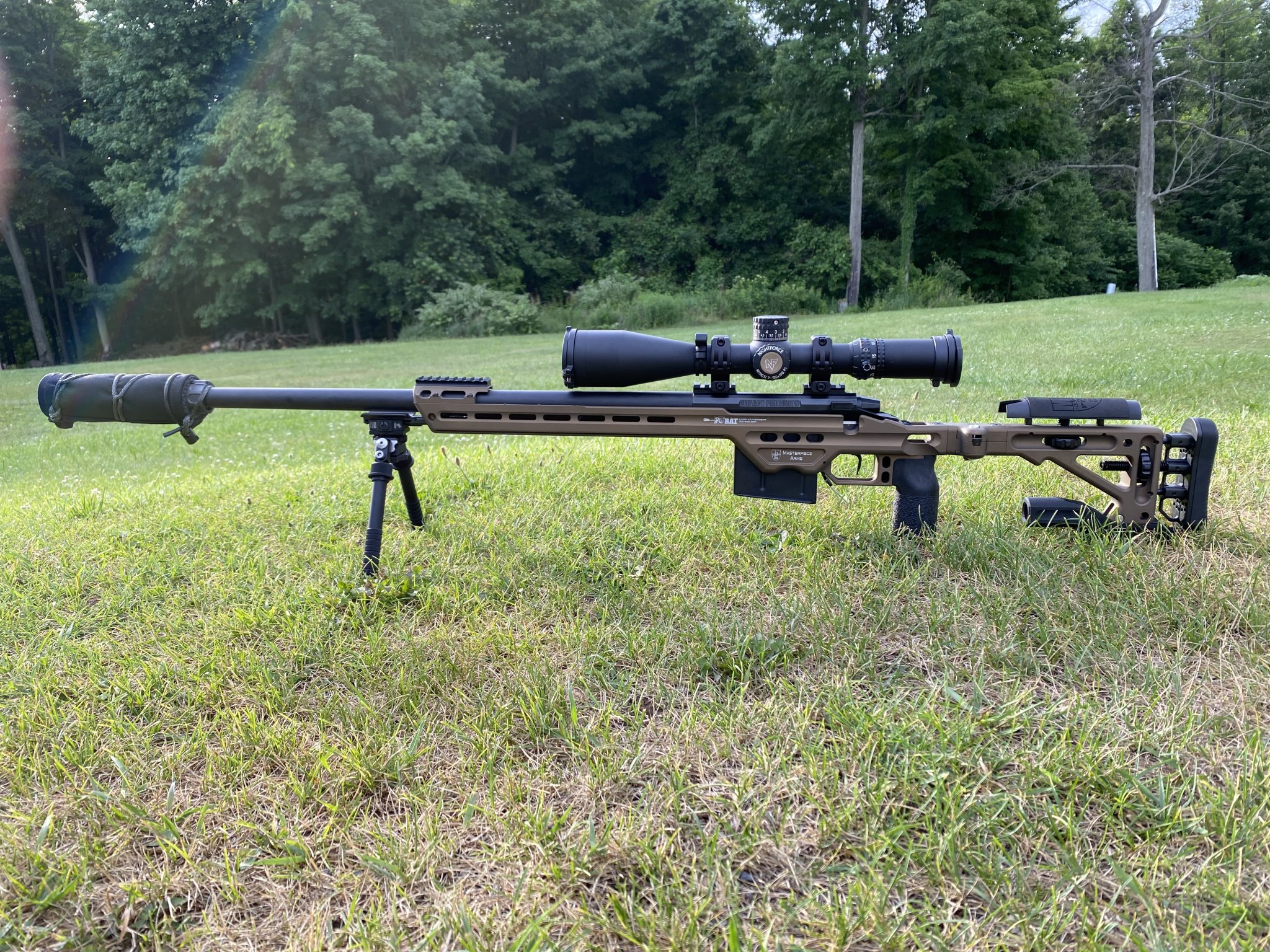

In Jan 2020 I got a 6.5 MPA Pro Comp Chassis (FDE) w/ Impact Action, a 26" M24 contour Bartlein Barrel, TriggerTech Diamond, Area 419 Hellfire Break , ZCO 5-27 x 56 & TBAC Bipod. The thing shoots lights out, sub MOA (3/8). It would shoot better if the Indian shooting the arrow was better.
I’m a fan. Only change I would have made is not selecting the QD Sphur so that a Send It MV3 wouldn’t have any obstructions. I’m really wanting the MV3.
That is a superb set of components. Post some targets!
Presume you are happy with the ZCO scope?

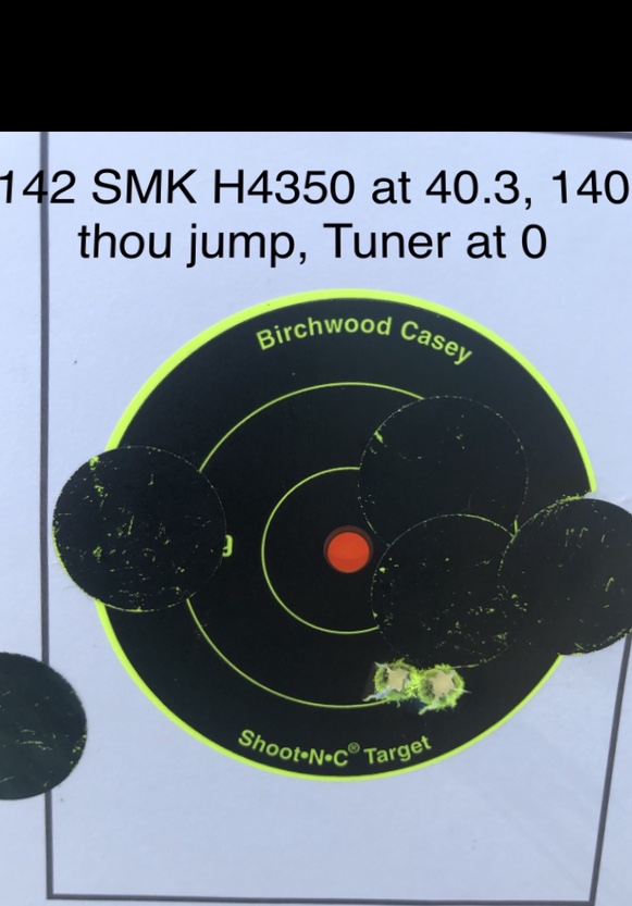

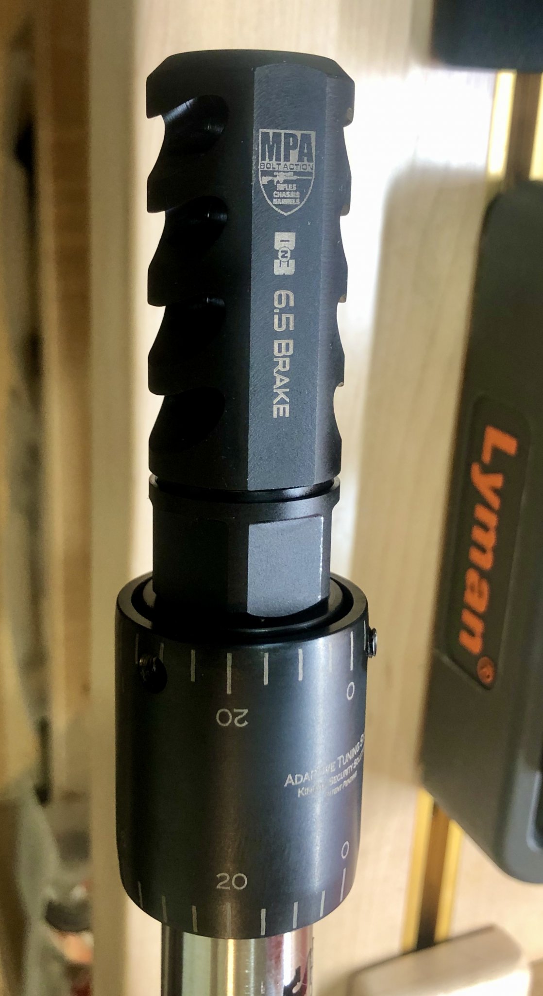

I have installed the barrel tuner from Aaron Hipp, and all i can say is “it works”, like in bullets holes touching at 100. Routinely see three shot groups below 0.2” now. Will do 5 shot groups soon.
Just something to be aware of: The original V1 DN3 brake is incompatible with the tuner. Not enough threads were grabbing onto the tuner. Most self timing and shimmer brakes and suppressors wil work though.
I contacted Phil at MPA and we worked out a deal to replace the V1 brake with the V2 brake, which fits perfectly. I am now using the V1 brake on another rifle.
View attachment 7373997View attachment 7373998View attachment 7373999

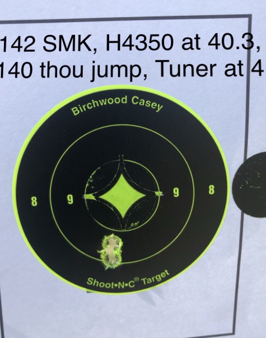

Groups first closed down to 0.2” as i turned the tuner, then opened up to about 0.4”, then closed down again to below 0.2”. Still need to do some fine tuning by moving the tuner in smaller increments. Shot off a bipod and a rear bag with another fidgety person on the other side of the integrated bench. My aiming error is likely 0.1”, and in the hands of a better shooter, and set up for free recoil, these groups probably would have looked even better.
You probably can achieve the same effects with powder charge and seating depth adjustment, but it is so much faster and more convenient. I have done load development at the bench a few times, but you have to cart a lot of gear with you. All you carry with you is one hex key.
For those that want to use factory ammo, this is a way to (almost) approach the same accuracy without needing to buy $2K worth of reloading kit. The same price as one good sizing die. 😊
I should perhaps qualify the comment about the V1 vs. V2 brake:
The issue with the V1 is not that the number of threads is insufficient. The V1 nut shoulders up on the rifle. It works like a normal nut/bolt and tightens against the muzzle brake vs. the V2 which uses a reverse jam nut tightening against the shoulder.

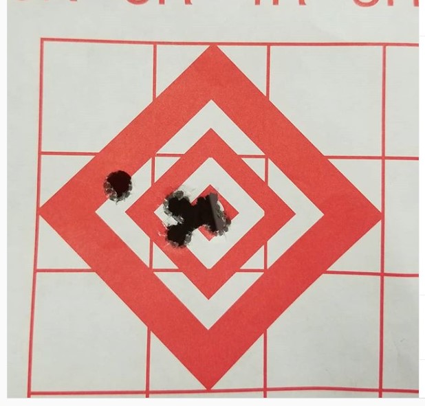

I have the 6.5CM MPA BA, amazing rifle, consistent 5 shot 1/4 MOA, the rifle was so accurate at 100 yards, I had to take load development to 200 yards to really see the differences.
I don't have alot of pics, this is 200yds, I pulled my 4th of 5 shots, eyed drift, but this is repeatable accuracy, not a one off groups that you can't repeat. Granted my reloads are pretty good, my last Chrono of 10 rounds was AVG 2791, HI 2798, LO 2785, SD 4, ES 13

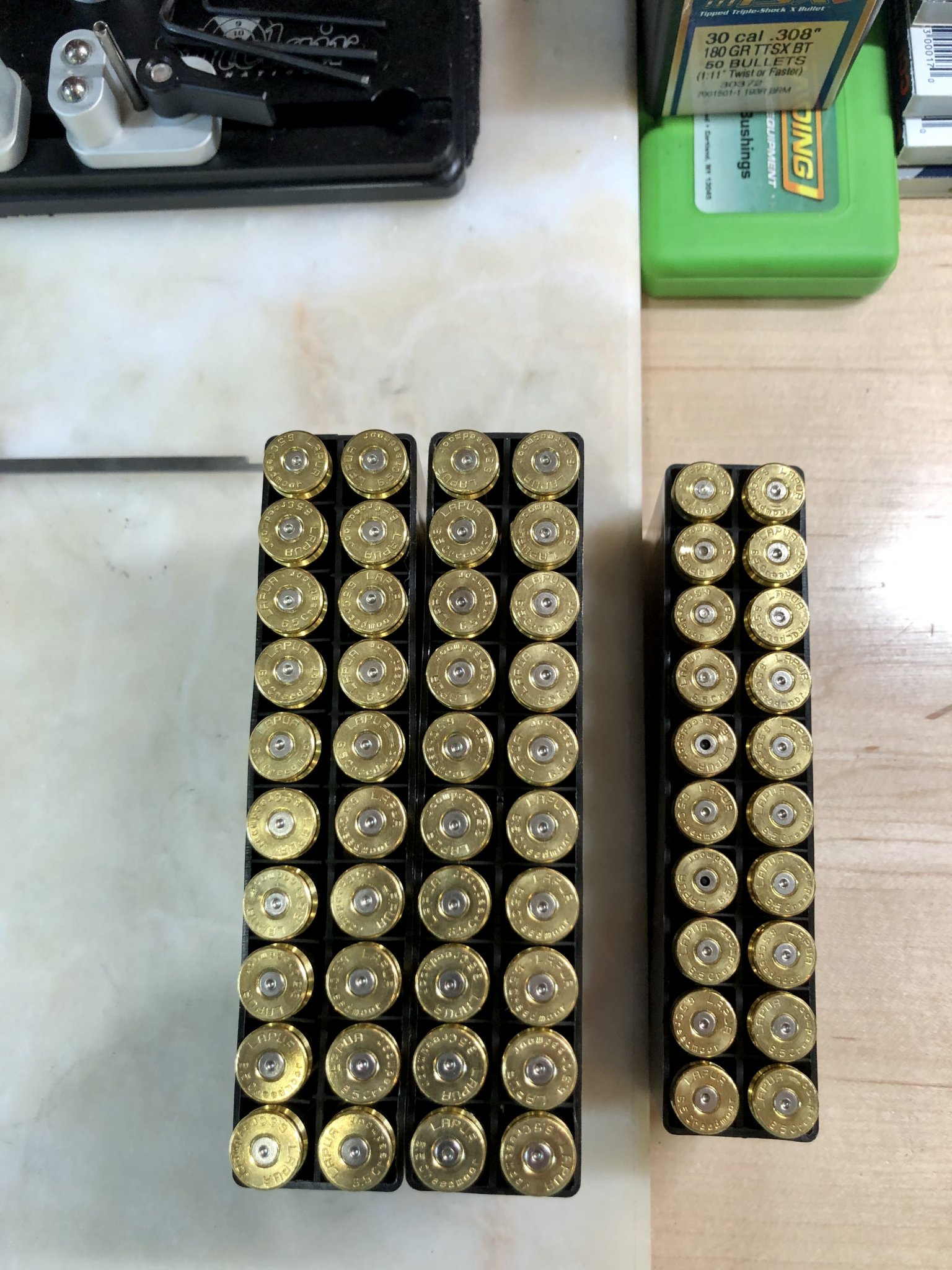

Total of 60 rounds fired through three different rifles on the same same day, by three different shooters, and the rifles are allowed to cool down when the temp strip on the barrel reaches 120 F: Savage 12, Remington 700, MPA BA. Only the MPA pieced primers (not many, typically 2-3 per box of 20).
Could it be caused by the tighter than usual chamber? The bullets don’t seem to be jammed, as there are no marks on the bullets if you chamber and then extract without firing.
Might have one possible explanation for the two blown primers: At least one of the once fired FL sized cases had a length of 1.390” post FL sizing via the Whidden non-bushing sizer, which usually adds 6-7 thou to case length. That makes me think this particular cartridge came from the Berger factory ammo line at 1.300”, which is 10 thou over the max spec. Unless something weird happened during sizing, which is always a possibility... and maybe it was contacting a minor carbon ring. However, I do intensively scrub that area of the chamber about every 100 rounds.
