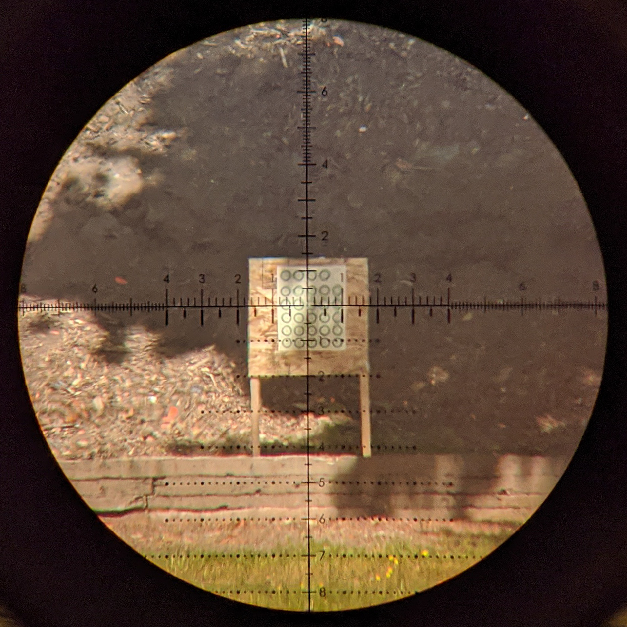

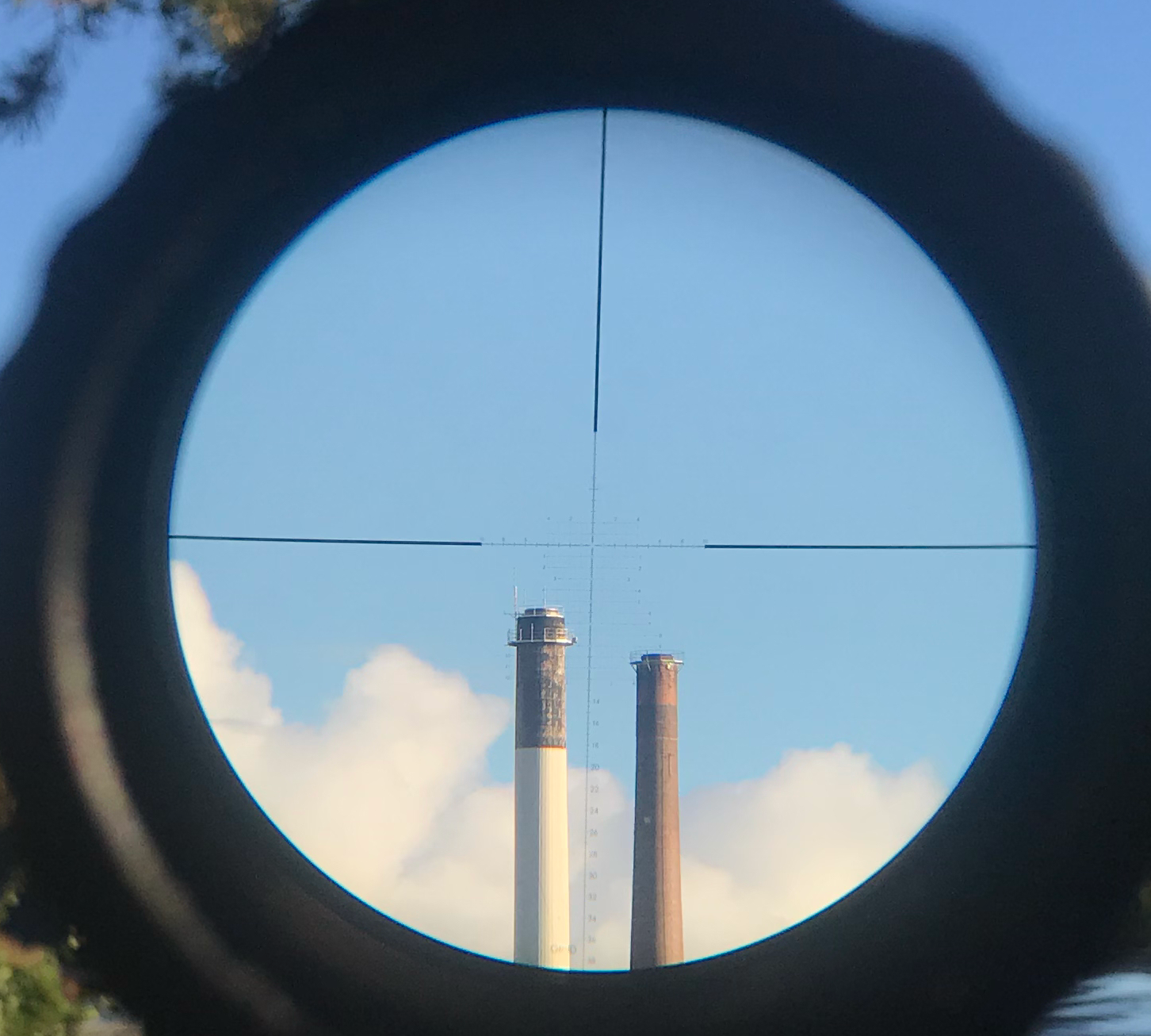

Both @ 20x.
Razor AMG. Odd that the reticle isn't centered (look only 9.7mils up, and 10 .1 mils down? It's taller than wide not a perfect circle? Weird.
Leica PRS
thanks for posting this. I think this shows 2 things: 1. The PRS is a step above a true high level mid grade scope 2. How difficult it is to separate these higher end scopes, it is very difficult to see the difference with the naked eye. excellent pics and post.

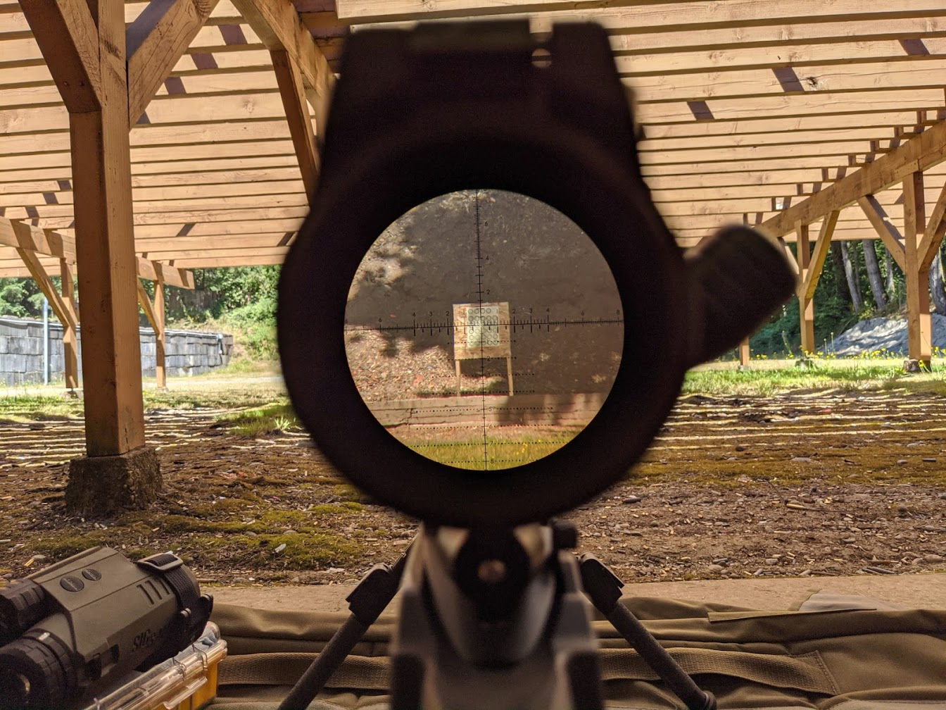

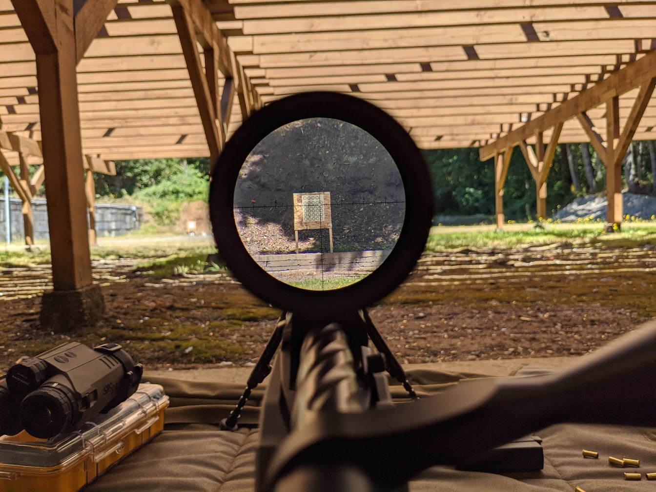

Using a cellphone to take a picture through a scope is pretty difficult. Actually being behind the scope the Leica is a good tier above the Razor AMG. The eye box is really nice as well and getting behind it in dry fire drills felt really good. It's got a nicer eyebox than my other scopes.

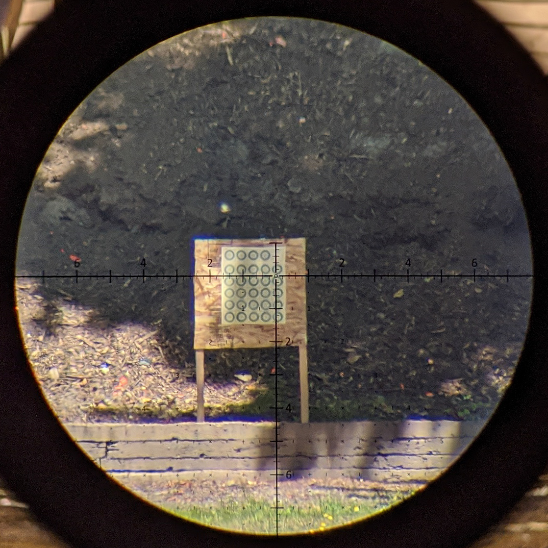

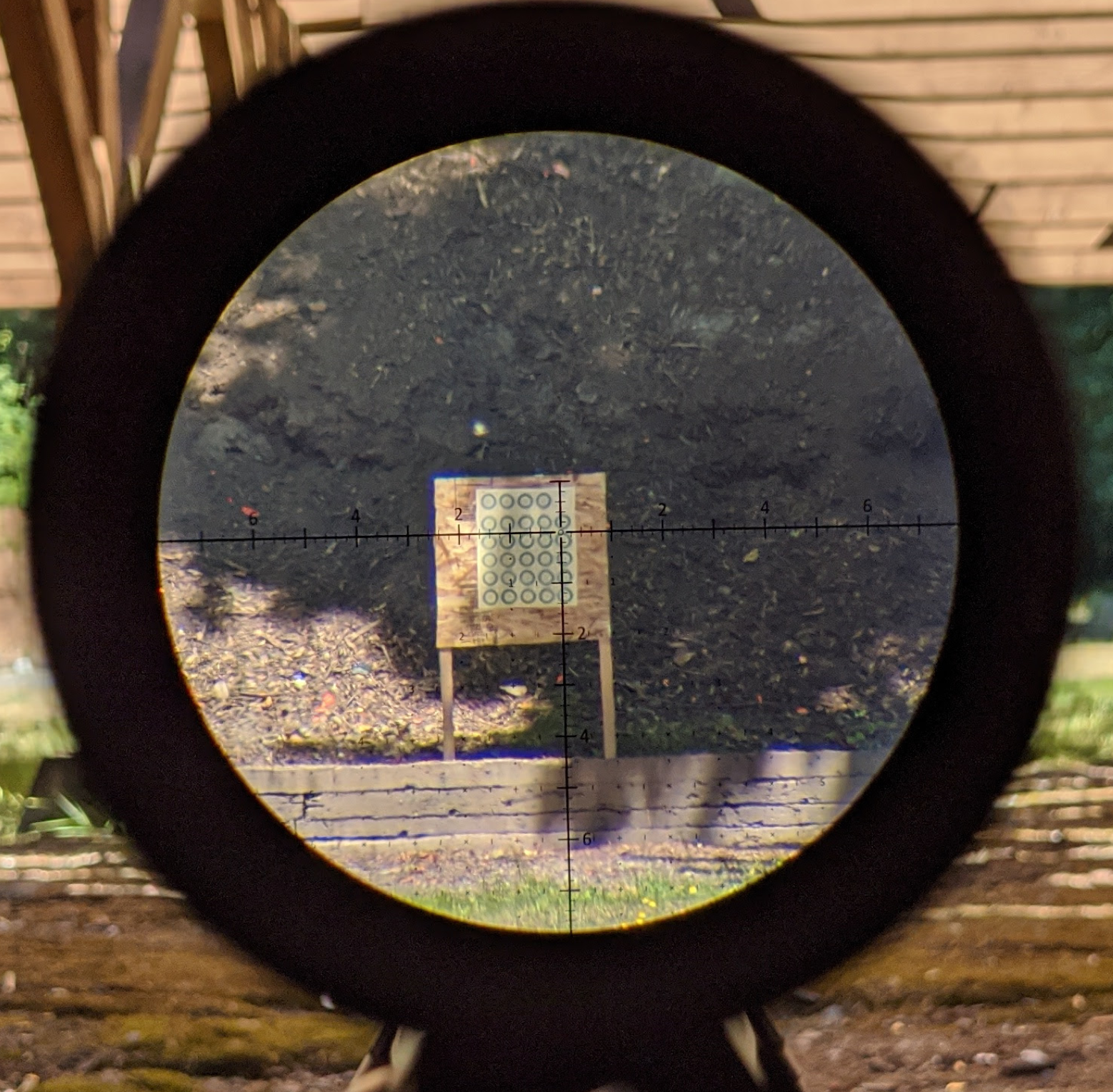

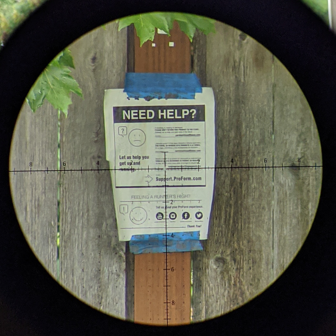

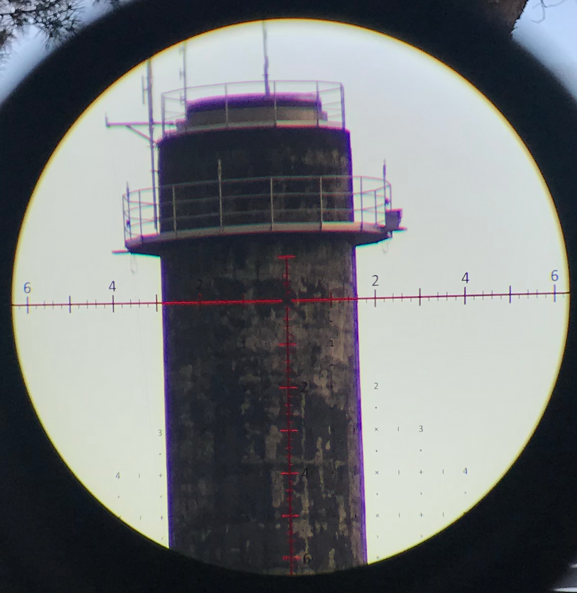

Cell phone shots of the Razor HD AMG and the Leica @ 24x @ 200 yards. There was mirage today.
The CA that is shown with my phone camera through the Leica was not spottable at all via my eye. I kept checking the scope after I took the picture to see why there was CA in the picture but that I couldn't see it. It was just an issue with a lens through a lens. The Razor HD AMG didn't pick up any CA in the image through the phone, but the image is also a lot "browner".
So much more clarity in the Leica.
Razor HD AMG @ 24x @ 200 yards.
Leica PRS @ 24x @ 200 yards

did the vortex look as brown with you eye as it did in the pic? Are you sure that wasn’t a Lens to lens thing.
You might have me getting the Leica.
It definitely is browner, I mean it doesn't really bother me either when I shoot, it's only when comparing pics side by side. This is the uncropped pic, the white balance in the photos look pretty similar.

This pic really shows the advantage of the Leica. Looks excellent!!! I like that reticle too.............I can't stand the Vortex EBR-7C, busy as hell and just not my style. The .5 Mil vertical marks diving below the horizontal is really distracting to me..........wish they would have just kept .2 mil windage marks throughout, spaced evenly on the horizontal stadia. Guess that's why I don't own a Vortex with that reticle.

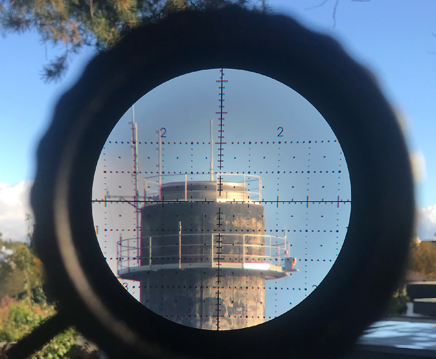

I ran the EBR-7B reticle on the Razor HD AMG all yesterday running through PRS 22 practice stages. Although the glass isn't the best, and the reticle is really busy, I love how the #'s are down the center line and how the reticle is dark and usable at 10x. The Leica, the holdover lines are only usable at 16x+, anything below they're just too faint.
I agree with you about how busy it is, if I was to design the perfect reticle, it'd be very similar to the Leica, just make the lines darker and usable at the 10-12x range. I'd also make the vertical stadia extend up to 2 mils instead of 1.
I'm also perfectly happy with just .5 mil hashes down the vertical stadia. I feel for quick holdovers I easily get .5, .1, and .25 as I'm halving between 2 lines pretty effectively. That's enough for my needs. I ran timed drills yesterday from 25-200 yard targets (holding at down .3, to up 7.0) and the AMG is so quick. I can dial down to 10x to have a large FoV, and the can quickly holdover on each target.

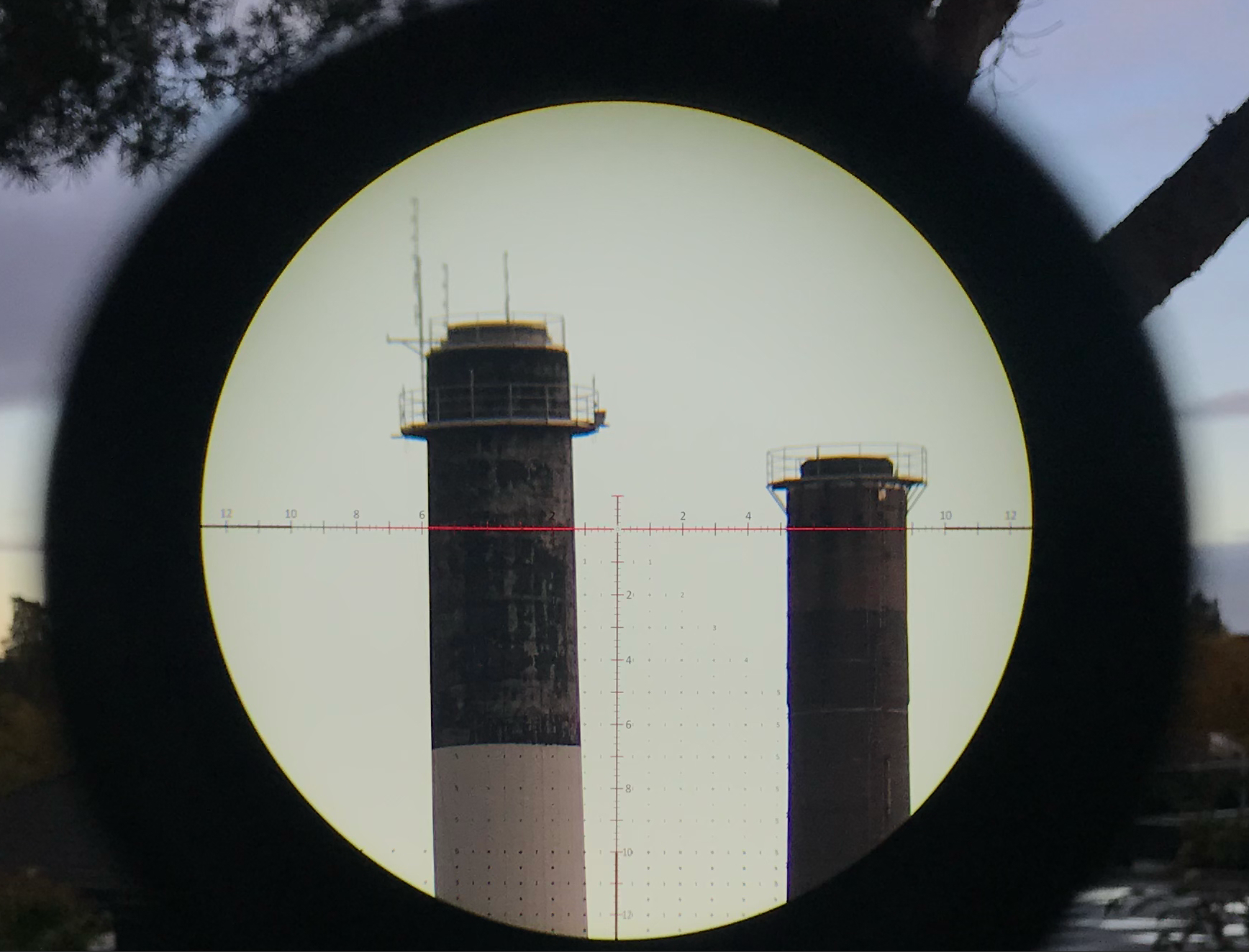

Man, I almost think you got bad glass on your AMG. My Leica seemed very similar to yours, but my AMG seemed much more comparable than yours. When I get back stateside I’ll compare those two with a 5-25 ATACR. My AMG out performs the ATACR optically for sure. Again, I had limited time with them before I left, the Leica was definitely better, but I couldn’t really see the difference until near dusk. After that it became much more pronounced. Now I really want to re-check though.
On good day conditions, the AMG is pretty nice. You can see at the 35 yard text, the AMG resolves it pretty well. It's just that on a mirage day, the AMG definitely gets affected more than the Leica. Most of the time I shoot in overcasty no mirage days, and my friend and I never noticed any issues with the AMG, but once mirage picks up, the AMG doesn't handle it as well as the nicer glass.
I'll head out to the mountains probably in a month and will bring the AMG and the Leica and compare glass at 1000 yards across a valley. There's some interesting mirage/thermals going on over there.

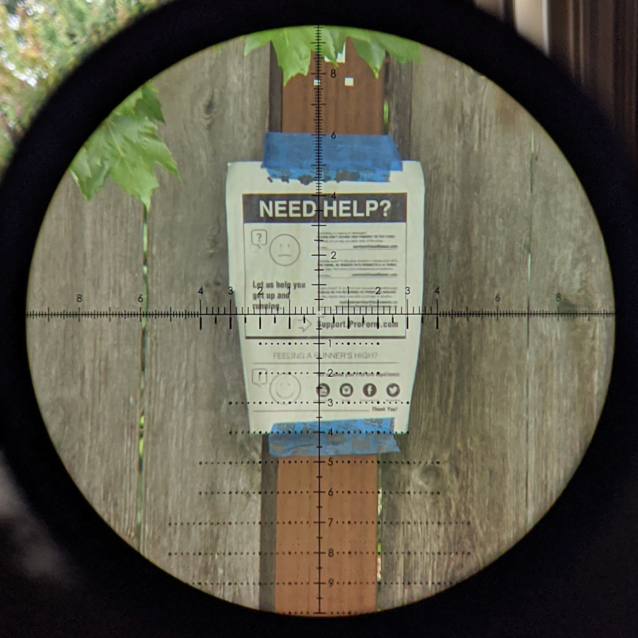

Just figured I’d chime in here. I’ve been running the Leica PRS w/ PRB reticle for NRL & PRS type competition since May of this year. Very pleased overall. Tracks perfect. Glass quality is absolutely superb. Great turrets. I can’t even describe how much I love the tool free turret adjustment...so easy & so fast. Thus far, definitely among my best decisions as far as $$$ well spent/invested. I was a little bit hesitant just due to the reticle, but I’ve actually grown to love the floating open circle in the reticle.
Could Leica make some improvements to the optic for the next generation? Sure, absolutely. I was actually really impressed with the time the Leica reps spent with me on the phone going over my feedback on the scope after I’d had it for a month or so. They really seemed to value the feedback, and some of the things I suggested they are already working on.
-I’d like to see the vertical stadia above the main crosshairs extended a bit...maybe 3-4 mils rather than just 1.
-They need to adjust the position of the throw lever on the magnification ring so that I don’t need to remove it when running on 30x (this was probably my biggest criticism of the optic...it hits my bolt knob). They acknowledged that this is going to be addressed in the future. Not a huge deal though as I never go over 20x in competition. And it’s easy to thread on & off.
-wouldn’t mind if the reticle was just a tad heavier/thicker...maybe 25-35% or so. It can seem a bit too fine when under 12x.
-I’d like to see a few more distance references on the parallax adjustment.
Overall, absolutely awesome scope!!! Punches way above its weight class for the $$$. It easily goes toe-to-toe with the 7-35 ATACR (also a great scope) but for about $700-$800 less.
