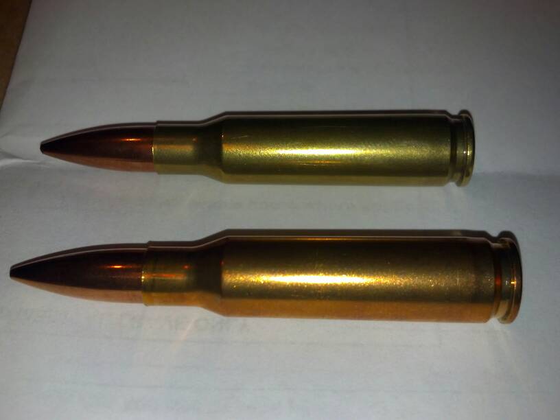

The more I look into this the more I think I may be misunderstanding the term pinking, my brass have been discolored to the point that they are nearly an identical copper color as the bullets I intend to put on them. Other people across the interwebs seem to have ended up with almost pure copper cases that are literally pink. Mine are no where near that stage of being stripped of zinc. From what I have read mine are merely discolored and possibly even only on the surface. As with all things reloading, the discoloration is a variance from the norm and raised cause for concern. I think this may clear up some other concerns that people may have on this subject and I will post pictures of my cases, as this thread doesn't have a visual reference yet.
