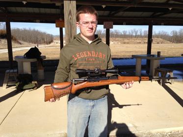

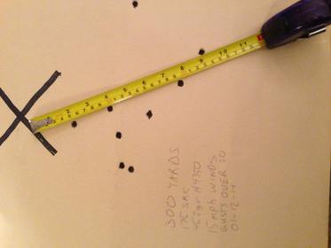

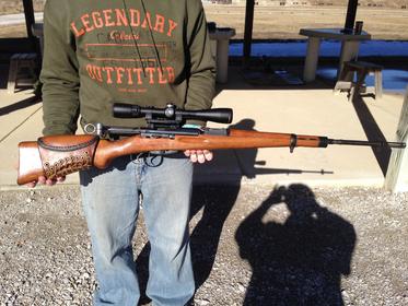

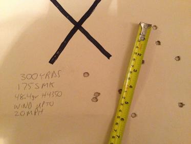

ok finally got some H4350 loads worked up
image.jpgimage (2).jpgimage (3).jpgimage (4).jpg the first picture is my son doing the Vana White. second is the bubba'd up sniper wannabe. I did a ladder from 44 gr to 49gr in .2 gr increments and these were the two nodes I got. sot at 300 yards and the wind was about as bad as could get with swirling and up to 20mph gusts. I loaded them as long as I could and still fit in mag. I think I still get a bit of jump but didn't measure. the lower node was just over 2 min and high just under. some was wind and he called 2 shots each as wind and gun set up was messing with him a bit. there were no signs of pressure in any of the loads. primers had no signs and extraction was same through out the ladder. might try some vv powders next. n160 was showing about same and didn't do a ladder with it yet. hopefully got some info out of it and we got to play around a bit.
