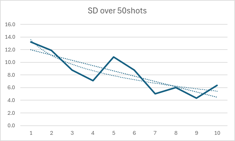

A question - is it your experience to see SD's flatten as the barrel carbons/coppers back up? Not specific to or barrel. My intuition says "yes". With that: the question becomes how many foulers should be shot?
From a stripped clean barrel, within the first 2-10 shots, sometimes you will see goofy shots related to velocity. More rarely you'll see in the first 1-3 shots after cleaning some accuracy fliers. Suppressors can also cause 1st shots in a string to have low velocity (20-50fps slow). Not sure the physics behind that but I've seen it enough times with various combinations to keep an eye open for it.
Beyond that, I have not really noticed SD's to change unless you change bullet type, powder lot or type, or sometimes primer type (some cartridges are more or less sensitive to this). If you shoot 20-30 shot strings and get the SD on that, it stays within about 1fps pretty much every time until the fouling builds up to the point of significantly increasing peak pressure, at which point SD's and precision both suffer.

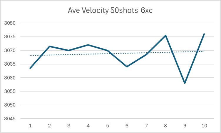

View attachment 8339134View attachment 8339142View attachment 8339149
6xc - Factory rounds
Tubb Gun, Vortex Gen lll, Tubb muzzle brake, Magneto Speed used for data.
60shots- group shown is 56-60- 12minute cycle.
100yds, Phoenix Bipod, rear bag, prone.
69deg ambient. Final barrel temp 110max read with a chamber value of 93deg. Wind 11:00 2-5mph. 34%RH
Stripped clean cold bore shot included.
2 Witnesses.
Yes. I’ll send you a plot here in a few mins.
2 Witnesses.

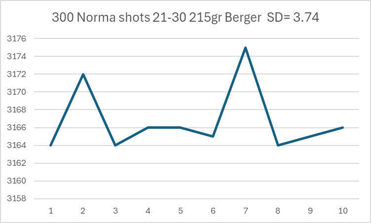

Focusing a bit on SD drift. This represents a 30shot string with the shots 21-30 being shown. These are hand loads using Berger 215's. This barrel has north of 2000rds thru it. A Tubb Gun in 300Norma.
We recently had a demo at SHOT in which our MRAD had 30-40rds plus thru it on continuous demonstration/different shooters use. The final rounds were on a 2075yd target with a first round impact and 3 follow up. A stable SD is required to achieve that performance. An "Objective Anecdotal" moment with a couple of dozen witnesses, which was all levels of Mil and LE. The temperature was 49deg and the gun was running a suppressor. The barrel maximum heat was 81deg, chamber 61, suppressor 210degF. I would Hypothesize that a cooler barrel will hold SD's longer.

View attachment 8341031 View attachment 8341032
max
3175​
min
3164​
Ave
3166.7​
ES
11​
SD
3.743142​
Not the best at inserting charts and data....

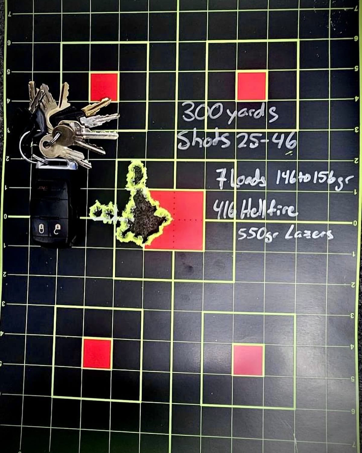

22 Shots #25-46 on new 416 Hellfire.
300 yards - 7 different powder charges - load testing.
Love this tacomHQ Structured Barrel. No weird harmonics between loads sending bullets every which way.
I probably should have let my string continue upwards with the different powder charges, but I knew I didn't load any with enough powder to get me where I wanted, so I dropped them down to save paper ;)
Cutting Edge 550 grain lathe turned solid copper projectiles, Bertram brass, BAT Machine Company Inc.ne EXS action, Athlon Cronus scope, Era-tac adjustable scope base, Jewell trigger, Ryan Cheney ELRn Cheney ELR . com Airfoil bag!
