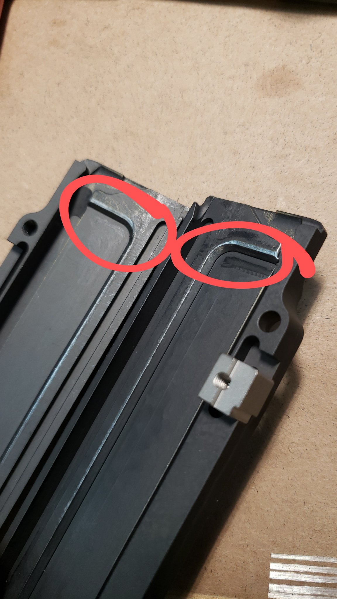

Update- 1. Fixed the cocking problem. Trigger Tech asked does it not cock at all weights? I had it set at 1 lb. 6 oz. went lower it still didnt cock. Went up to 1lb 8oz- cocks fine. 2. Got the mag running much better with a little more filing inside. 3. Sometimes the mag doesn't present the bullet high enough to go in the chamber- waiting on the long latch I ordered from Hawkins precision to see if i can fix that.

Finally got some time to take my Deuce out. Pretty much my experience seems very similar to usafa77 my mag did bind a couple times but I'll take it apart and polish/file, I do have a plastic mag on order so I'll be curious if the issue is on those as well. I have not had any cocking issues but I am running a Trigger Tech 2-Stage Special. I posted in one of the other threads I did have to modify my mags to work with my PDC chassis, basically just file the catch so its not a square but angle shape. However I am super pleased with the rifle and have my first match with it this weekend. And its a ELR match so it should be a good test!

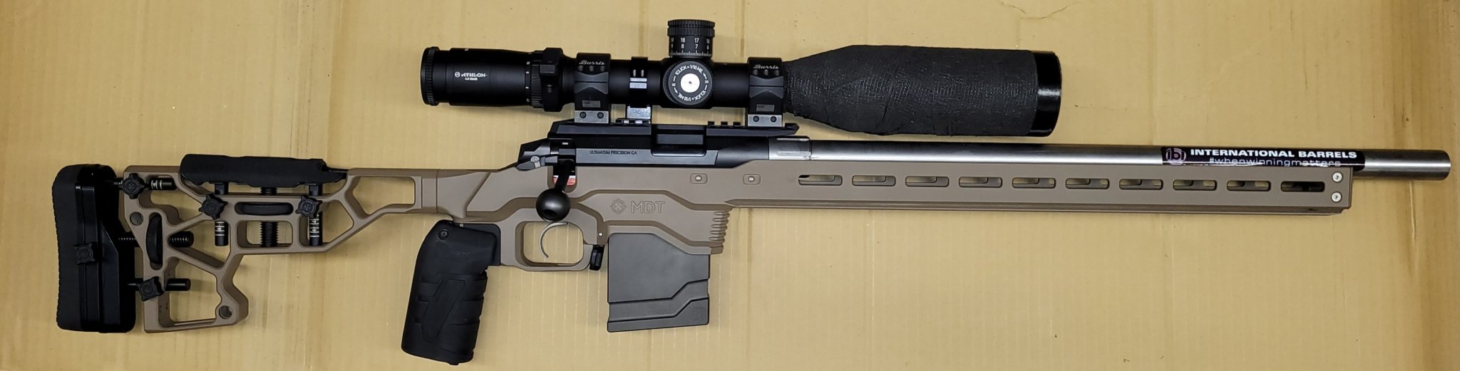

I've been running mine since Oct. I had to mod the internal mag with some dremeling to eliminate the occasional round that would hang up and not feed correctly. I have the IBI 1/12 twist barrel, M24 profile, 21.75 inches long with the Eley EPS chamber. It's a good shooting barrel that really does well at long range. I'm consistently getting 5 shot groups with SK LRM with 1.25 to 1.75 in vertical at 200m. I have noticed the increased spin drift of the 1/12 twist. This year I will run it in a match and give my Vudoo a rest🙂 I had it in a MDT XRS chassis and just recently put it into an MDT ACC. I switched out the steel buttplate assembly for the aluminum version and the balance is pretty good without having to use any weights.
