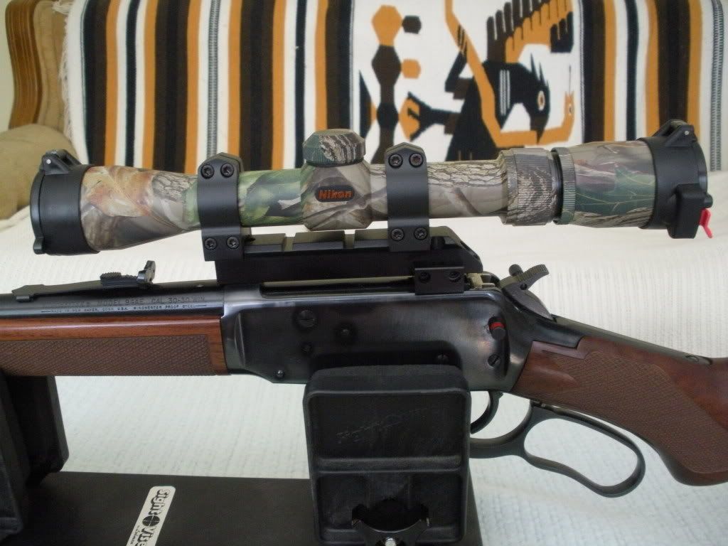

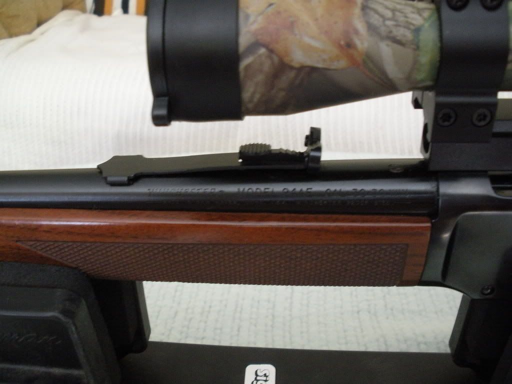

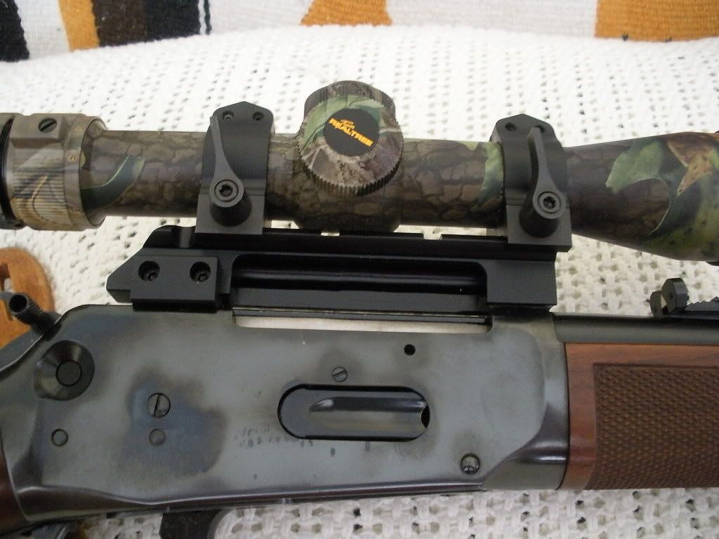

I am using Aimtech Second Sight on my Win. 94. It's a see trough Weaver rail, Nikon Prostaff (2-7x32)scope is mounted in Warne QRs. I like the setup very much, since it is low profile and the rail gives me the option to mount various aiming devices on it.
