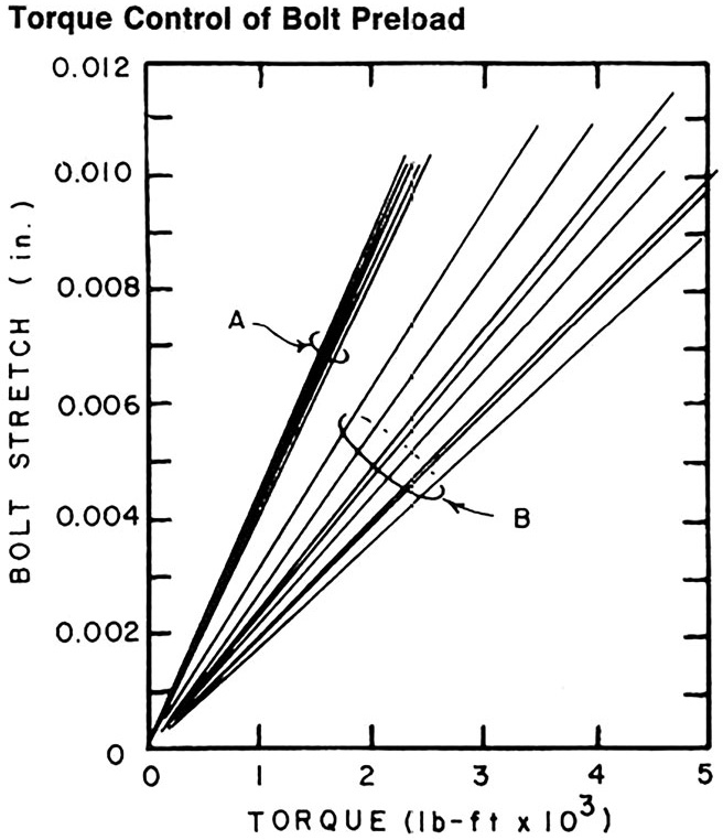

Did you measure bolt stretch? How did you quantify that the tension was indeed equal? Dry on dry threads will result in un-equal torque across fasteners.
The relationship between torque and tension is stabilized by lubricating the threads.
There is a preponderance of data suggesting strongly that lubricated threads produce a more consistent relationship between torque and tension.
I accumulated thousands of rundown (torque and angle) traces using Cooper and Atlas Copco DC nutrunners on dry threaded joints. That data had to be analyzed on a very frequent basis for both conformance to specs and for process capability and reviewed with the customer (Honda).
That volume of real data, not copy and paste internet articles, is what tells me that your absolute statements aren't as absolute as you think.
The torque/tension relationship isn't more consistent when the joint is lubricated. It's just a different slope to the linear region and a usually a more abrupt start to the linear region of the relationship.
The torque/tension relationship isn't more consistent when the joint is lubricated. It's just a different slope to the linear region and a usually a more abrupt start to the linear region of the relrelationship
So you're saying galled threads aren't slip and grip type variable?

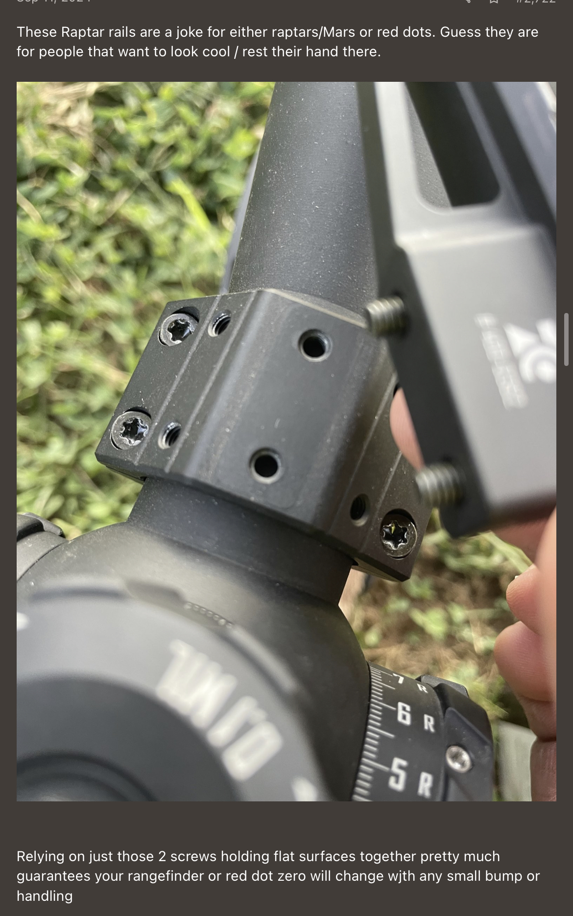

I am definitely a lay person who knows very little but I was also under the impression that vertical screws taking a horizontal force (recoiling against the weight of a Mars in this case) can shear, which is why scope rails have recoil lugs.
Shallow depth of knowledge passed off as expertise is how you identify fools
Just keep telling yourself that and torquing the screws home dry. Hundreds of pounds of tension against steel and anodized aluminum. The funny thing? It probably doesn't really matter, functionally, "results wise".
