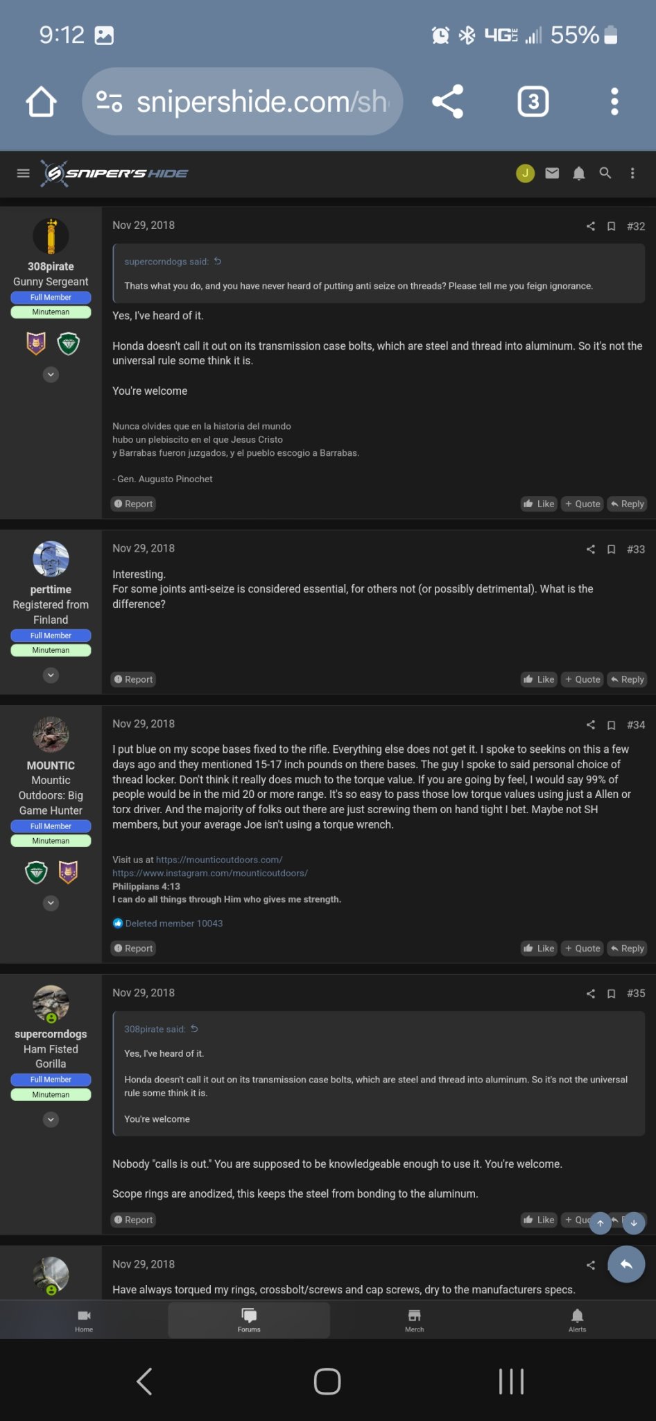

I think you’re completely missing the point, which doesn’t surprise me, but I just need clarification on something. Are you trusting Hakkan to build you a Honda engine?
Lol, no, just like I'm not using honda transmission case bolts as a case study on how to tighten ring cap screws. I'm relying on KAC, Hakan, Geissele, and Nightforce for advice, there.
Reactions: supercorndogs
Are we really comparing a Swedish redneck to a literal army of engineers informing a corporation that puts an astronomically higher quantity of fasteners into service daily?
Were comparing a transmission case removal for reman repair effort to ring cap screws, so why not?
But you are using blanket statements for things that aren’t simple enough to be covered by blanket statements, and that’s why you’re having such a hard time.
Some dude is talking about transmissions. I'm talking about scope mounting. He does this in every thread about the topic. I don't care about how much money he made fixing busted Hondas. This is about scopes. Trying to find some esoteric bullshit like tranmission casings in an attempt to provd the exception to the rule is absurd. Okay. Ive been proved wrong. IF I ever buy some old tech gas car, I'll remember...if it's a honda. Don't lube trans case bolts. Happy?

Did you measure bolt stretch? How did you quantify that the tension was indeed equal? Dry on dry threads will result in un-equal torque across fasteners.
The relationship between torque and tension is stabilized by lubricating the threads.
There is a preponderance of data suggesting strongly that lubricated threads produce a more consistent relationship between torque and tension.
Carol Shelby was well aware of this.
