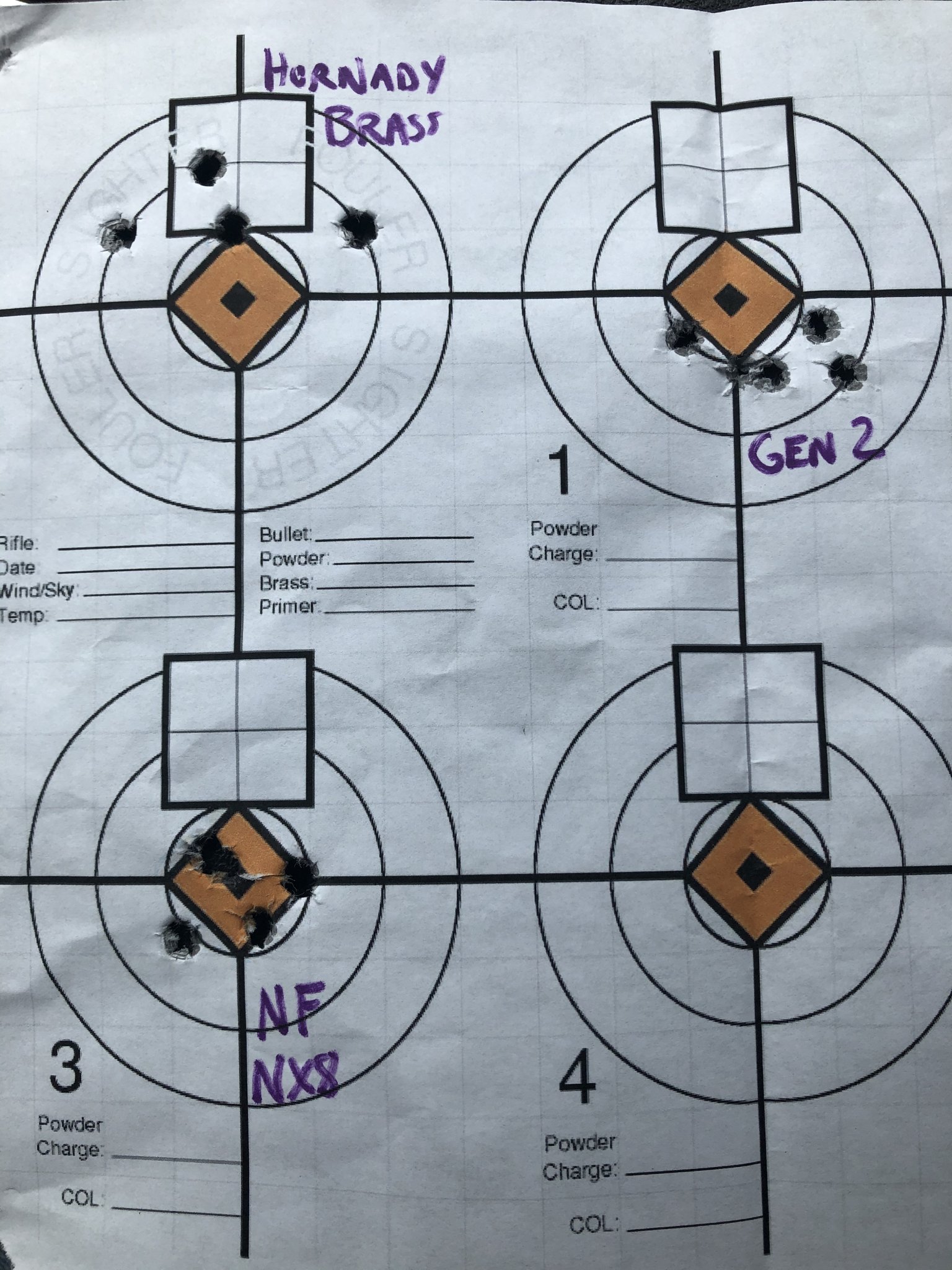

my Smith still wanted to hit the crown and then hit the chamber with a saami FB before I ran outta bullets so this morning he hit the crown about .050”...went and shot it again
Everything below is after recrowning...

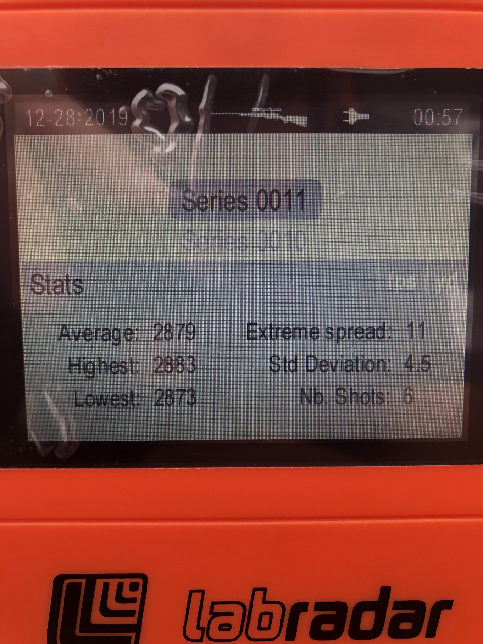

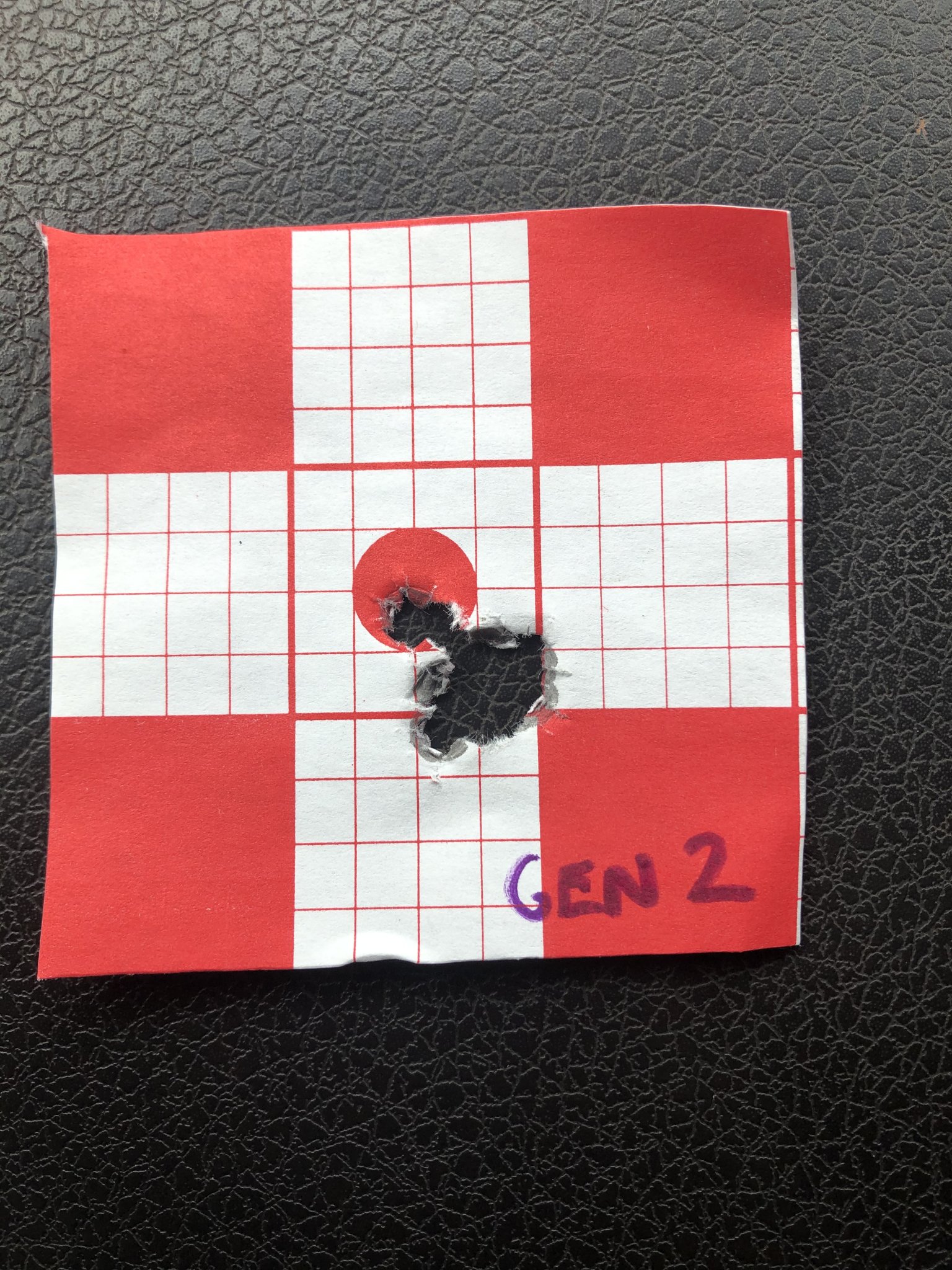

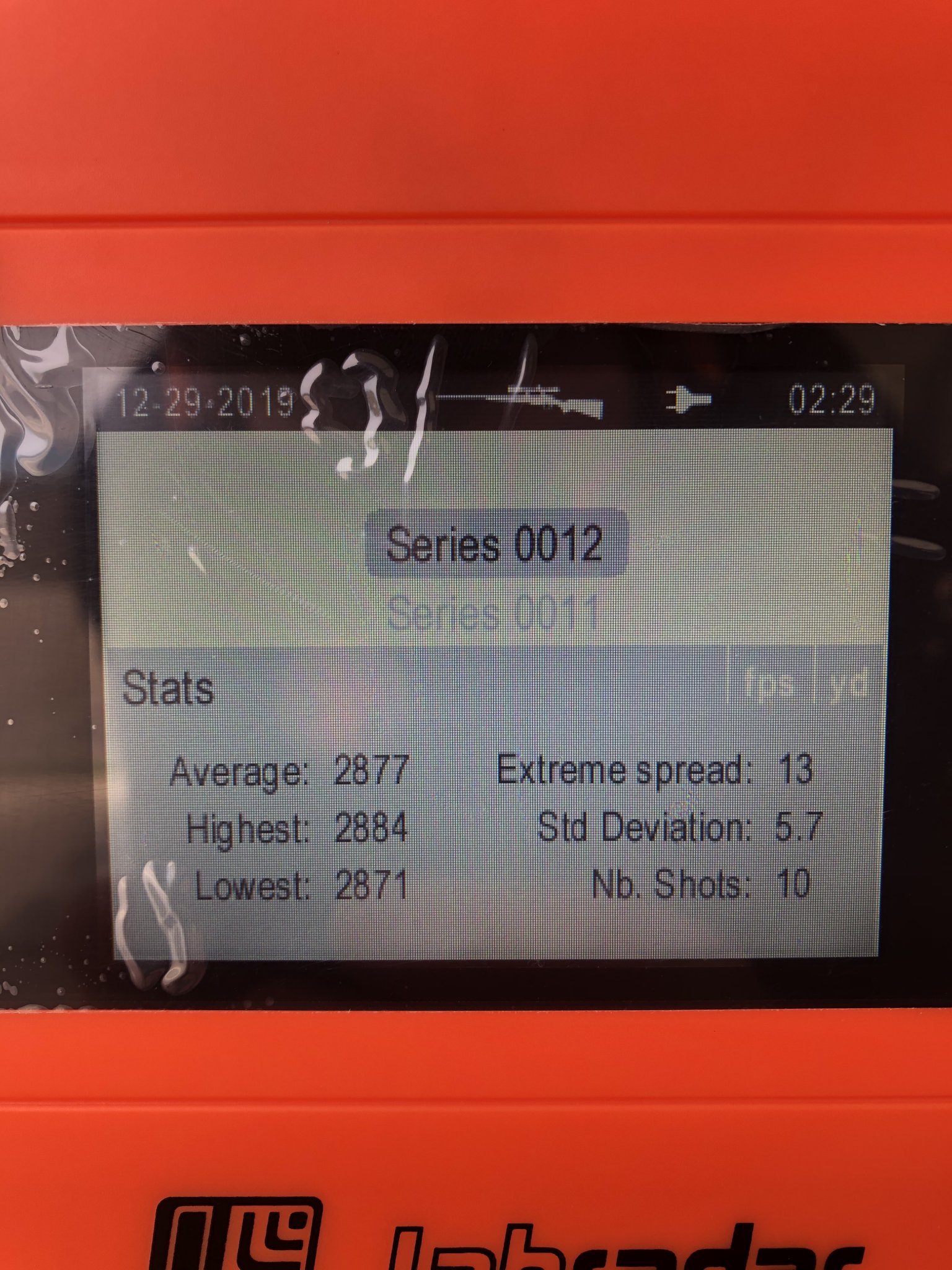

top left is hornady brass...I shot 4 then gave up on that route lol
top right is 5 rounds w/ gen 2 and just for covering based I stuck an NF NX8 on it and fired a couple sighters to adjust
Labradar is the 2 fire round strings from the Gen 2 and NX8...NX8 group is slightly better but Still pretty much the same
went back to the shop and looked at the notes...original FB was actually .157, not .167
Stuck the saami reamer in there just to recut the FB, headspace left the same...so it should have just pushed the .157 to .199
went back to the range with the same ammo from earlier, had 8 rounds left after the few sighters from the NX8
fired 2 sighters, just to hit the throat with some fire, then shot the last 6 rounds I had...
quite a bit better, and would be jumping .050-.060” in the new throat
only 6 rounds so i still wanna go back another day and verify, but better than any group it’s shot for the Last 30-40 rounds
View attachment 7211126View attachment 7211130

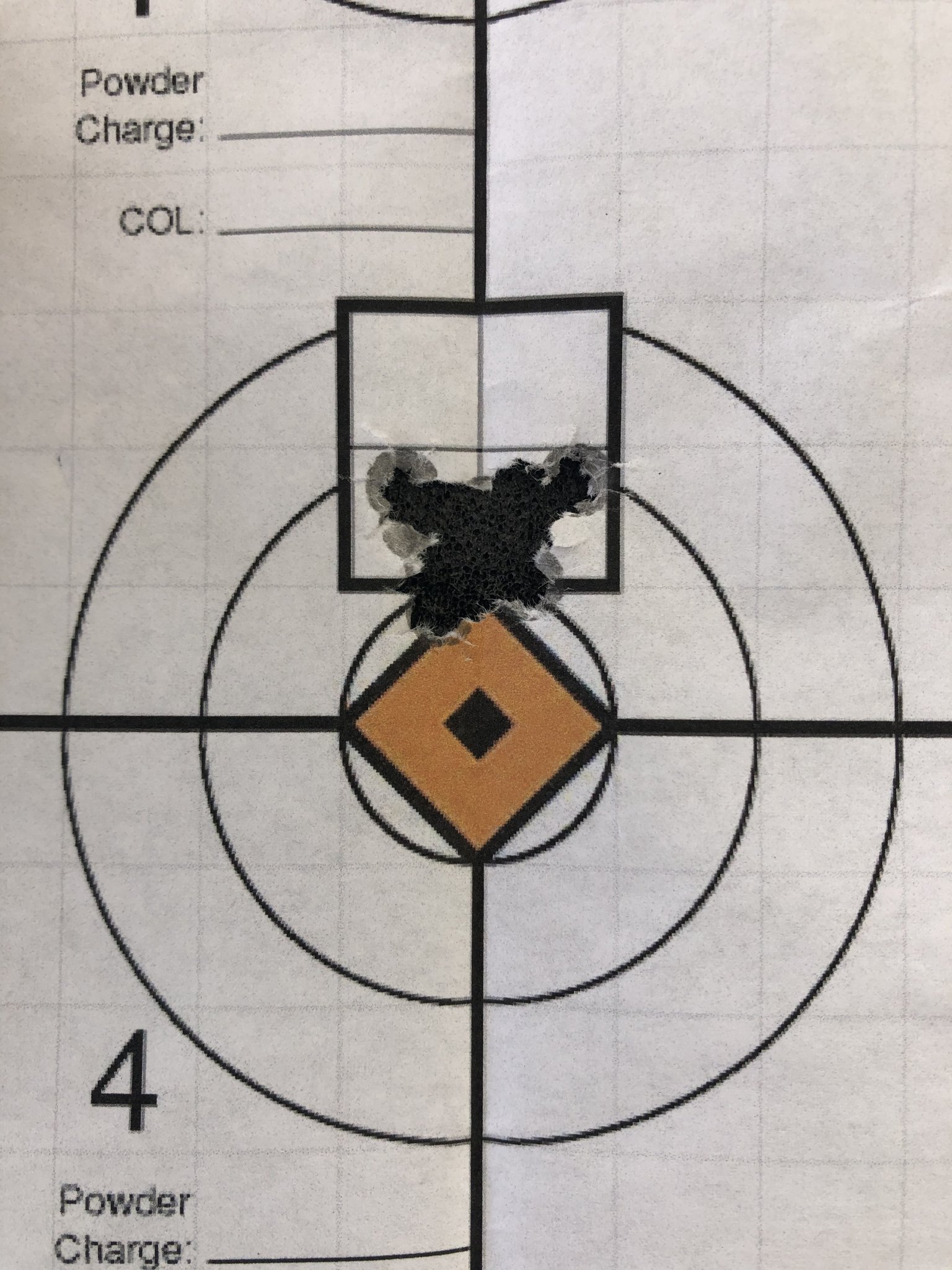

Ehh. That’s a difference for sure. May not be the hammer it was before but I’d say you definitely found where the issue was on the rifle.
