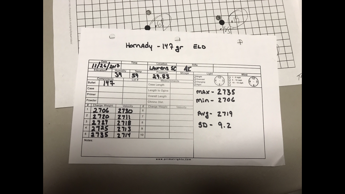

This is out of a 24” Bartlein barrel by Mile High.

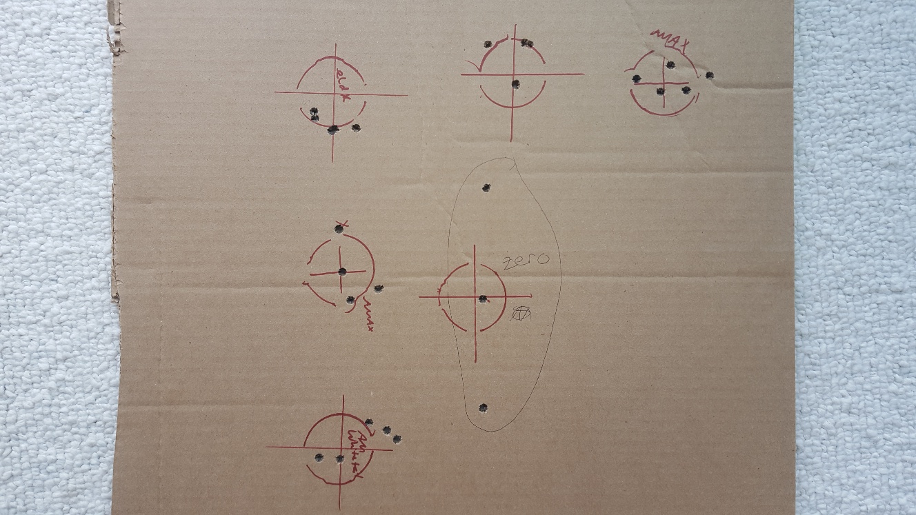

out of my brand new rem 700 custom shop north american 24" 1-8 twist, with eld-x 143's, i avg'd 2618 with 11sd and 31es (just five shots). nothing to write home about groups, below, all 5 shots @100yds, hopefully now that i lightened the trigger a little the groups will shrink a little...
