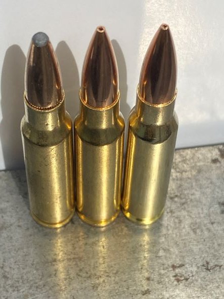

OSorry to resurrect this dead thread but I also had issues with ammo from two boxes of Federal 168 Grain Gold Medal Match (which I found about a week ago at a Walmart in Columbus Ohio). I have a Bergara B14 HMR in 308 and this ammo was extremely difficult to chamber, to the point I'm not comfortable shooting it or putting that much stress on my bolt handle/lugs. This is from two different boxes of ammo with all the same markings on them (see below).

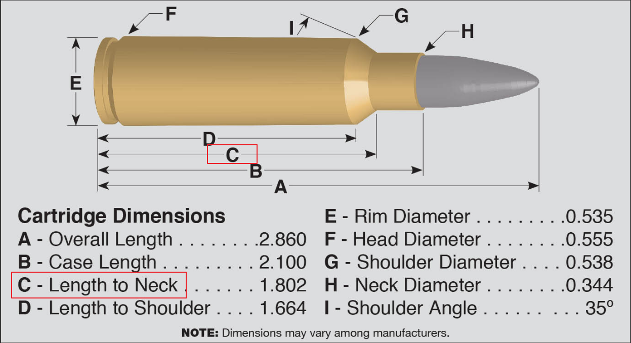

From the rub marks on one of the rounds I got to chamber it looks like the "length-to-neck" wasn't set back far enough. I haven't had this issue come up with any other factory ammo. Anyway, I am going to call Federal on Tuesday (I assume they are closed tomorrow) and let them know about this. I was just searching for this issue with this ammo and thought I'd add to this thread. Looks like the ammo was manufactured in Sept 2021.

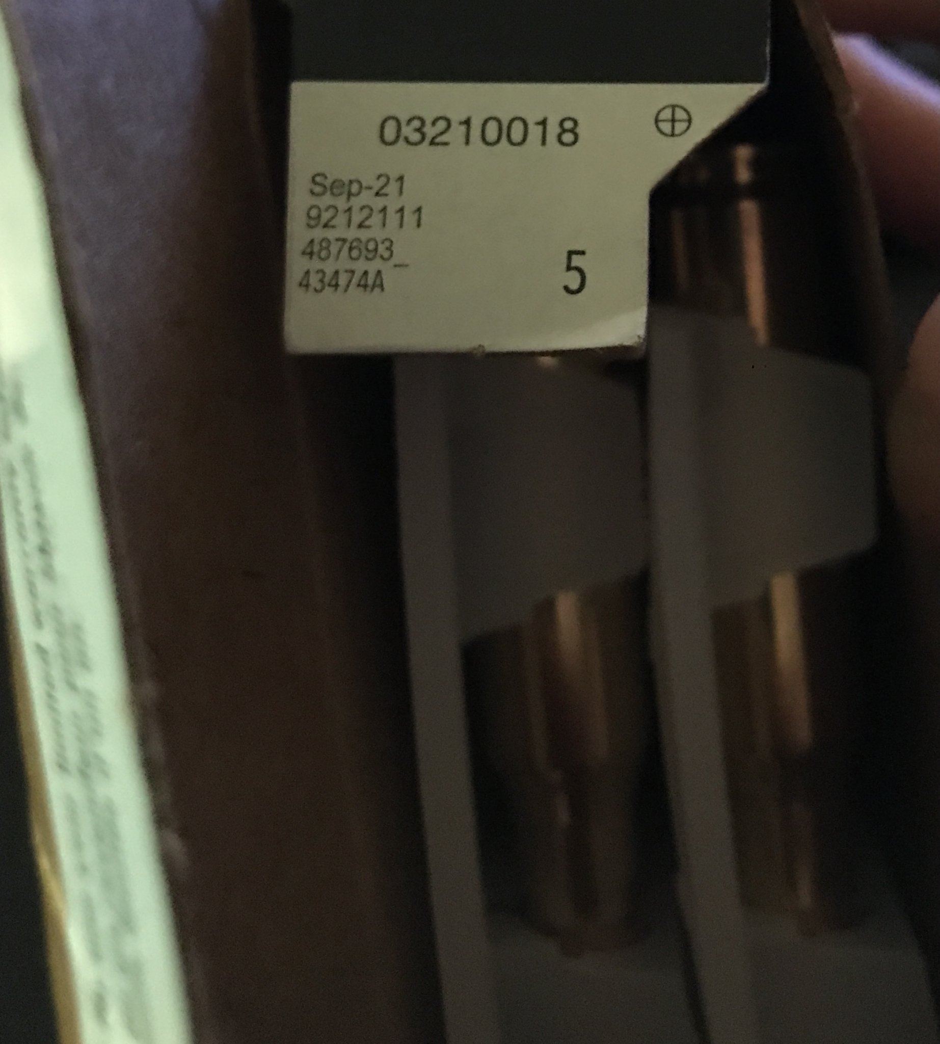

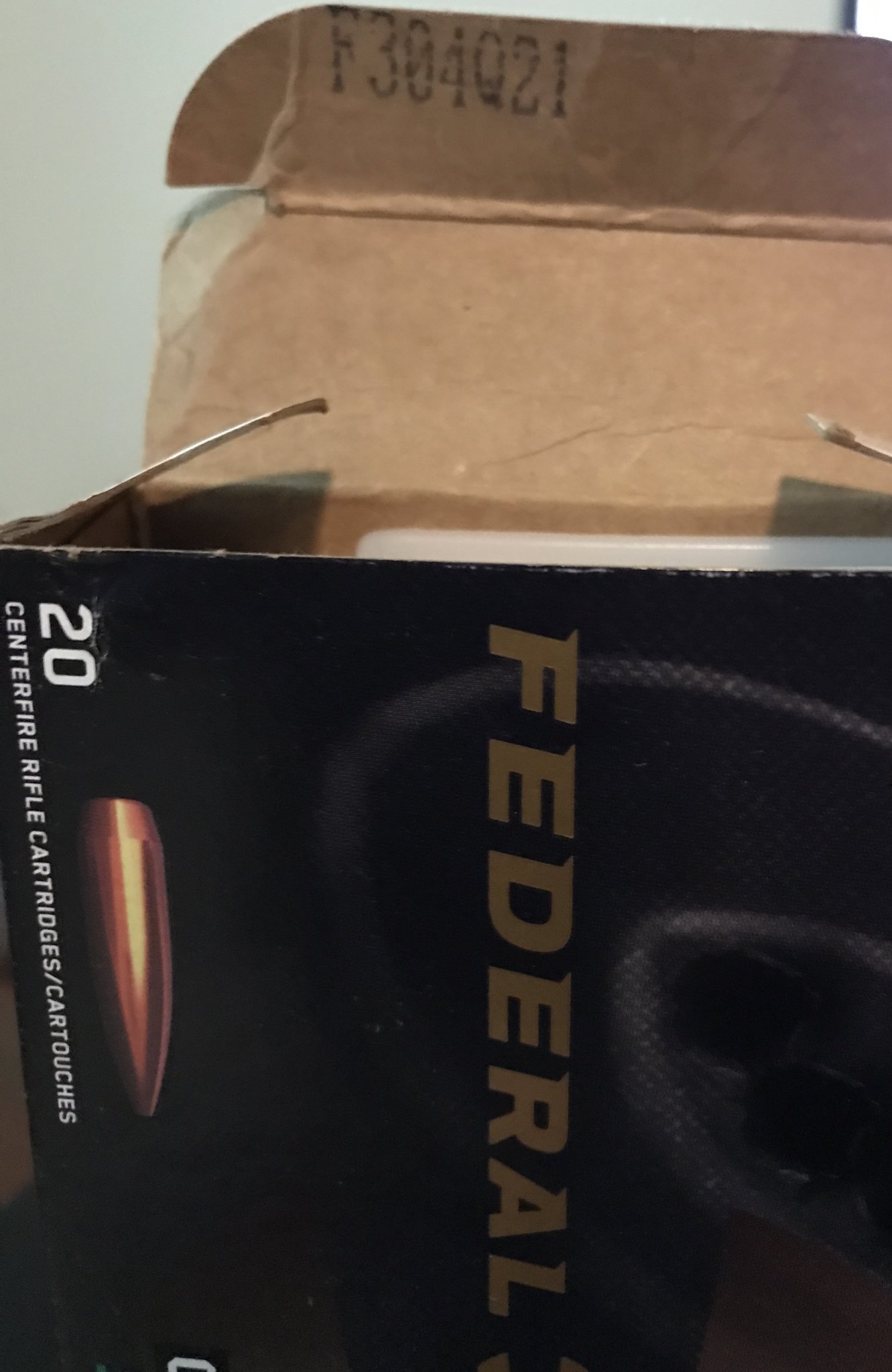

Box Flap
Internal Flap
(Left To Right) Hornady Superformance, Offending GMM Ammo, My Reloads
Length-To-Neck

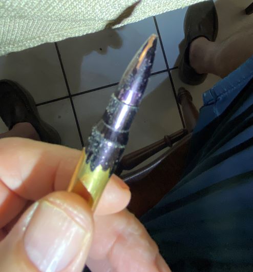

I just went to look over the cases from that session and there were no pressure signs that were obvious to my eyes (granted I would not consider myself an expert by any means). I do remember the bolt lift being noticeably stickier than usual but nothing that drew my suspicion, although I was a bit focused on the accuracy issues so I was a bit distracted.
And yes, you called it; the gouge was just leftover crud. Borescoping tends to do me more harm than good in cases like these.

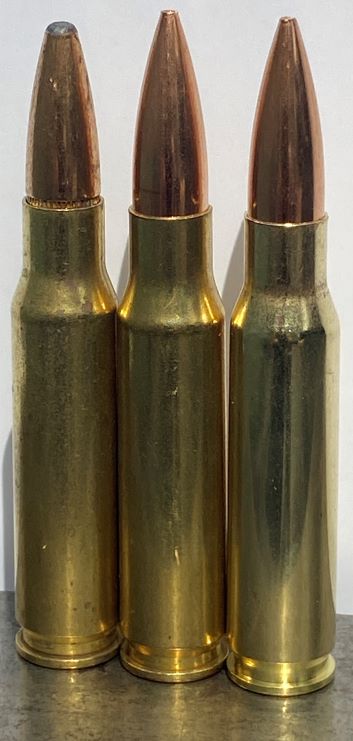

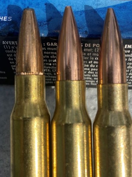

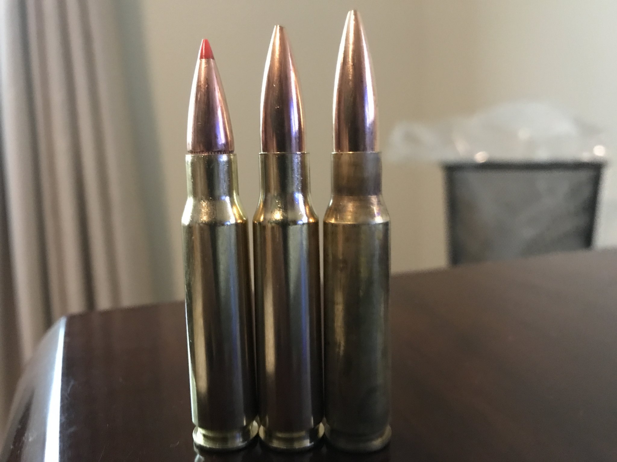

So taking clues from this thread I did a comparison of 3 different types of .308 ammo I have on hand (actually I have 4 but the 4th is Pindad Mil spec 7.62X51) and from left to right?....
Federal Power-Shok 150gr SP...FGMM 175gr SMK...Winchester Match 168gr MK
Now they are not level unto each other as they are hand laid against a box to take a pic highlighting the area where the shoulder transitions into the cartridge necks and as noted above the FGMM 175gr SMK is in the middle...I'll let you draw your own conclusions from there.
We wanna see them level so we can compare better. Making an observation as they are are in the pic and drawing a conclusion of it would be dumb. Stand them up and line them together.
Okay...I will do that but in my own defense?...there's an obvious condition going on there with the FGMM....a condition I wanted folks to recognize on their own without me inducing any preconceptions that that pic?....reveals just fine and there's nothing dumb about it but I'll set-up and take the pix as requested...here ya go...as set up standing on an old tooling bar...
Oh I didn't mean to say it was dumb or anything. I just thought me drawing a conclusion based on that first photo was going to leave me questioning whether my mind was playing tricks on me based on the angle or not haha.
But now that I go back and forth between all pics, I kinda see the same thing going on in all of them...
Reactions: JINKSTER

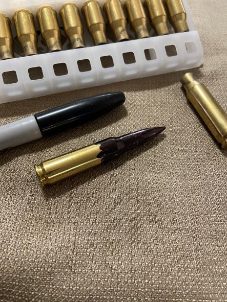

NP and so?...maybe I'm just not catching the camera angles good enough making it an "I guess you had to be there" scenario?...because the differences are pretty obvious as held in my hand so maybe "a hint" at what I'm seeing on my end along with a few pix of what I just did to shore things up for myself...so?....Here is a pic of an unfired FGMM 175gr SMK next to a spent casing of the same...notice the tightened up radius where the brass of the spent round transitions from the shoulder into the neck?....and how there's a lack of form/definition in the same area of the unfired cartridge?....
Now the question becomes was the spent brass "Chamber Formed" (at all) or solely "Fire Formed" or?...a bit of both so?....
Inked and chambered and?...
Ring around the rosey suggests a bit of chamber forming going on but to be honest?...this particular round wasn't all the resistant to chambering and?...maybe it's that tight fit and a slight bit of chamber forming that makes the FGMM so consistent hence accurate for the general factory ammo shooting masses?...also to be fair?....maybe the 175's just have to long of an OAL for the old original 19rd OEM metal box mags that came with my DPMS and that's why they hosed it up with it first ever FTF's?

I got to test out a few boxes from the questionable lot and discovered that it was really only one out of the random 5 I tested that had ammo with issues. The bad box did not have much trouble chambering for me but extracting required a bit more force than I would like. The bad box also shot significantly lower (about 2 inches at 200) than the others, which all shot almost exactly the same in terms of wind and ele.
From my messing around at least it seems like the Sept- 21 boxes with either 5 or 8 are mostly good but have some bad ammo mixed in. Still not sure how to identify them for sure other than the neck issue pointed out above and a noticeably different performance from standard behavior. Hope this helps.

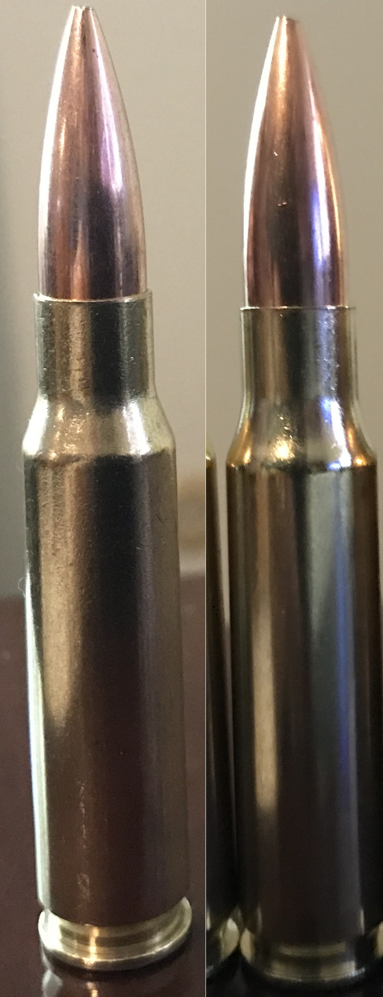

Update: Today on the way to the range I stopped by a different Walmart and found 168 Gr Federal Gold Medal Match. The lot numbers weren't the same as the bad cartridges that wouldn't feed (these were manufactured in March of 2022) so I bought a box and tested it today. Not only did they feed great but they shot great too.
See below for a comparison of the two. On the left is a good cartridge on the right is a cartridge that wouldn't feed. It seems very clear that the cartridges which fed and shot well have a sharper better defined neck. The cartridges that wouldn't feed have extremely rounded poorly defined necks in comparison.
Anyway, I hope this helps someone if they run into the same thing.
