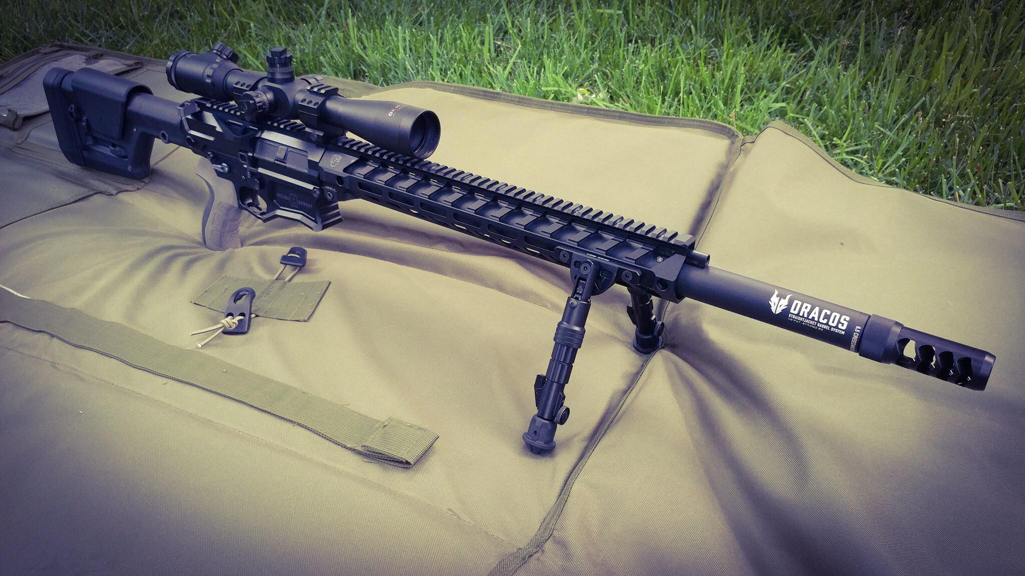

I have one. It's been a consistent sub-moa gun so far. Only a few hundred rounds through it. It took some doing to get things adjusted properly. My only complaints are the machining on the barrel extension sucks. Edges are sharp as shit. Very hard on brass. The other complaint is the the gas block doesn't adjust pressure so you'll need an adjustable gas key. I have the RCA key and it works fine. Also, they back pedaled on the lifetime warranty. To me that is shady as shit. I made copies of their website and all the shot show interviews they made about the you shoot it out we'll replace it guarantee. Personally there is no way in hell I'd pay full price for one. I got a blem model for 500.00. For 800 plus get a bartlein, Kreiger, or proof research. The Draco's is mean looking mother though.

Did you have an adjustable gas key installed? Also, the earlier barrels didn't have the gas block dwell adjusted and there wasn't much information about how to adjust it available. There was a learning curve but once it is set-up they shoot well. Mine shoots about anything at 1moa. The 143 ELD-X factory ammo has been the best. I haven't worked up reloads yet. Mine shot like hell until it was adjusted correctly.
