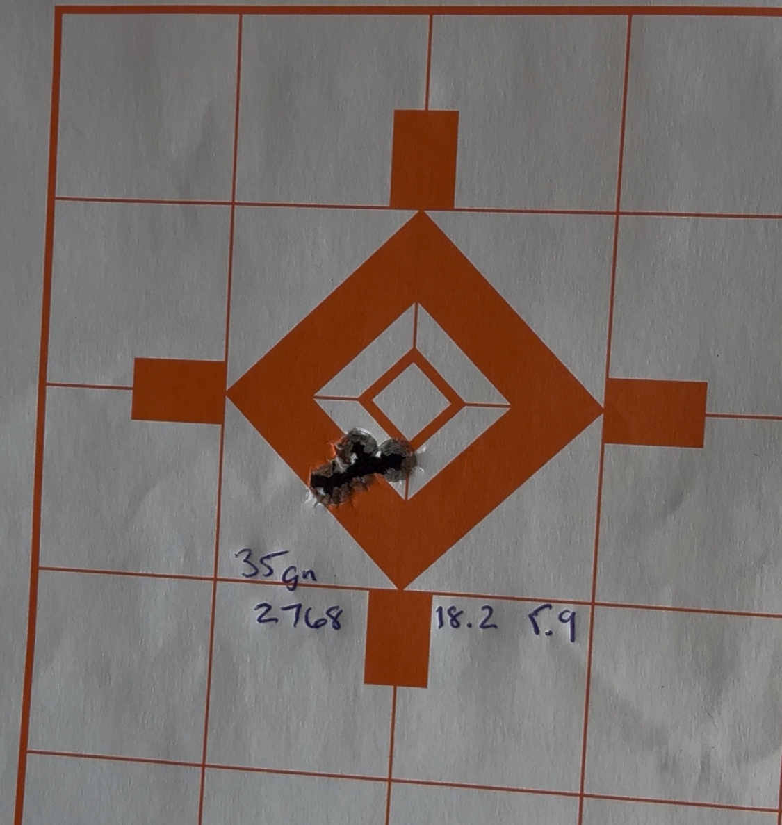

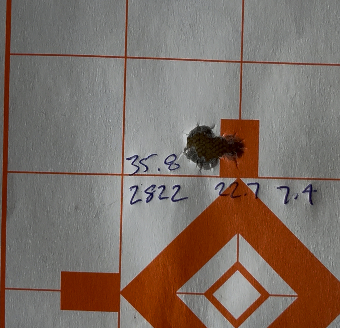

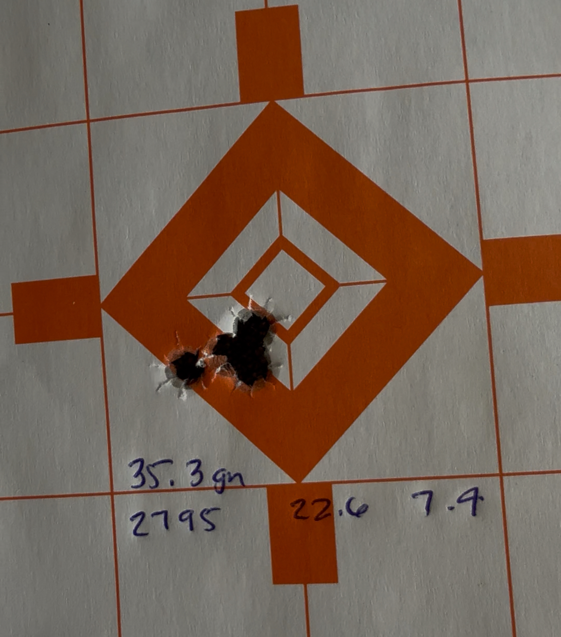

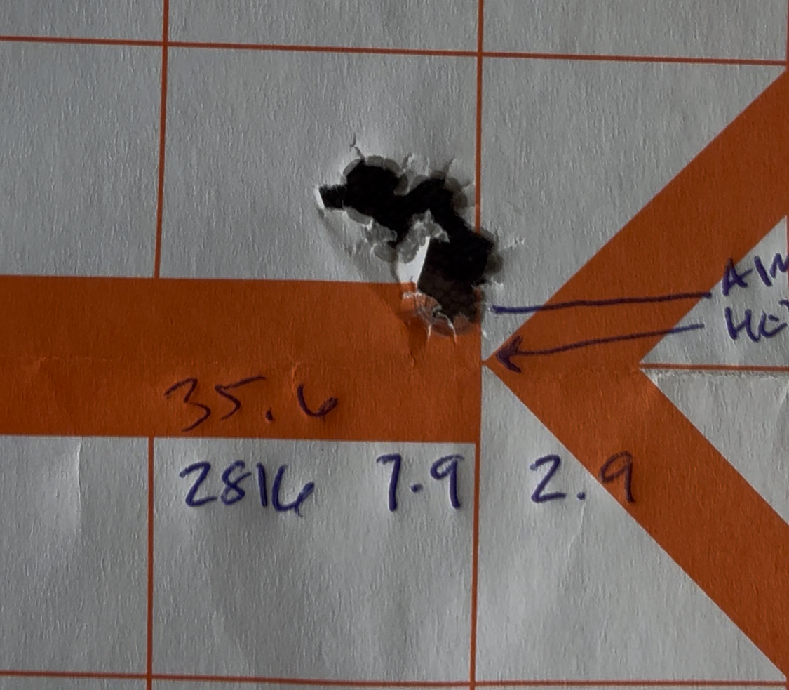

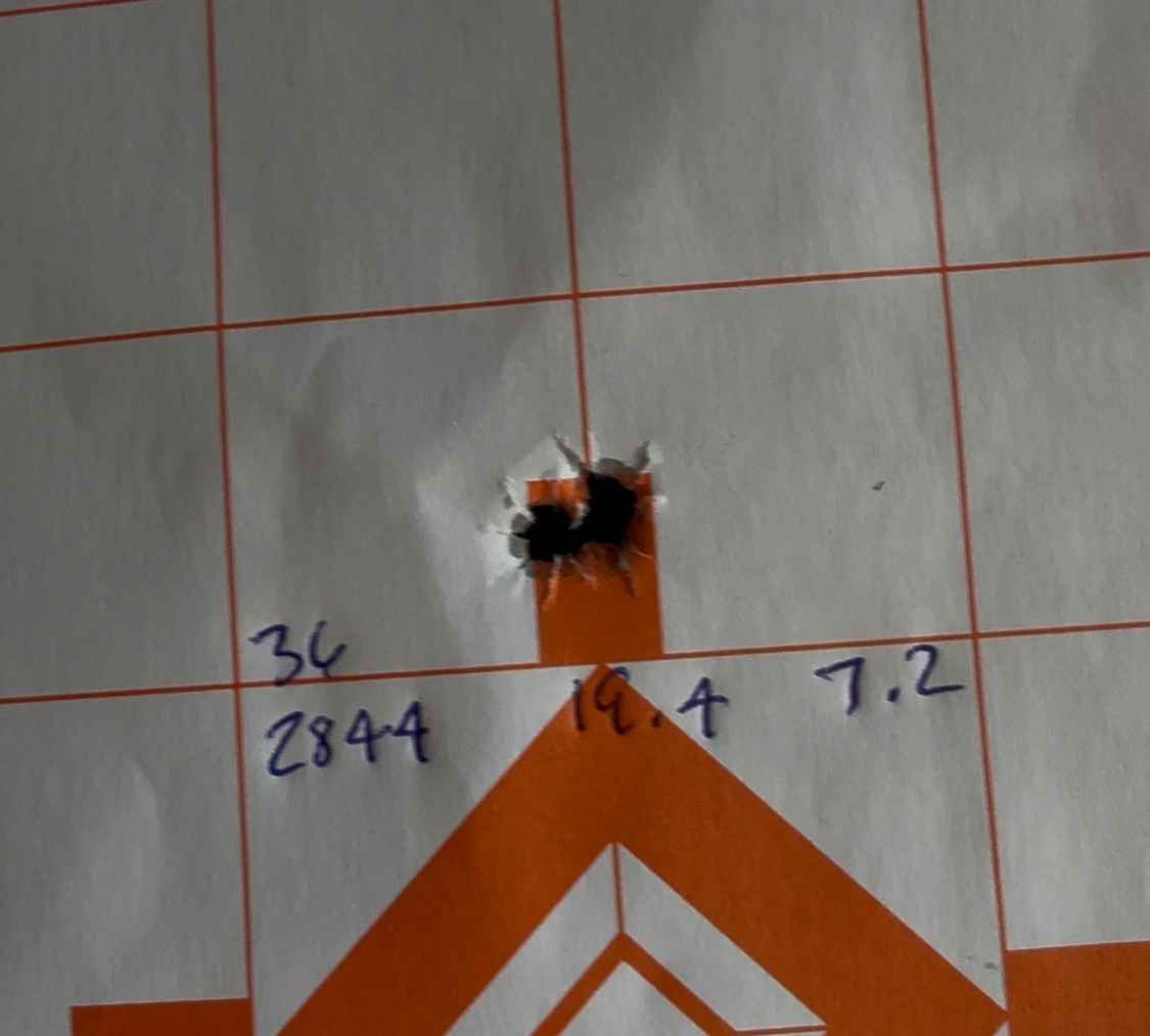

Anyone have info on CRB/Custom Rifle Barrels?
first few groups out of my 6gt CRB barrel. all 5 shot groups.
