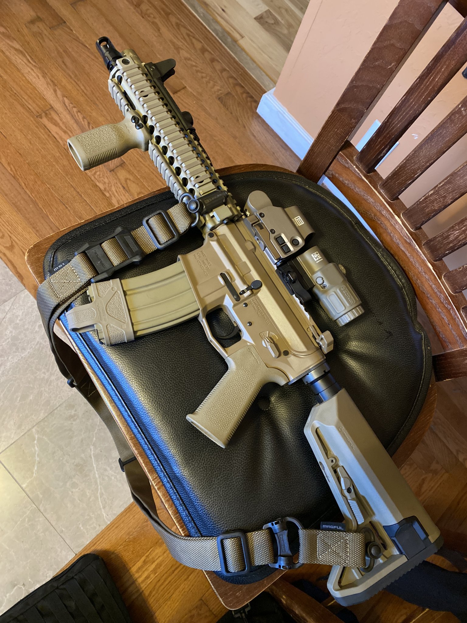

This one has probably close to 500,000 rounds through it with 3 suppressors and countless barrels..run it hard..it’s what it’s for.
To tell you how old it is? Still rocking a quad rail after all these years

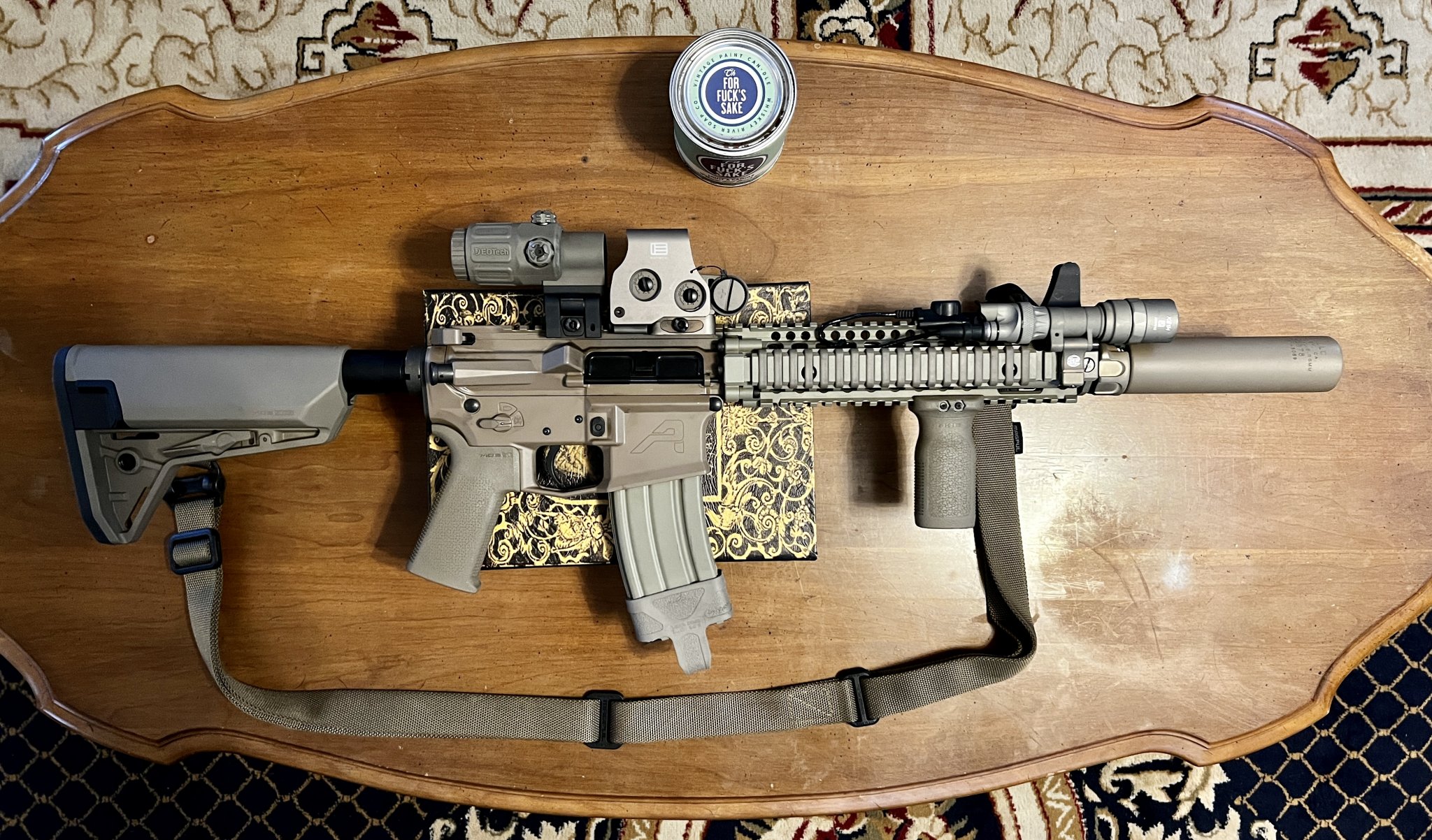

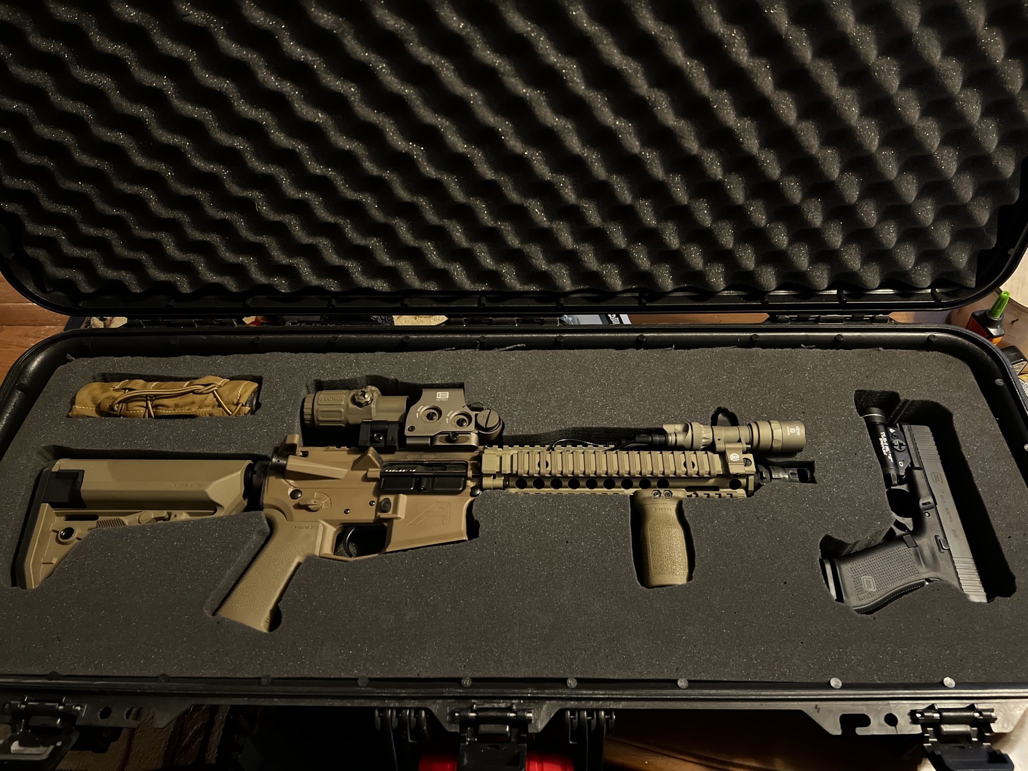

I love the Mk18. I have a Mk18 inspired build and run a Sandman S while I wait on the RC2 in jail. Currently only at a little over 100 days on that so it’ll be a while I guess. Love the rifle though.
I should add, I have the enlarged gas port and run an H2 buffer. Gas isn’t terrible unless I’m advancing on target while firing a string.

I’m working on a build that’s all FDE. Did you cerakote the rail?
That’s actually MolyResin from John Norrell. Stumbled onto that looking for an accurate “Colt Grey” from the Vietnam era M16. It’s good strong stuff, applied with an airbrush and cured in the oven. I have several colors and they are accurate.

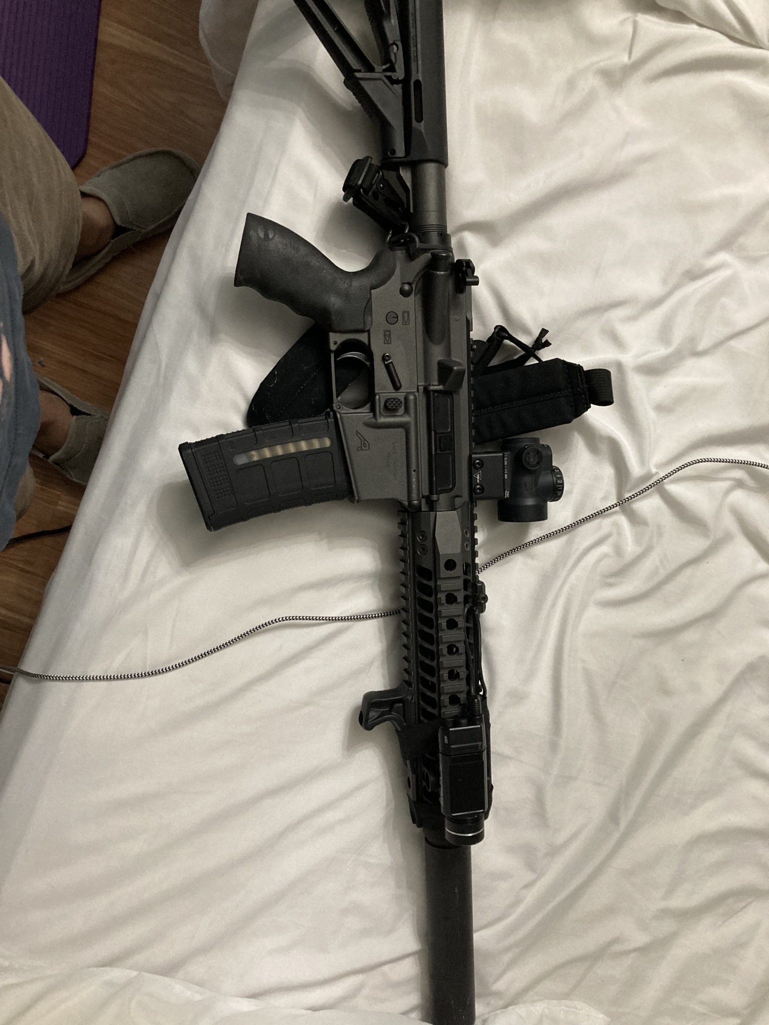

I shoot my MK18 suppressed almost 100% of the time. Run a Sandman S and a Trijicon MRO red dot. I believe I either have an H2 or an H3 buffer. Gun is pretty soft shooting, and I've run 1000+ rounds through it. Don't think I've ever had a FTF/FTE, including when I've shot in subzero temps.

Half a million rounds and nary a scratch and no anodizing wear on the brass deflector?
That’s a very good point. I never really looked at his pics! But after looking at the blurry pic again, that thing looks like a safe queen. It certainly doesn’t look like anything ive ever seen that’s been run remotely as hard as claimed. I suppose parts could have been replaced to make look new again or he is referencing this pic of the rifle before it had that many rounds on it though.
500,000 Call of Duty rounds
No anodizing wear and brass marks on the deflector are a dead giveaway. Must have been 500k Call of Duty rounds
