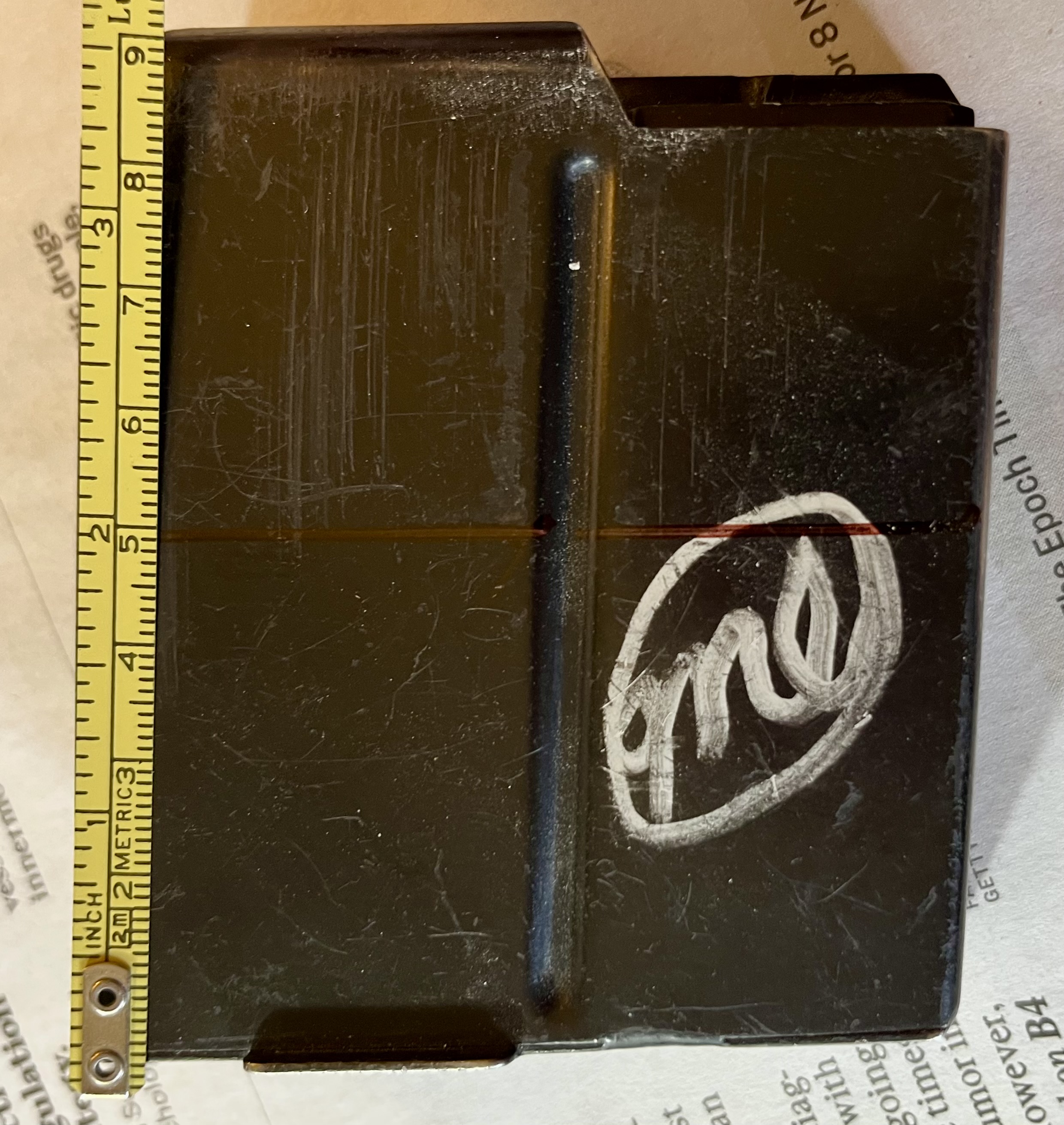

Are you looking for a flush fit mag? Because I don’t see you getting more than 3-4 rounds in a flush fit AW. And that’s with a custom spring and likely a custom metal follower (thinner).
Here’s my AW with a line I drew with the flush bottom metal on a rifle. Notice that line measures 5cm from the bottom and only 4cm to the top. You have to fit everything into that 40mm.
I'm cool with a lil below the belly line. A hawkins hunter mag holds 4. The AI aw holds 11 rds as it is, I figured removing half the height it'd still hold 5 rds. I wouldn't swap follower, just shorten the height of oem. The aw spring already is realstively low rates and compressed easily, I'd remove 1 bow, maybe 2 idk.
