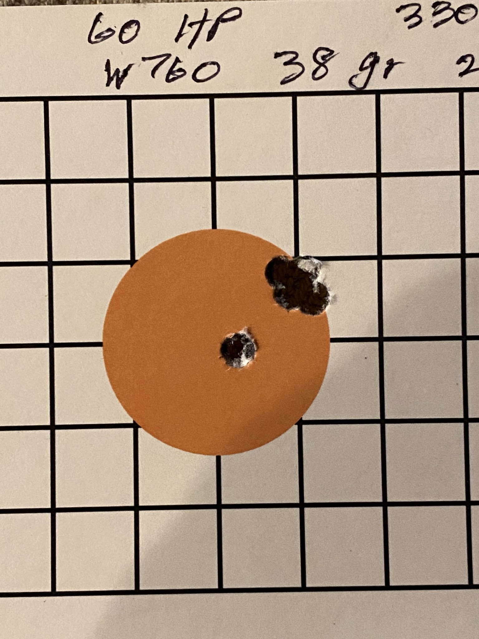

I had very good results with my 22-250 Weatherby Vanguard purchased 2019. I was using a Sierra 60 gr HP flat base and 38 gr WIN 760 for about 3300 fps. Groups at 75 yds out of a clean bbl were very good. Have not tried it at longer ranges yet. In the included pic, grids are half inch. Shows five shots with a tight knot of four.
