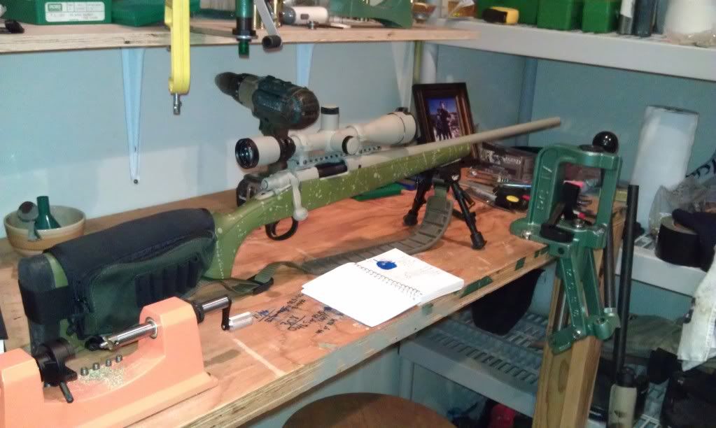

Go ahead and do it. I did my 700 action/bbl/mounts/scope in Krylon Camo Tan, and it holds up really well. Just do nice light coats, and the stuff is very resistant to scratching/chipping, whatever you throw at it. I'm not easy on this rifle by any means. It's a truck gun that gets tossed around and shot hard. Only a few scratches to show so far.

that looks awesome !!!
You've pretty much got exactly the effect i want. I want to do the scope, mounts, action and barrel one solid colour either khaki or tan and do the stock and moderator in 3 colour digital which will prob be Olive green as main colour, and khaki and tan for the digital break up patterns.
