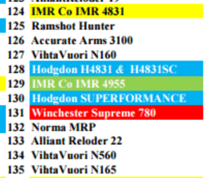

    I have been using RL22 for my .30-06 loads and I'm starting to get low on powder. I was looking for the same type of velocity that RL22 gives but with the temp stability of some of the wonder powders. I can't seem to find much info on RL23, has anyone used this powder?

    I can tell you this, it is not a replacement for 22, the burn rate is closer to RL 19, not saying it wont work, just don't think it is plug and play. If you want a powder to mimic what you have, look into Norma MRP, it's a simpler swap, but the same charge will result in higher velocities.
    Milo, is MRP temp stable like rl22 is supposed to be? Spife, I'm using the 210 SMK right now...
    Not considered a stable powder, but neither is 22, IME with it, not bad though. It seems to give a better energy for a lower mid-range powder. Once you get lower than RL 19 on a burn rate chart, and till you get to IMR 7828, you're in what I call a dead zone, where there really isn't the good powders as we know.
