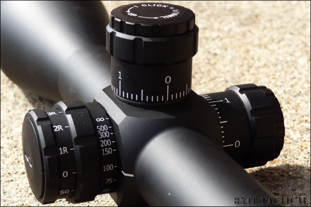

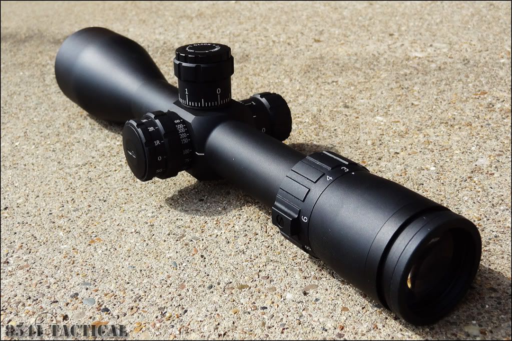

I have the 3-15x50 EMDR. tracking and ranging is spot on, glass is bright and clear. The hollow dots and half mil marks are very useful.
Now you mentioned tactical, so if you are an operator or shooting comps: There are no zero stops, and the scope is a little on the heavy side. 27.3oz compared to the Leupy mk4 ert @ 22oz
For us range rats, great quality for the money.
Price is spot on, both at SWFA or Optics planet with price match. Right around $700
One more thing: Eye relief is nice and generous.

The only problem I encountered is if you try to rezero turrets on the EMDR with them in the unlocked position, you can get the marks out of line. Also resulting in having to wigle it a little to get it to go down and lock. This is easily fixed by rezeroing the turrets in the down locked position.

I put mine through the paces from 500-1100 yds last weekend and it worked flawlessly. My dope gathered with my SWFA 5-20 was spot on with the Weaver after I got it zeroed. I was impressed with it just doing an intitial bay window review, but once I used it at distance, I came away mor impressed. I really like the open center reticle. I didn't have much trouble with moa sized targets with the scope set on 13x or so. I would say the scope is a steal at $700. I'll have to use it some more, but I may end up liking it as well as the SWFA 5-20.

The 3-15 EMDR mil/mil would pretty much be the perfect scope (for the price), if they would only do away with those stupid locking turrets.
As pretty much everyone that has one has mentioned before, you can't just pop the turret up and back down again. You have to wiggle it to get it to go down and lock. Also, on mine, the elevation marks don't line up. They aren't just a little off, as that wouldn't bother me, they line up exactly halfway between when they are unlocked. Combine that with the fact that you have to jiggle them to get them to lock, and many times with mine, since the marks don't line up, it will click .1 mil while I am jiggling it trying to lock it and end up .1 mil off.
Not sure why the went with that pop up locking turret design on the 3-15. I have the 3-10 also, and the turrets on those are great. Very crisp, line up perfectly, and honestly, are just all around better than the pop-up ones they chose to use on their high end 3-15.

Is is necessary to lock the turrets while shooting or is this just for storage/transport, etc.?
Re: Anyone using the new Weaver tactical scopes??
No you do not have to lock them, you can keep them up. Just if you had to transition to various distances and forget they were down, you can tweak the turret cap.
