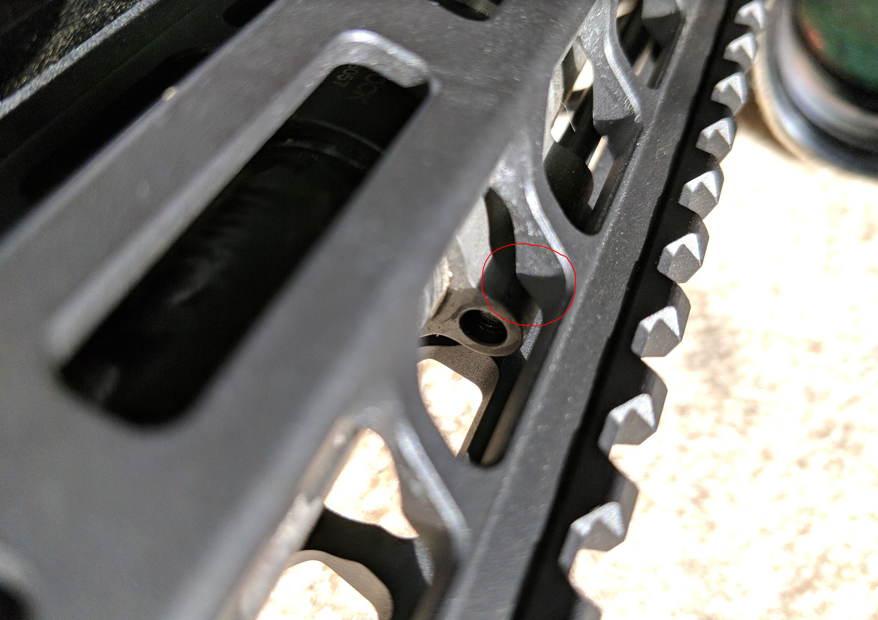

Were you using the clamp on or set screw blocks? What was hitting?

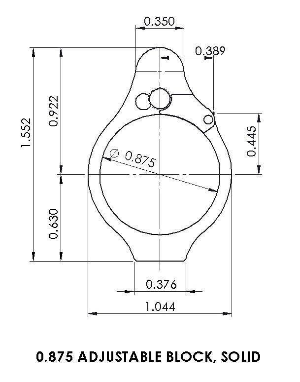

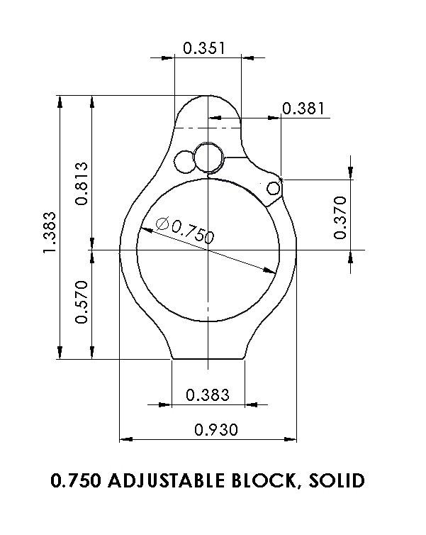

0_.875_Adjustable_Block_Solid-SA_1024x1024.jpeg0_.750_Adjustable_Block_Solid-SA_b8798835-661c-4f78-981e-22a210a2e381_1024x1024.jpeg

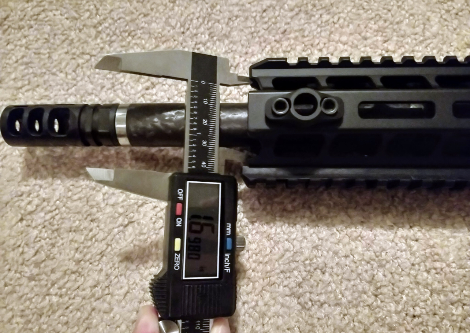

I was using a set screw and didn't have any issues with it hitting the bottom. Where my gas block made contact with the rail is circle in the photo below. I also added another measurement of the top gas tube channel.
