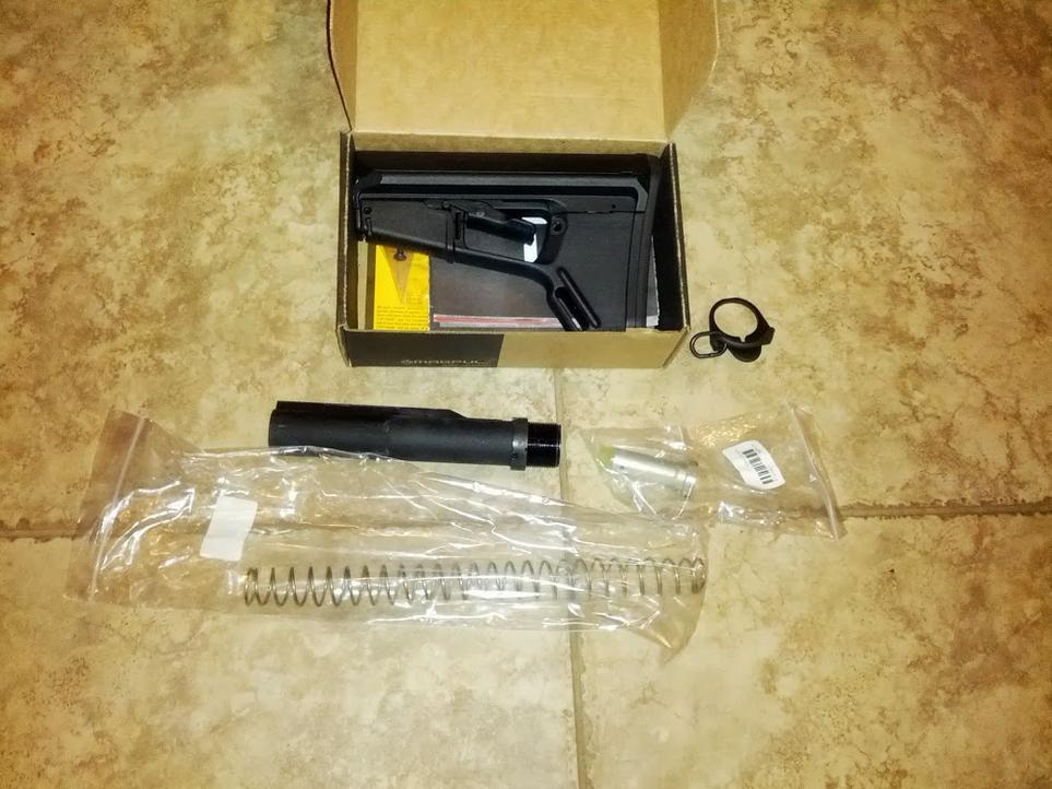

Hi all (I'm new around here...)
Just put on a PRS stock on my 308 and I have an "almost new" Magpul ACS-L left over, including the matching mil-spec carbine extension tube (AR15 length), "short" 308 buffer and buffer spring. I can also toss in a Magpul ASAP sling mount since I no longer have use for that.
Interested? PM me with a fair offer (parts are almost new and came off my week-old CMMG MK3). :)
... and yes, it does collapse fully.
