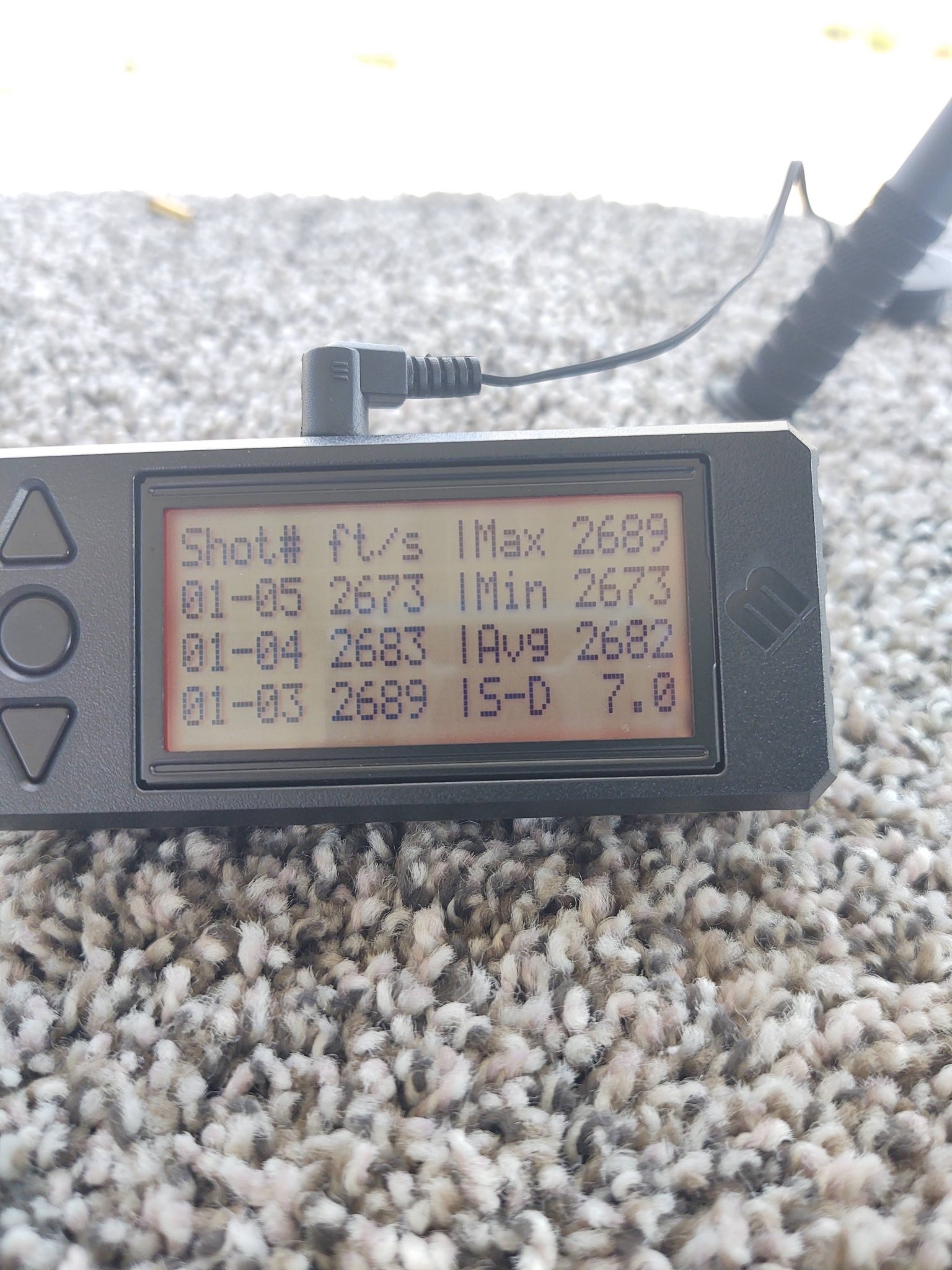

My 24" Proof Research Carbon Fiber barrel was also slower than my Bartlein 22" barrels around 2680fps with Hornady 147 ELD.

My 24" Proof Research Carbon Fiber barrel was also slower than my my Bartlein 22" barrels around 2680fps with Hornady 140 ELD.

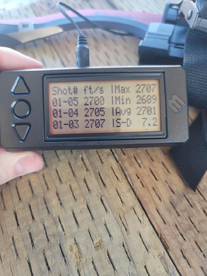

The seekins with the 22" Bartlein is staying right at 2700FPS with 40.4grs of H4350/140 ELDs/Lapua Brass/BR4 Primers. I've also just finished my JP LRI-20 with the 24" Bartlein so I'll soon have data to compare to the 22" as well.

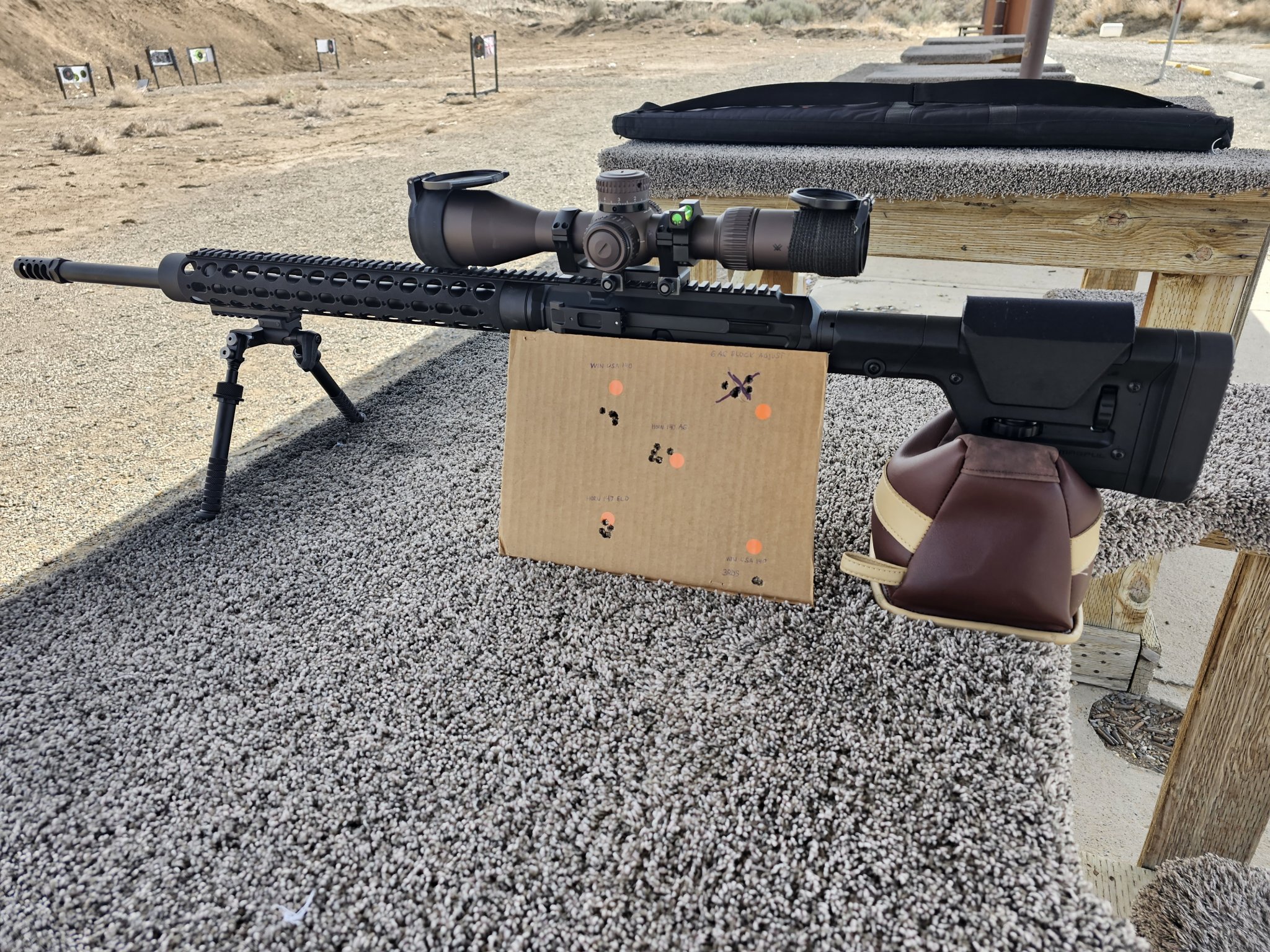

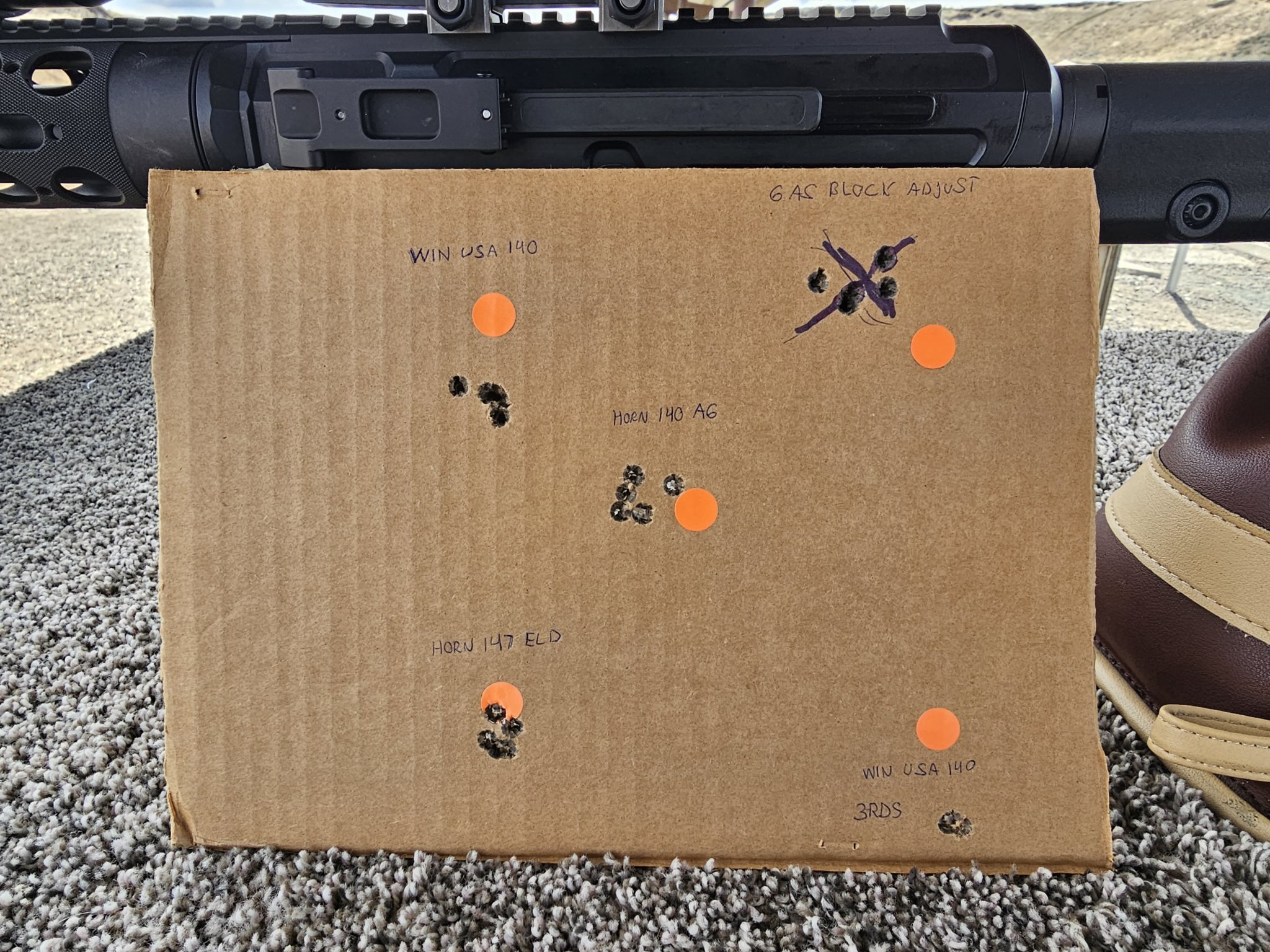

Here is the JP LRI-20 with the 24" Bartlein and the first 28rds down the barrel during Break-in cleaning after every 5rd group. I had 3rds left of Winchester USA 140 for the final group that printed .115 MOA
