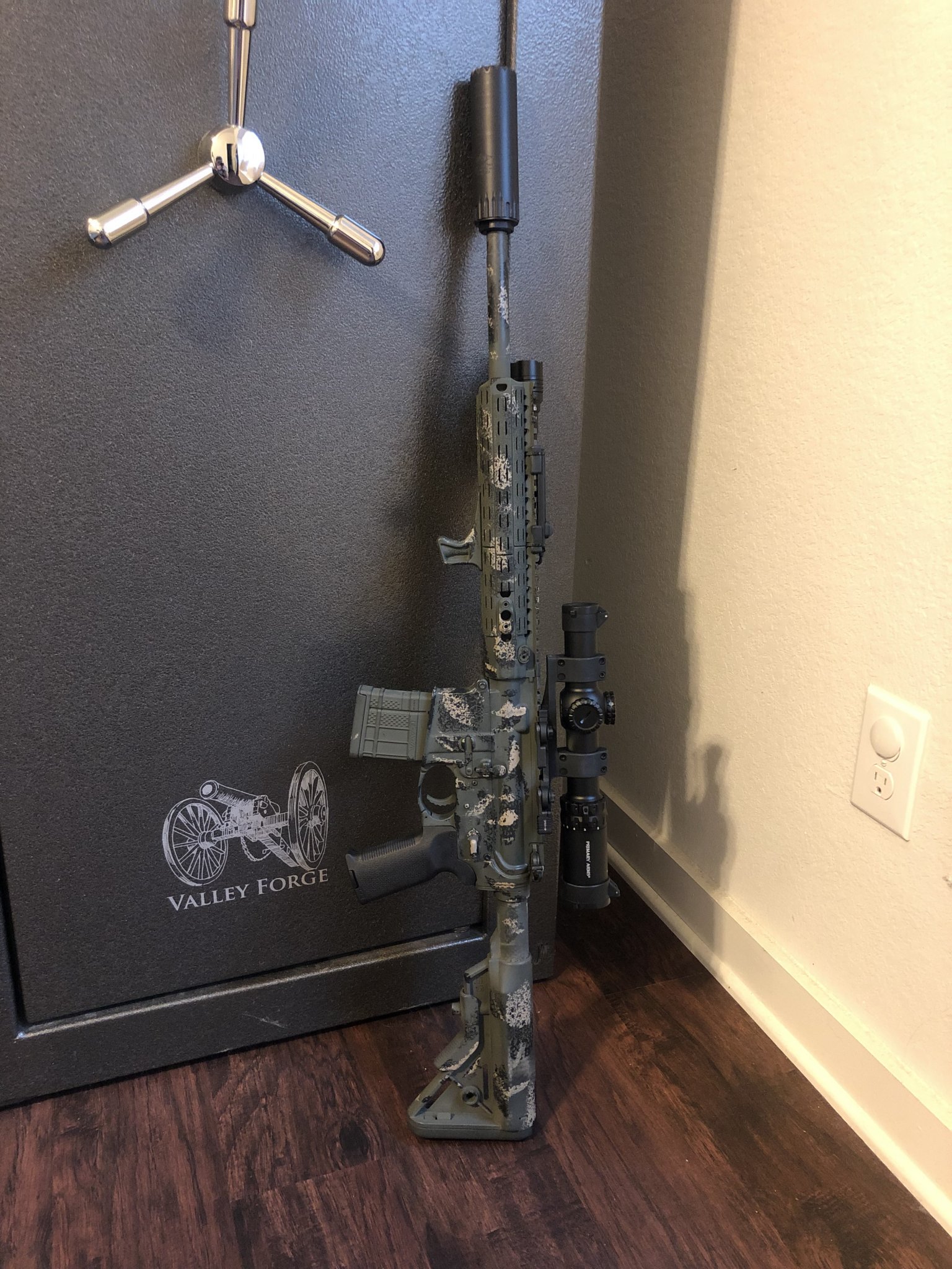

I built a 50 Beowulf pistol and after a year decided to just SBR it. It's fun to shoot, still is good out to 100 yards. Able to down wild boar, deer and coyote. It's a conversation piece at the range too. BIG boom and everyone looks.
Paint job has changed throughout the years but this is how she currently sits.
