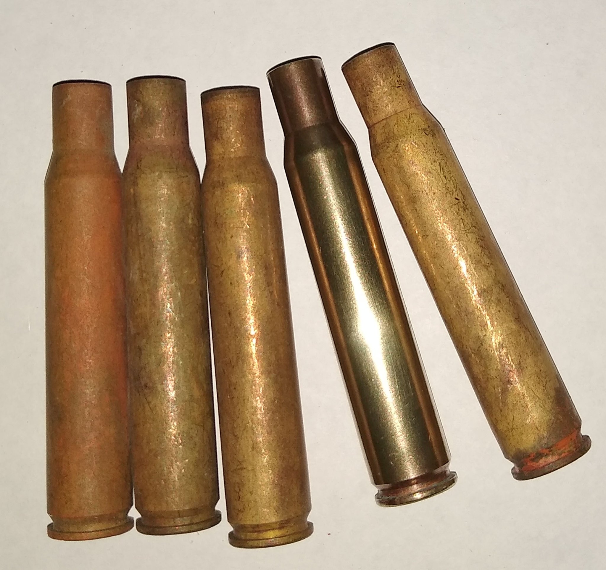

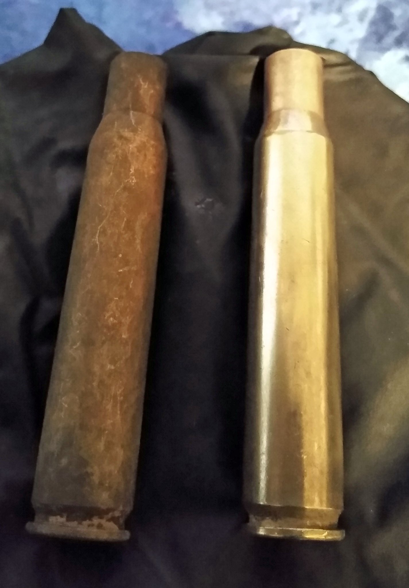

Although they were left to the weather for 65-70 years before I obtained them . Fortunately they have proven reusable and robust cases . Most were LC but some SL from WW ll 1942-43 and 52-56 Korean war vintage . I did have at one time nearly unlimited access to 1962-68 Match ammo and also saved some of those LC cases . That was until USMC Camp Pendelton decided to burn Tons of stored ammo and NOT sell surplus under Clinton !. I watched semi after semi dispose of pallets of Match ammo among all sorts of ordnance and burned . So much it took #3 D8's a week to make the ditch .
MY Garands have not been kind to commercial cases ,as in extraction after #5-7 firings lips rims are torn off .
Tomorrow I run another reloading ( the 40 Th. ) on those LC cases and I DO restore ductility to the neck and shoulder after every 4 Th. firing . So far SO GOOD , haven't lost a single case and primer pockets remain in tact . MY goal is #50 reloads all within 1 grain of Max. charge ,so as to prove OLD Military brass is Stout and worth retaining . It's becoming scarcer to obtain as time marches forward .

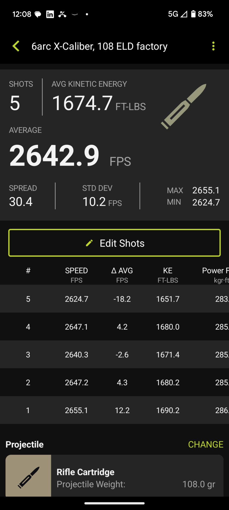

Yeah, that's a fairly slow ARC load, here is the chrono data for Factory 108gr ELD and my 103gr ELDx load (under book max) in my 18" gas gun.
View attachment 8445529View attachment 8445530
It's a slow 6.5G load too. There isn't anything magical about 6ARC. Pressure equals velocity, if you don't care about the 52kPSI ceiling you load them both to the moon.
Kind of, area under the pressure curve is correlated to velocity more so than just peak MAP. Given that the powder selections on the market are finite it means some cartridges might have a more optimal powder available in terms of burn rate, energy density and volumetric density. LVR and CFE223 are pretty perfect for getting max performance out of the ARC and they're probably pretty good, if not as ideal for the Grendel as well.
In case it wasn't clear, the chrono'd loads above are the Factory 108gr and an under book-max hand load, so no ARC magic there, and no bolt gun only loads. I do suspect though that it would take a magical or +P+ Grendel load to beat those velocities by 200 fps as suggested, but I'm all for seeing some chrono data that suggests otherwise.
