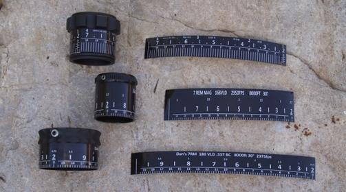

Why not make your zero at 100 yds. and make a drop chart out 400 yds. so you can chart the arc of your bullet as it goes down range. Then have these made for your elevation turret. Then all you have to do is use your laser rangefinder to find the distance to your target. Then turn your elevation turret to the yardage, hold for wind and shoot. I am a big proponent of custom turrets.
I think these cost about $25.00 and stick to your turret that came with your scope.
Custom Turret Systems | Affordable Custom Turret Labels

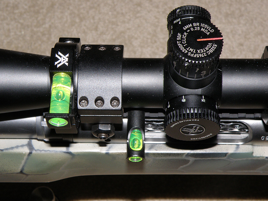

Here is a custom turret that Vortex made for my that is on my PST 6-24x50mm PST FFP MOA scope. It is dead nuts accurate at every range. This is a 400 yd. target that I turned the turret to 4 for 400 yds and shot without holding for a slight wind.
I think these cost about $20.00 and stick to your turret that came with your scope.

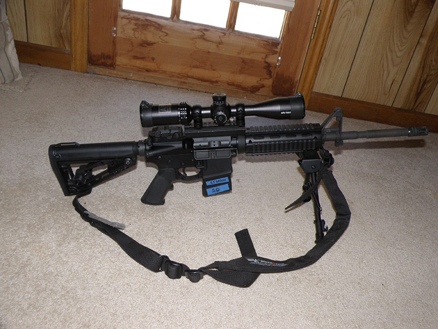

bigbear_98 I realize what you are telling us. I would think that you would want a scope on a precision rifle. I just suggested this incase anyone will be using a scope. I have settled on a Bushnell AR/223 4.5-18x40mm scope. It is really great for when you want to target shoot or want to shoot at prairie dogs at long range. You can easily zero your turrets after sighting it in.
Best price I have found ($174.99 free shipping). Most sell it for $249.
http://www.sportsmansoutdoorsuperstore.com/products2.cfm/ID/124382/c/bushnell-ar-optics
