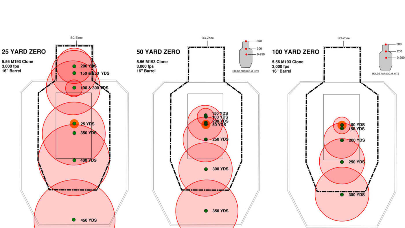

Battle sight zero is a zero distance that is chosen (mostly done on iron sights and optics without a BDC) where bullet trajectory will have acceptable elevation differences in POI (for the ranges) that accounts for max ord and height over bore offset. Sometimes people choose the flattest trajectory based off likely engagement distances (50yd zero), others want the most coverage (25yd if aimed center will cover from 0 to 425yds roughly).
The idea is to eliminate the need for trying to figure out range of target and deciding to hold over or hold under (in combat) and reduce the process to simply hold center mass.
My follow up post regarding the angles with possible calculated drop tables basically eliminate any sort of reasonable possibility that this would be elevation differences.
For your 100yd zero, you'd basically have to pretty much being shooting straight up or down or there'd have to be extreme elevation differences between you and the target (around 100yds of elevation difference) for your 100yd zero to even potentially result in a 5" high at 200yd impact.
